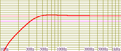

Like I said, I gotta go. Here is a WinISD simulation of what your response curve should look like if you put these into a 60 Liter box and tune to a 19.5 Hz frrquency. The port to do this will be 76mm diameter by 503 mm long.
Will be back later if you want to talk about this. Anyone with experience with this woofer or isobarics is certainly welcome to jump in. :)
