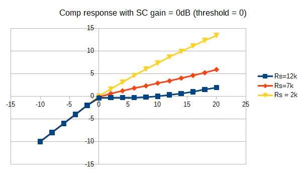

I am working on the design of an audio compressor, and I want to automate level in/level out measurements. I have an AP that I use for most bench work, but unfortunately it doesn't sweep level vs. level.
I could do this quite well enough using a PC and a soundcard (I don't care much about distortion/noise), but how to do it? I seem to remember a long time back I came across open source audio test software that people were using, but I don't find it back now. Don't remember the name.
Does anyone have an idea for software tools that will do this out of the box,or with some hacking?
To clarify, what I want to do is a mono test, all at one frequency. Simply increase the generator in (say) 1dB steps, pause to allow settling time, and then measure the level of the circuit output, in dB. Absolute values not important, I can calibrate these externally.
Then get the results either as an on-screen graph, or in text format that can be processed and pulled into a spreadsheet.
thanks!
Daniel

I suspect that you could generate a file with the test tones you desire in Audacity, and then use Audacity to measure a file you recorded by looping through the UUT. Audacity is freeware, multi-platform, and I think it even has a scripting language.

Try spectrum lab.
It would allow you to set up a signal source (or more) on the sound card output, which includes waveform type, level control etc. on the measurement side it will be overkill, but the spectrum analysis display will allow you to monitor the output level.
If you want to get fancy, you could use one channel each of left and right to monitor int input / output transfer function.
The package is freeware, and once you get your head around the configuration of input and output works well.
Thank you - that looks possible, al though I can't see any mention that it is scriptable. I'll lookfurther though.
This is an example of the kind of test I want to automate (this was done by hand, entering readings from the AP P1 plus into a spreadsheet).

The relevant tool in Audacity is the Spectral Analayzer.
I have to admit that I have traditionally done this sort of thing using Sound Technology Spec Lab, Audition and Cool Edit Pro which all do this quite well. Sound Technology's Spectrum Lab is the most expensive but IMO also the best:
Spectra Series Signal Analysis & Data Acquisition Software Solutions...
There is another free product called Spectrum Lab that is freeware and oriented towards hams. I really have no experience with it.
Another piece of freeware to look at is VA or Visual Analyzer.
There is a lot of freeware, shareware and commercial product in this area.
