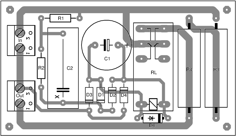

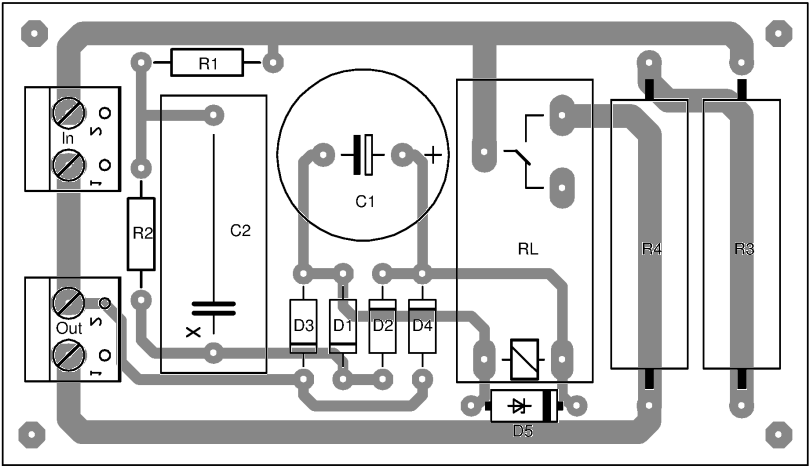

Hello everyone!
I realized what softstart that works perfectly but I think the relatively short time (~ 1s), the tests were done without any transformer connected.
I do not know if we can extend it a little time and which components must be changed.
Thank you!

I just simulated it in LTSPICE and it appears to be a 230V circuit. Is this correct?
Increasing C1 does increase turn on time as far as I can see.
If it where me I would adapt it to go after the transformer. Unless the transformer was really big. Then I would buy a real time relay.
