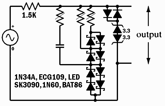

About what I'm looking for, is a clipper able to clip a signal in a identical way that following amp can do. Of course, because it is supposed to be a protection, even in high end amps, it is requisite that this clipping circuit will not deteriorate the quality of the signal in any way.
Such a perfect circuit will just remove little percent of the peak power capability of the amp.
Clip the amp before it may do worse. Sounds just like the amp clipping normally (maybe sounds just like a tube amp clipping normally). Removes only a little bit of peak power without affecting the normal signal range of operation. Oh, we're back on topic--I think you've just named a soft clipper.

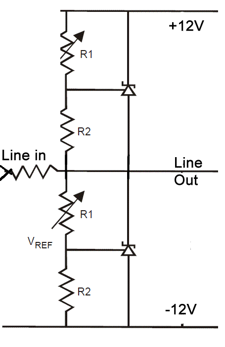

For the moment, I'm on this simple idea: + 2 adjustable zener Diodes. The interest is that it has no action before the threshold, because just a resistance in the signal path.
Adjustable like this? ZR431 Zener shunt reg
Slight problem: The voltage tolerance is so tight that there's very little curve and a lot of flat. I like the adjustable idea, but we need "more roundness, less flat" You might want to build a clipping indicator to see that real music signal is so very dynamic, that your device will be giving peaks an audible flat top more often than expected.
Can you do this multi-step approach?
A mild (tiny current) soft clipper takes effect first, followed by. . .
A medium current soft clipper takes effect next, followed by. . .
A strong soft clipper, takes effect last, followed by. . .
A hard clipper with a non-audio voltage setting for surge overload protect.
*Only the 3 soft clippers are doing an audio processing task.
Mild current soft clipper is set for lower voltage (the amp has almost begun to clip),
medium current soft clipper is set in the middle (the amp has begun to clip),
strong current soft clipper is set for highest voltage (the amp is clipping).
the roundness is increased--the duration of flat top is decreased

And the simple options. . .
For the normal amplifier (those without inbuilt clippers), the soft clipper if set aggressively, looks just like a hard clipper except for ineffectively rounded edges (sounds like Spike) or the soft clipper if set mildly looks like a rather ineffective headroom boost (imitation tube/valve clipping in addition to regular clipping). Instead of choosing between bad or bad, what I'd rather do is have load at the input dynamically adapt to the current requirement of the given signal.--Instead of a flat top haircut, I'd like greater resemblance to normal music signal.
Done without op-amps.
Done without optocouplers.
Done without complex sensor.
Done without cutting output power severely.
At the very least, I wish to have the simple soft clipper altered to reduce the duration of the flattened portion of the signal (via curving the edges more). Without actually building compressor circuits with op-amps and/or optos, the best I can think of at the moment is multi-stage soft clipper also employing at least one current reliant diode.
And simplified works, but there's a problem.
Even with the fast circuit at the bottom of post 1, I can't quite seem to avoid a bit of treble hash and unlevel frequency response. The bass gets cut first. The switching pollutes the treble. This needs a filter, but I haven't managed it yet. It seems to need a voltage activated addition that would engage a "tone control" as needed and concurrently with soft clipper activation. Maybe each stage that switches on can also engage a really mild RC enough to affect a partial compensation?
I'm in search of something simple, but that wasn't simple. :)

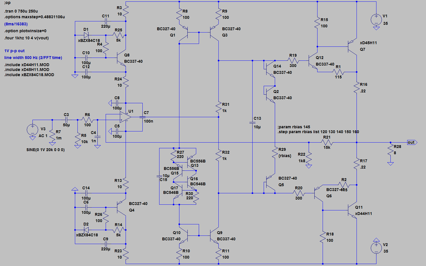

Cordell's "Klever Klipper" works like a charm. Properly adjusted (tracking rails etc), it kicks in just below output stage clipping to exactly avoid that clipping which tends to be "sticky" (amp takes quite some time to recover from clipping) and sounds much more annoying than a briefly compressed, then "chopped off" peak but still properly amplified.
Key point is that the amp never ever opens its feedback loop -- with the exception of current overload "clipping" which is a different animal, much harder to tame.
One can adjust the "softness" of the clipper by letting it work at lower (large transition) or higher signal amplitudes.
Soundwise, any soft-clipper will steal some volts of undistorted headroom but I found Cordell's pretty well sounding for clipped LF (<500Hz) signals, sort of like the speaker itself is running out of steam, not the amplifier, unless you punish it with gross input overload. With occasional short HF (>2kHz) overload spikes the clipping was effectivly undetectable to my ears.
Soundwise, any soft-clipper will steal some volts of undistorted headroom but I found Cordell's pretty well sounding for clipped LF (<500Hz) signals, sort of like the speaker itself is running out of steam, not the amplifier, unless you punish it with gross input overload. With occasional short HF (>2kHz) overload spikes the clipping was effectively undetectable to my ears.

The BAT85, BAT86 has low capacitance for low noise. On researching headphone amp clippers, the 1N34A and LED have mainly 2nd order harmonic like a tube clip.
For experiment, I used:
1k5 series loss at input to help form the voltage divider.
10k-BAT86clipper-680n as the main shunt.
10k-BAT86clipper-BAT86clipper added shunt.
This successfully constrained the TV to reasonable output.
I'm looking forward to trying out some 1N34A germanium.

I am entering this thread hoping I find a good solution to avoid power burnout due to "sudden" input overload.
I have built a very clever power amp that is DC coupled but seems very sensitive to input transient bursts.... I burned one channel just by unplugging input rca during operation.
Need some input clamp that does not affect signal in any way.
here you have the schematic ... fell free to launch any ideas that will be soon built in. Results will be reported.
Clipping input:
At location "C4" put a series pair of FR diodes "facing up" and another series pair of FR "facing down" so there's 4 diodes total. A series pair of FR = 1v (and you'll need two series pairs--one pair is backwards polarity). OR, series pair of 1n400x is 1.3v.
Measure and adjust the value of C4 smaller so that the total of parasitic (diode body) and normal (c4) capacitance of that location is the same 1n as previously (or similar).
You will then get normal operation when the input is 1v or less, or some distortion if the input is more than 1v. Add an additional FR for upswing and an additional FR for downswing, if you want 1.5v (which will also have lower capacitance--diodes in series is like little capacitors in series, less capacitance that way).
If the FR diode body capacitance is still too high, you can switch to bat86 diodes instead (0.3v each), but signal schottky types are more frail and thus the series resistance, R6, may need to be greater to help protect them.
You can probably use up to 330R at R6 without affecting the audio. In that case, 2 pair 1n4148 clippers (0.7v+0.7v=1.4v clipper parallel with C4) is an easy option.
Usage, for example, computer music source, when the computer switches on or awakes from standby, the ranchy blast from its output, sometimes 12v, will be cut off to 1v by your input hard clipper.
*alternative to the input hard clipper protection is an active circuit, such as Cordell's Klever Clipper and many many other options. But none are as simple as antiparallel diodes with the voltage threshold set higher than desirable signal. These don't work very well alone, but can work rather well as the shunt leg of a voltage divider (your R6 is the other piece).
Clipping amplification:
But if you had needed to clip the amplification, then you'd need a much different circuit, such as an ltp soft clipper.
For this, change R22 to a 2k multi-turn trimmer in parallel with an 18k resistor, resulting in the original value of 1.8k. Next attach series two antiparallel pairs of BAT86 (0.3v + 0.3v = 0.6v clipper with very low capacitance) to the wiper of the 2k trimmer, and next, a 1k multi-turn trimmer (as a variable resistor) goes between the BAT86 clipper and the positive input. The 2k trimmer is clip voltage, the 1k trimmer is clip current. This describes an LTP soft clipper. Startup positions of the trimmers is half (wiper at centerpoint).
Usage, for example, a surge high enough to cause the outputs to stick (or severe hfe droop, or other non-linear range), has INSTEAD, clipped the inputs, which can recover instantly and rather easily (there's a big difference in the current of the clip--tiny at inputs or huge at outputs).
*I have not used the ltp soft clipper on a dc/mixed coupled amplifier; however, if there's trouble, it is possible to put a capacitor series to the 1k trimmer so that the clipper won't switch on for DC. If you undersize the cap, it will ignore some of the lowest bass pitches and appear to function as a rudimentary form of compressor instead of the intended function.
**The LTP soft clipper circuit will relocate your imaging linearity sweet spot to take effect during somewhat louder volume playback than previously, just as the LTP soft clipper has begun to catch a few peaks infrequently, is just about when the imaging will kick up to bigger and the tone will foobar slightly in identical proportion to the imaging boost. To swamp a bit more of that, you may want to double up your power decouplers, C5, C8, 100u||100u (200u, an orthodox value anyway).
***Alternative to the ltp soft clipper circuit is: baker clamps can be used instead.
I did use both the input clipper and the LTP clipper on my circlophone. Those two clippers do different tasks.
P.S.
Also suggest changing C3 to approximately 2uF, although 1uF may do fine or better; however, the currently 50uF input coupler could have too much discharge force, like a tiny tazer.
P.P.S.
I suppose there's some 100u in your parts box. Quadruple parallel 100u (400u low loss) would not sound bad if put in series between R22 and ground (400u as a coupler). It would be a worthy experiment to see if ac coupling will yield a more sturdy amplifier with louder and more lifelike dynamics (as expected).
