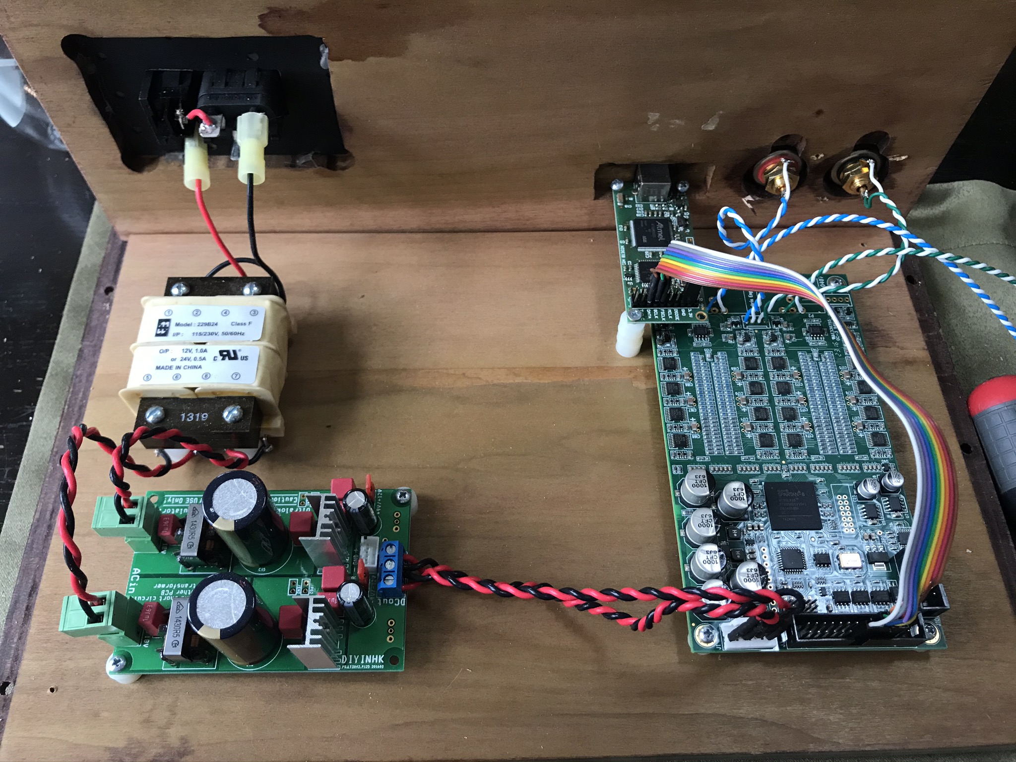

I have two quick questions about my dam1021-based DAC that I built 4 years ago. I have been happily enjoying it, and only recently opened it again to install a headphone out to the buffered outputs so that I don't have to power up my whole rig for just quick listening.
Apologies for being a bit elementary, I'm not much of an electrical engineer; I am just learning and trying my best. While it already sounds great, it isn't on par with my vinyl rig in terms of soundstage and naturalness, realism.
The implementation: (See attachment for a picture)
Board version: dam1021-12 - revision 4
USB: Amanero USB, original firmware
PS: 12V Hammond transformer driving the DIYINHK LT3042 board [12V output]
Raw outputs to RCA for my preamp, buffered outputs to a headphone jack (driving HD600)
Case: beautiful wooden case that my dad built and gifted me, with a grill on top for heat dissipation
When I opened it up this weekend, I noticed that the ground connection isn't connected to anything. Usually it would be connected to the case, but this case is wooden, so shouldn't it be connected to the power supply board? I don't see anywhere that it would be connected on that board. My understanding was that regulators dump power supply noise to ground. Is this a safety hazard? I leave it on, and the grill never feels warm.
Any ideas on further upgrades that can be made? I haven't modded the vref with capacitors yet, as the rev4 board has some improvements in that area already. Is it worth adding further capacitance? Isolate the power supply for the Amanero? Better is always better
