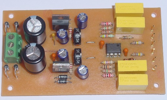

Here's my effort on the SOAP MKIII, based on the files kindly given by Zei. Thanks a lot.... I will test it this weekend, if time permits.

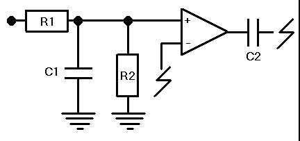

However, I noticed (after construction) that the design does not have a low pass filter at the input, instead it has a high pass filter (formed by C1 and R1, R2 and R3. What would happen if the position of C1 and R1 is reversed (and values adjusted accordingly) so that a low pass filter is formed? Feedback from the original designer and/or Zei will be much appreciated.
I want to use the SOAP as a pre-preamp for my el-cheapo MP3 player (powered by a single AAA battery) as the MP3 player's output is too low to drive a preamp (gain of 3) directly.

I think it would be a bad idea to let the noninverting input have no connection to ground at DC.
Maybe you could put a C between the inputs or in the feedback-loop?
I would think that adding another opamp would be better. Look here for some inspiration:
http://www.linkwitzlab.com/filters.htm#2
