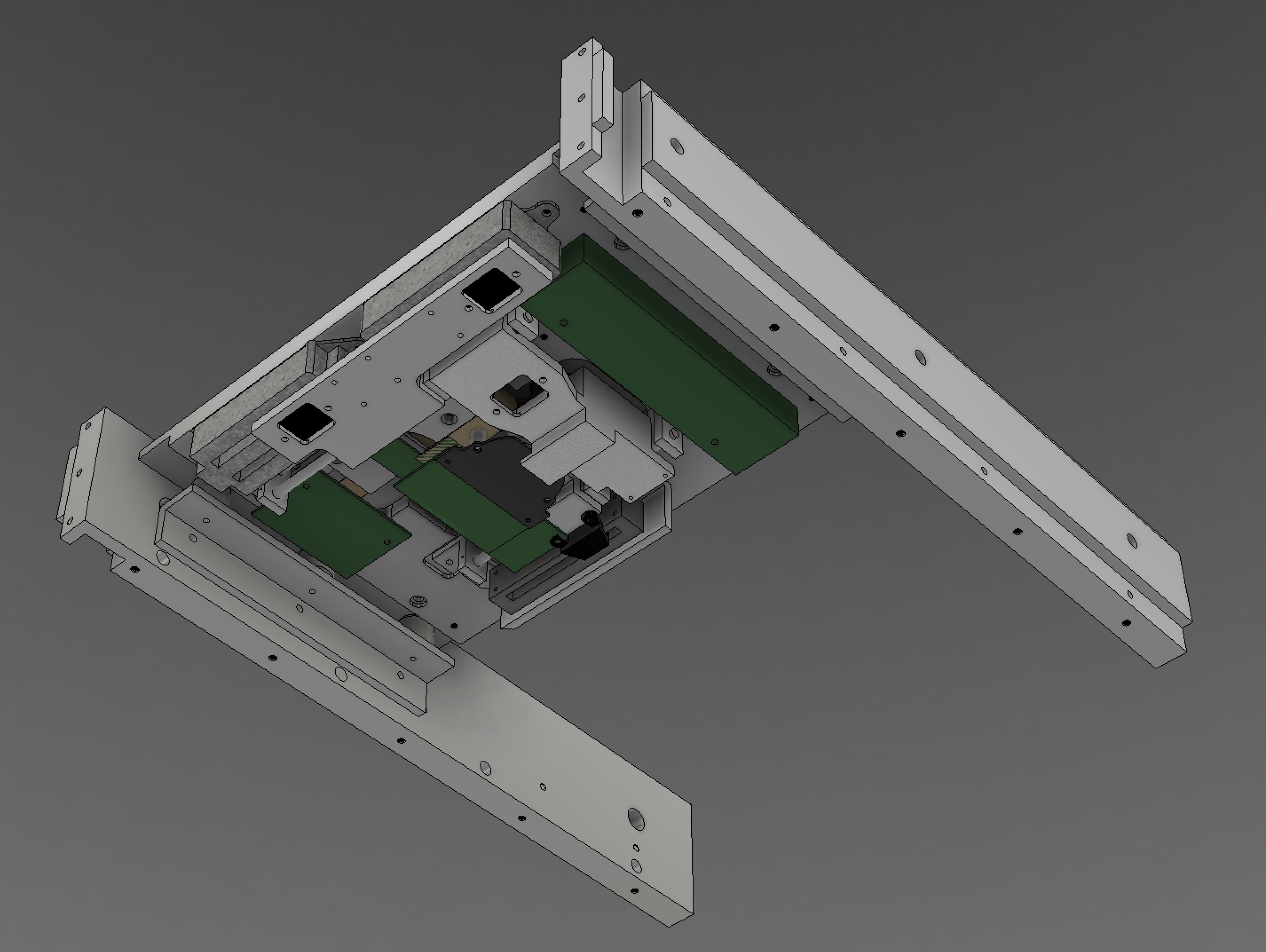

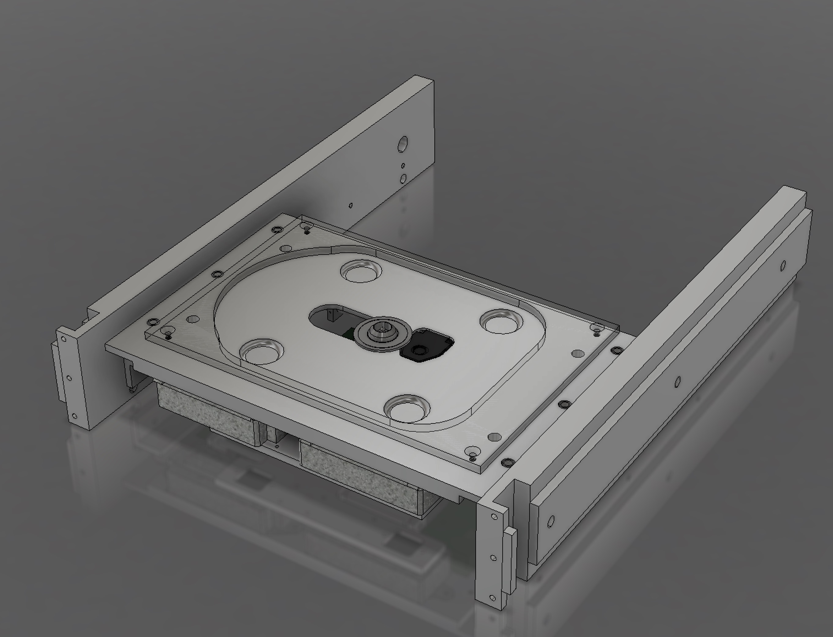

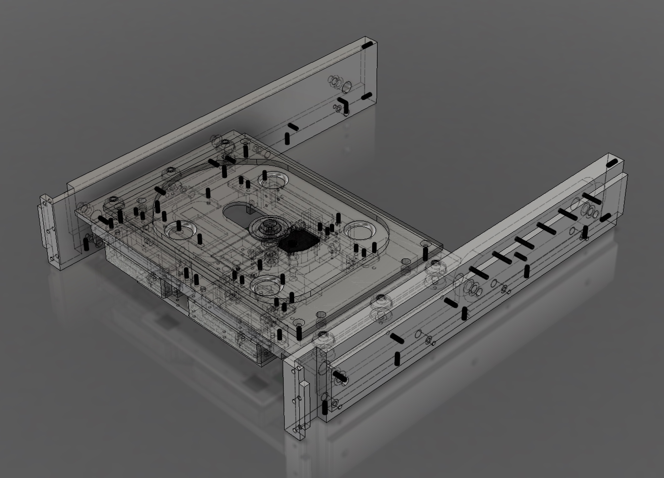

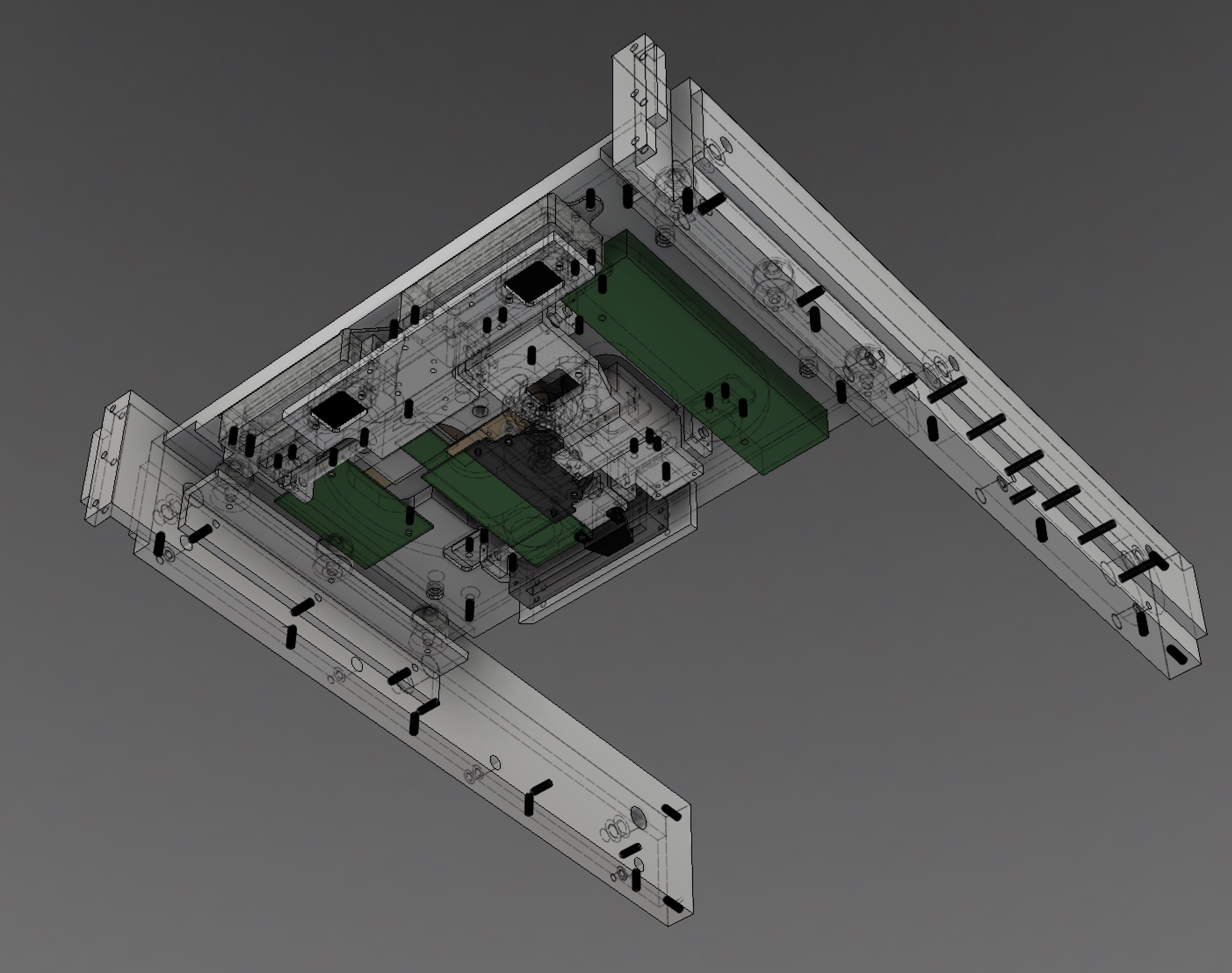

Attached is a design I made, based on the BU-1 from Sony.
But here, the disc is moving, not the laser.
Reason behind this is that the fixed laser can be more easily adjusted
and serviced.
But this drawing is as usable as a Star Destroyer for the moment: Just a model, faithfully
put into CAD from the original parts but nothing beyond this.
Things like the focal length and aperture are unkown - I simply miss the expertise.
Someone has to design the optical stuff.
I still hope that people with more knowledge will join the work.
Same with the IC - to my understanding,all those Servo Ics are
more or less a heap of opamps.
Also something to work on...
All the best, Salar
