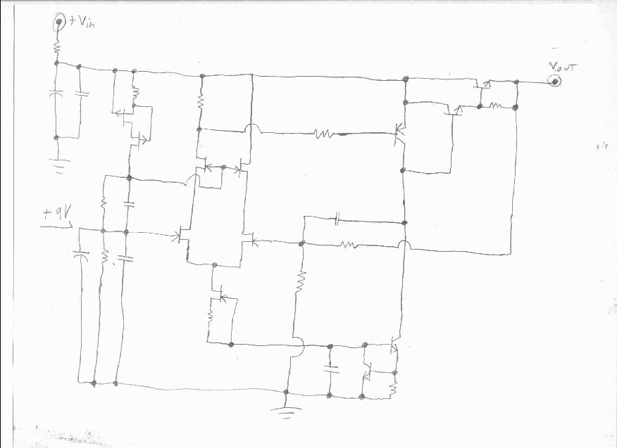

This is the last hang up on me ordering everything I need for my JFET line-amp....
I need 24v +/- regulators. If I do not find them I have to go battery. The ones I have found are what look to be crap from parts express, or impossible to find for sale LT1033CTs.

Do you mind building one from scratch (discrete)? If so
I could find/advise you on one. What is current required?
newark.com has both +24v and -24v on semi regs in
stock for .22c and .55c,
but if you want more current I have circuits for trimmable
precision voltage reference /741/3055-2955 based
high power regs. (I use these in my homemade lab
supply , only 2-3 microvolts ripple @ 5A)

I've got a scalable regulator board to spare that will do 400 mA pretty comfortably. See this thread: http://www.diyaudio.com/forums/showthread.php?s=&threadid=75994
To bump it up from 15V to 24V would require a resistor change and changing the output caps to 35V rating. Pretty simple, and sounds better than 3 pin regulators to my biased ears.

Why don't you create a clean DC reference voltage then build a descrete amplifler to amplify that reference voltage to 24V? Then build an equal but opposite polarity circuit. You will be able to get a nice wide bandwidth if you design it right. If there is no IC solution to your problem, maybe descrete is the way to go.

I am willing to go discrete. I am looking for 1a per regulator should be the most I will ever need. I suspect the draw to be less but there are no numbers on it.

If you want something quick with good performance, go for a LM317 for the positive reg and an LM337 for the negative reg.
Go onto the Natsemi website, you can pick up the data sheets there with full cct diagrams and calcs required to give your desired output voltage.
On these regs, you can bypass the reference pin with a cap and get very low noise.
very good suggestion, Bonsai, the 317/337 is much better than
the 78/79XX combo for ripple as well as the ability
to trim it to exact voltage.(10 turn trimmer)
With decoupling caps at ADJ and output less than 1mv
can be acheived at output.

I hate to be a total *** but I use a computer at the library and it has no calculator and my phone will do not calculations...
http://cache.national.com/ds/LM/LM137.pdf
Could some one help me out? I know I need 2 120ohm resistors, 2 10uf caps (think I will use 22uf so I can use FM's), and then I might just use 8 (4 per side) 33uf caps for low impedence on the ouput. I can not calculate R2 though without a calculator .

here is my preamp supply:
Notice D1/2.. D1 protects against reverse bias of device
and D2 makes it short circuit proof. Just reverse the diodes to
make the negative (lm337) half of your PS.
R2 I use a 5k 10 turn trimmer. easy to get >.01V at
output, A really foolproof power supply.

I can just reverse the diodes to have the second do -24v correct?
