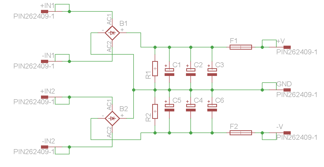

I've been designing a new stereo chipamp with integrated PSU on the same PCB. As I got into details with the design, a kind of interesting topic came up regarding PSU. I want to keep it simple, but good. As I read (quite a lot) on this topic, the following became interesting for me:

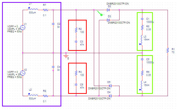

What could be a solution? A snubber. A snubber circuit connected to the transformer, and not to the rectified voltage.
The schematic:
Blue: mains tr ansformer, with leakage inductance, self-capacitance and serial resistance included. Values are not real-life values, but might be close to that
Green: reservoir caacitor with ESR and ESL drawn. Values are close to real life.
Red: Snubber. It cannot really be designed correctly, because inductance and capacitance values of transformer are not known. 47nF and 100Ohm gave a good result for large variety of transformer inductance and capacitance.

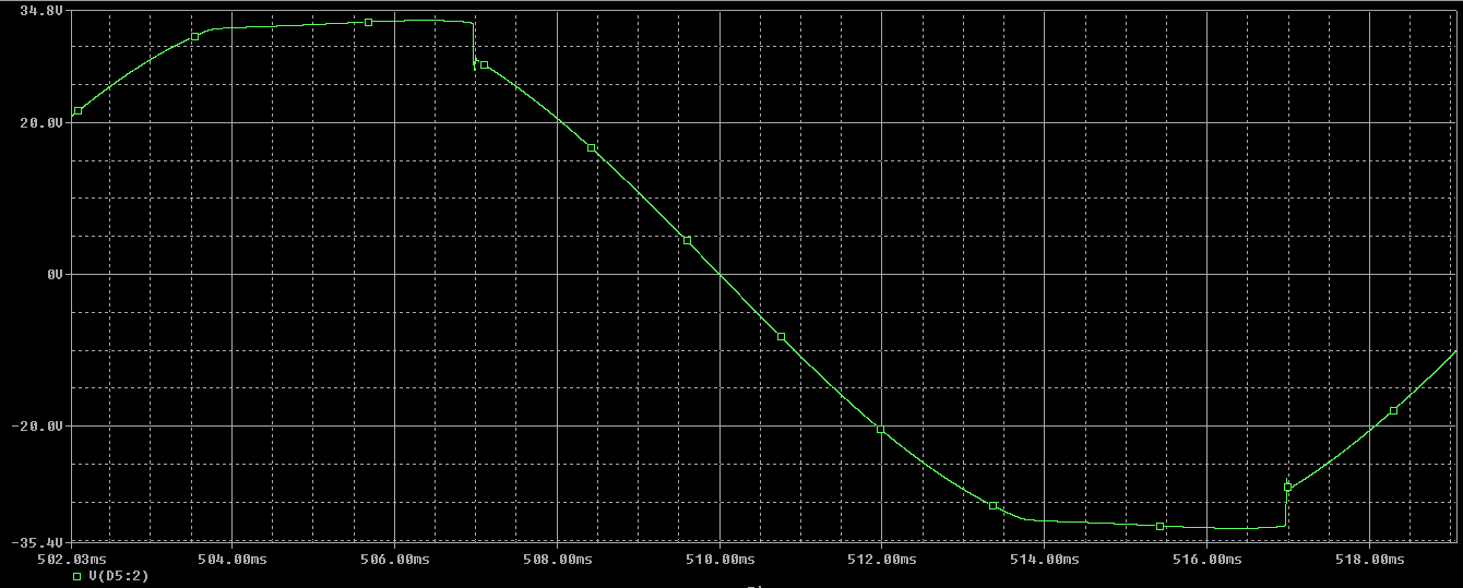

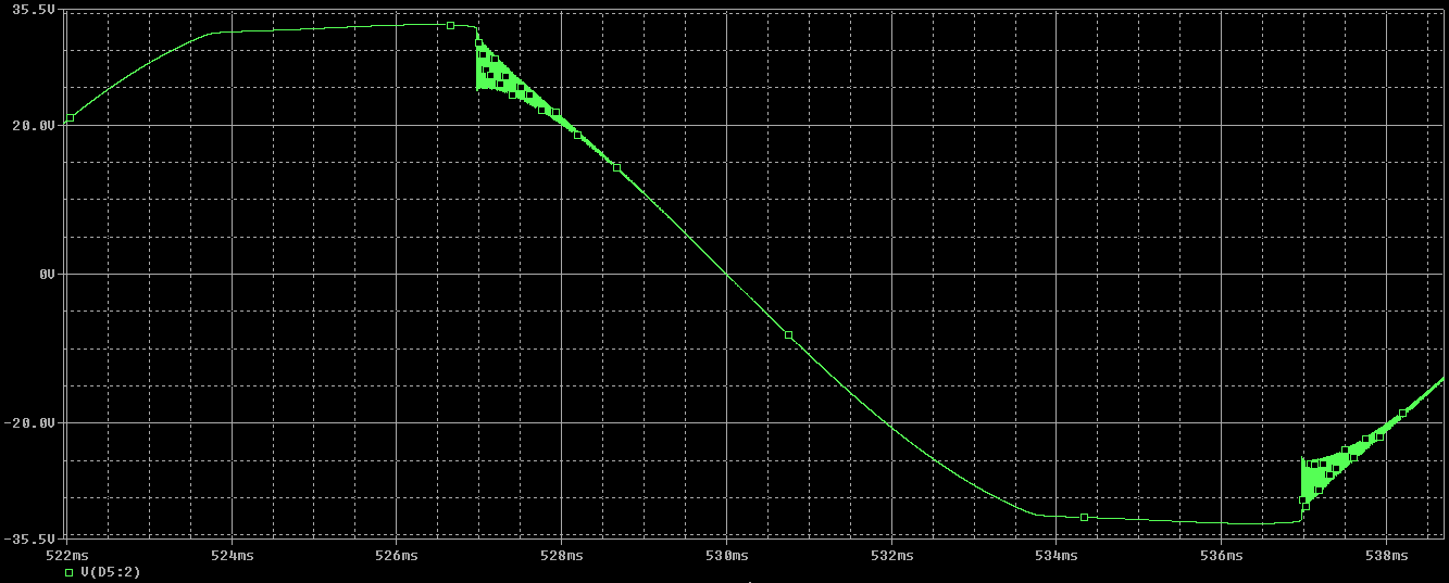

Screen-shots: Voltage on secondary of transformer, with and without snubbing.

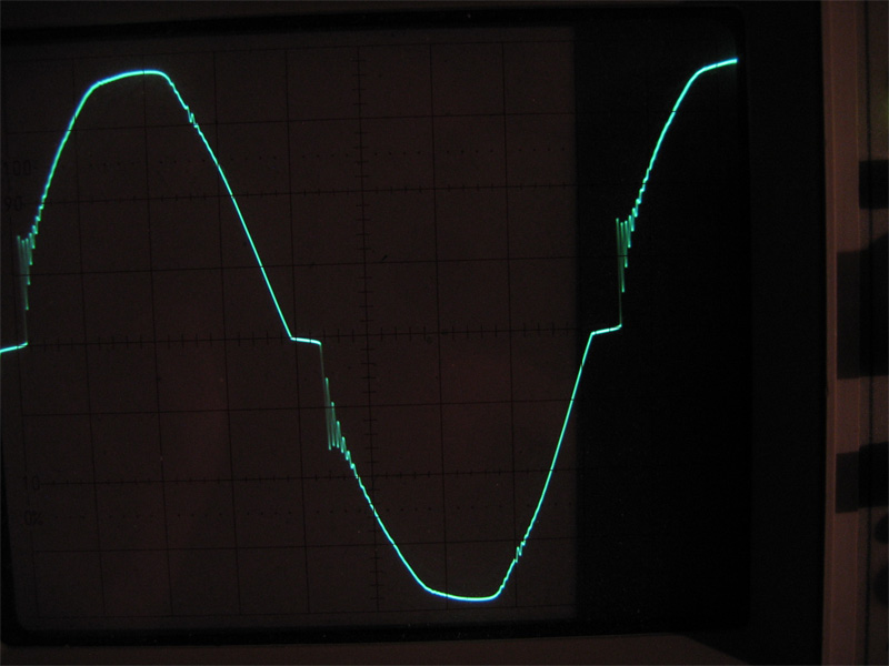

Screen shot of a simple rectifier transformer, using schottky's to feed a DC bus. I could see this noise at the heater pins of the triodes, post-regulator.

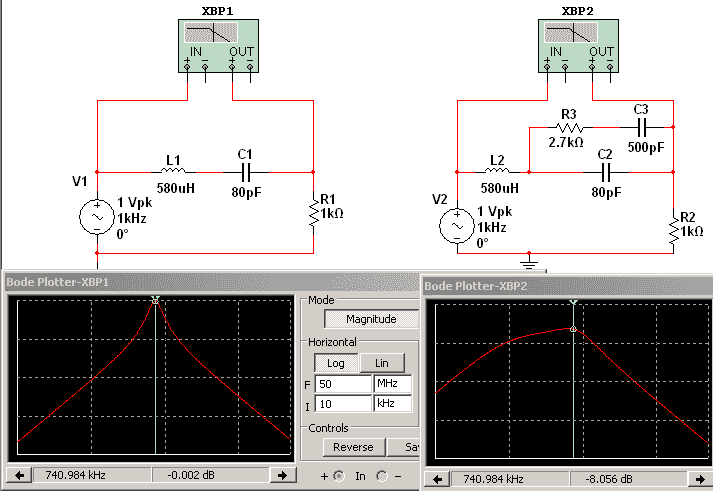

A technique for snubbing this ringing is to put a critical value R across the device and a dc blocking capacitor to eliminate the dc current thru the R (and hence power dissipation).
So I carefully measure the ringing period and then add capacitance until the frequency has halved (or at least until I can see that the added capacitance is now dominating).
If you halve the frequency then you now have x4 as much capacitance in the resonant LC. Use this info to calculate the circuit C (1/4 the added C if you halved the frequency) then calculate the impedance of the original circuit capacitance at the original resonant frequency and use the same value Resistor.
Then you'll have a well dampened RLC circuit with the added R in series with a just large enough blocking cap (too big and the power dissipation goes way up).
You shouldnt have to go much larger than a hundred pf's when trying to effect the ringing frequency.
