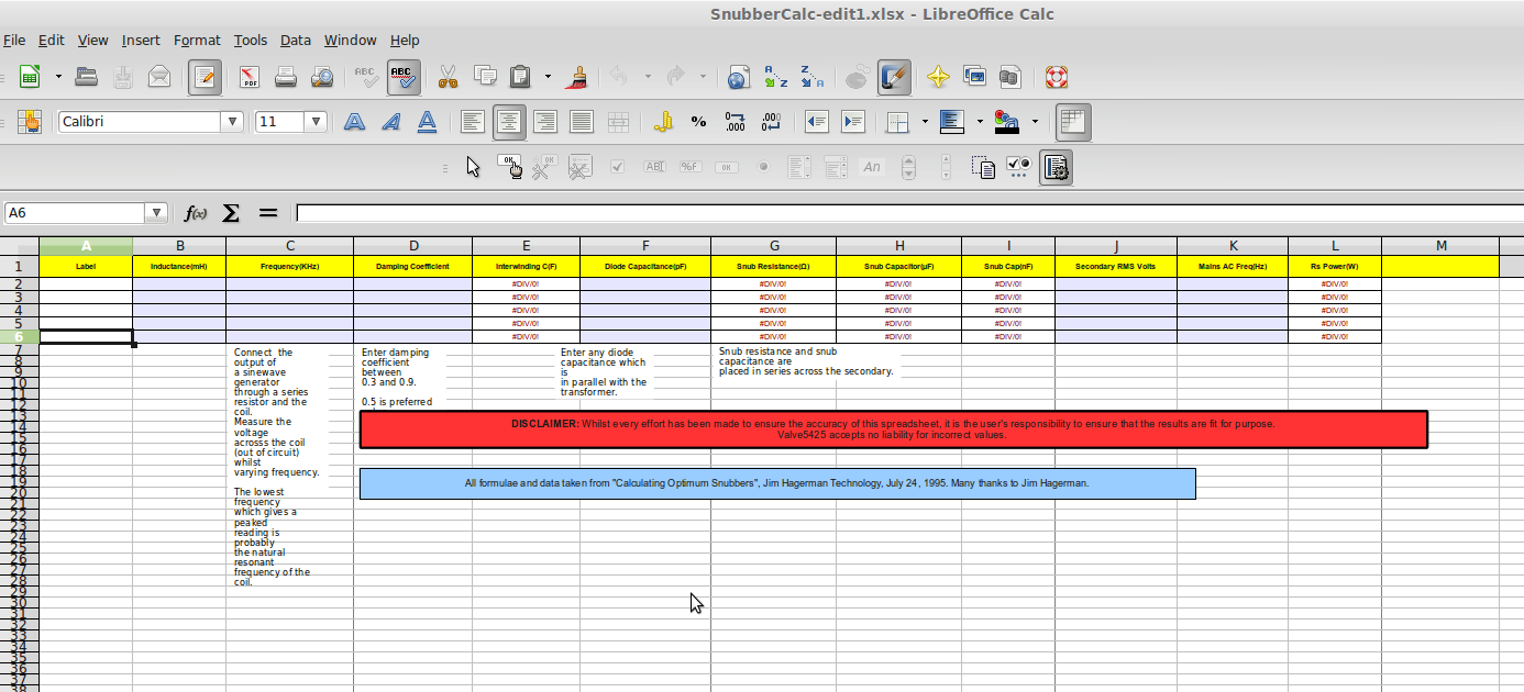

Hi Pano.
The figure stack up so the formulae must be OK. There is an issue with layout though. (see attached .png) My problem is that I don't have Excel so I'm opening it with Libre Office Calc which doesn't seem to like it. Probably just a conversion issue rather than something you've done. I'll rework the text boxes on my .ods version to see if it solves the problem.
I also have a few ideas about how to implement drop down lists so that entries can be made in any units but I need time to make that work! I think the overall concept is good so probably the best way forward is for me to concentrate on getting the .ods file working correctly and, once that's done, we could see how it converts to Excel as that will be the file most people would use.
Thanks for your contribution and I'll post the new .ods file as soon as I can.
