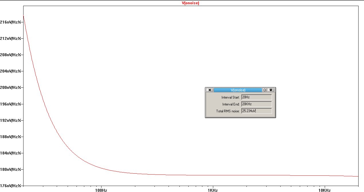

The design is quite orthodox, a Blameless with Darlington plus cascode VAS and two-pole compensation. I just sweated the details of calculating component values.
Here is the output of the noise analysis. You have to ctrl-click on V(onoise) in red to bring up the dialog. A bit of a hidden feature in LTspice but lucky for us Bob Cordell reveals it in his book.
I wonder how close yours is to my "Reasonable" effort I am working on?

thanks for the plot.
It shows ~180nV/rtHz above the LF band.
Is that the output referred noise, or the input referred noise?
It is the output. One has to enter the output node name before running the simulation. You can the plot that, or look at the contributions of individual components. But you can only view the noise voltage on the one node.
In LTspice, you specify a noise simulation. Run it, click on the output of your circuit and a graph of noise versus frequency will appear. It will most likely rise significantly at lower frequency, say below 100Hz. Now control click on the graph label. A little window will appear. Type in the stop and start frequencies. LTspice will then calculate the total RMS noise voltage for you.
As an example, I get 25.234uV for a circuit I am working on, for 20Hz to 20kHz. Peak output voltage is 34.6217V, or 24.28V RMS.
S/N ratio is 20 * log(24.28/25.23E-6) = 119dB. Not bad
CONTROL click. I would NEVER have found that! 15.57uV
So, filling in the blanks, -123 dB. Still, if it only much worse, it is great.
