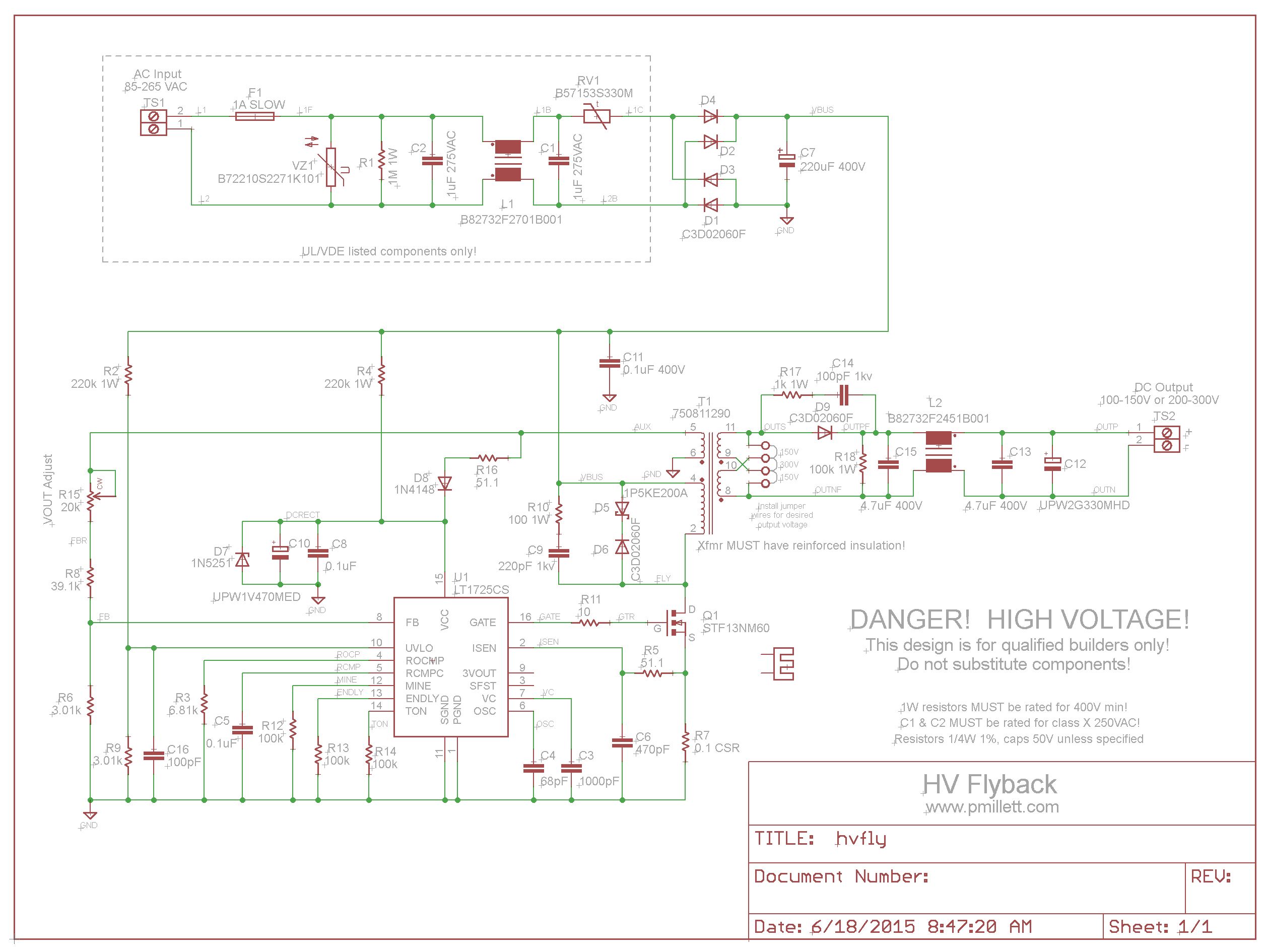

Can you post a design for approx. 150V to 400V DC, ~0.2A load current? This would resemble some medium power tube amp load.
OK...
This is the 40 watt isolated flyback that I mentioned in the other thread. The PCB (3" x 6", meets applicable safety standards) is in fab now. We'll see how it works.
Flybacks can be noisier than push-pull or bridge converters (due to the higher peak currents, mostly), but they are simpler and are the "usual choice" for offline supplies under 100W.
That said, most of the worry about noise when using switchers in audio is pure superstition. 60Hz rectifiers inject a lot more junk than a properly designed SMPS.

OK...
When I was at TI I did some work to determine how much a typical DC/DC flyback would interact with an audio DAC and amplifiers. Even in the worst case (with the SMPS synched 1kHz away from the sample rate), any artifacts were at the limit of measurablility, like -95dB...
Class D amps are an entirely different matter. You can get some, uh, interesting interactions between the SMPS and the amp carrier.
Pete

Well, probably. Assuming it works as it should
Like I mentioned in the other thread, I am a little worried about electrical safety with DIYers...

Sorry for the temporary thread hijack...
As to the original post - it seems like a rational design to me, and I think it would be a useful thing to have available to DIYers.
There is some advantage to using a DC input voltage, so you can avoid line (mains) safety issues. 13.8V (automotive) or 24V would both be reasonable input voltages - 24V better for lower input current. And you can buy plenty of 24VDC output switchers for cheap to power the whole thing from the mains.
I would suggest adding a big buck regulator to power heaters. Maybe 6.3V at 5-8A out. Ideally, sync it to the B+ switcher, maybe at 2x the switching freq. Otherwise, any noise that does get through can intermodulate with any B+ noise and you can get artifacts down into the audio.
