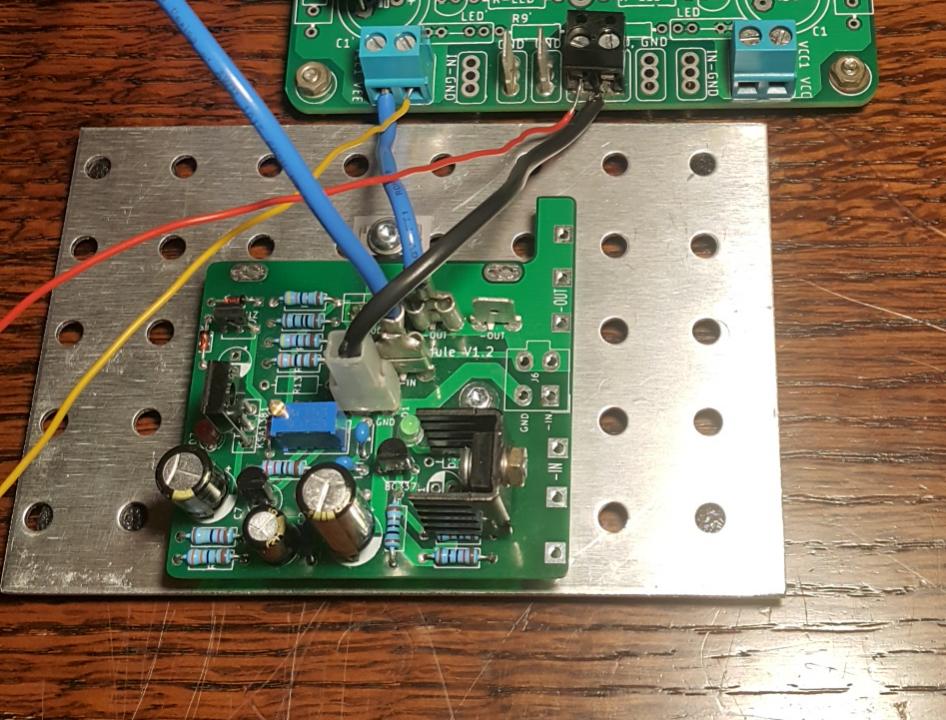

As for the regulator, I’m entertaining myself for some time with super regulator that works from 10 – 60 V and can supply 10 A current with 0.5 V dropout, 5 A with 0.25 V dropout. Measured PSRR is over 120 dB at 100/120 Hz and regulator noise is about 2 uV total. Using combination of passive filter + super regulator, expected PSRR @ 100 kHz is about 100 dB. Measured output impedance in the audio band is about 0.25 mΩ. Load and voltage regulation are very good too. I.e. 4 A load change drops output by 1 mV. For one rail, dimensions are 60 x 90 mm including heatsink, so this should fit in the existing designs.
In short, this regulator is a solution for my future builds that helps me avoid: expensive audio grade transformers, fast diodes and fiddling with snubbers, massive (expensive) capacitor banks and chokes, dual mono supplies ….
If there are others that think this would be useful for their past or future builds, I’m willing to provide proper documentation including gerbers, BOM, build guide and help. I’m about to place an order for next test revision boards, so this could be ready in two months.

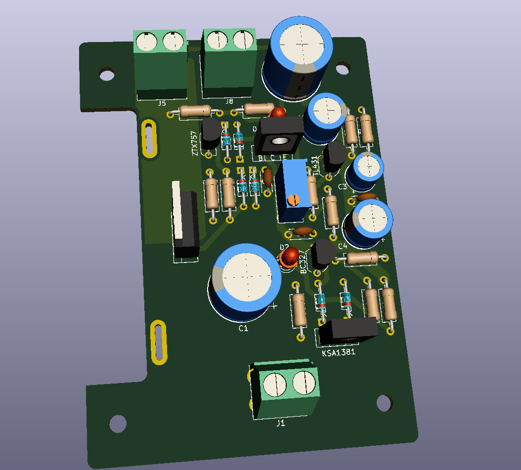

No, it’s an op amp based super regulator and offspring of another regulator on attached picture. This one was intended as add-on module that replaces resistor in CRC supply. Works well but I don’t like what happens to the MOSFET when used with say, 600 VA per rail transformer, no soft start, and HUGE capacitor bank at the regulator output. Smells funny.
Adding current limiter is not a problem but then it won’t be good for diy as current sense IC is only 2 x 2 mm.
Anyway, this same regulator is expanded with additional HF passive filter at input and small decoupling capacitors. Attached is measured transient response of that variant, at 30 V output and current change from 1 A to 9.2 A. Blue trace is voltage at 0.33 Ω current sense resistor. Base 1 A load is not visible there. Rise time of roughly 10 µs corresponds to fastest audio signal, so I think transient response is good.
Current module 3D outline is attached as well. I don’t have 3 D model for the used heatsink, so it is not visible on render.

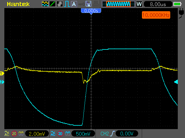

I understand that numbers I’ve mentioned (60 V, 10 A, > 120 dB PSRR, 2 uV noise) may look, ahem … “optimistic” for such a puny looking regulator, but they all are proper measured. As a little backup for those numbers, here is a “live” picture of measurement session where previous regulator iteration is “upgraded” with onboard decoupling caps and Murata input filter. It is loaded with 7.9 A @ 20 kHz with 4 us rise time and 1 A constant base load. For a such load, you would need amplifier with 80 kHz power bandwidth. I’m using active load driven by signal generator.

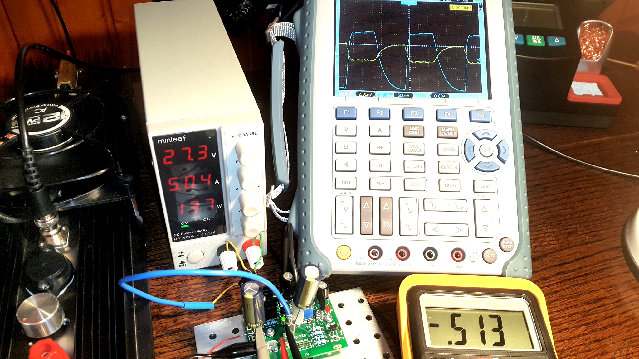

Multimeter displays dropout voltage of 513 mV and SMPS lab supply is putting out 5 A on average. Yellow trace is regulator output. It is visible that dynamic voltage drop is exactly 3 mV which determines output impedance @ 20 kHz as 0.38 mΩ. Oscilloscope screenshot is attached.

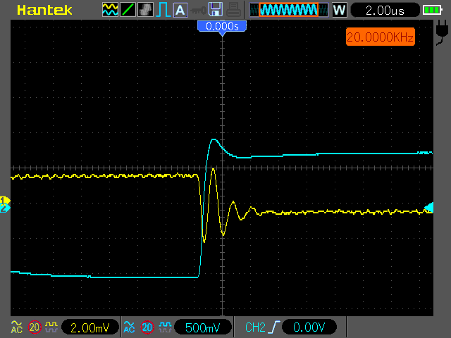

Another one is 20 kHz load with 400 ns rise time. For that you would need an amplifier with 800 kHz power bandwidth. There is visible actual regulator speed limit. It reacts in 250 ns time.
I think that transient response is among critical properties of regulator intended for audio use if amplifier modulates power supply while providing AC current at output. Single ended designs having CCS in the output stage are exempt of this requirement.
