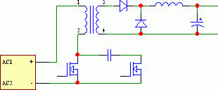

...In this case you get zero voltage zero current turn on for free, so only turn off snubber is required. Because of higher peak current and high voltage (switch with 800V capability would be required) I thought that IGBT would be a better choice.
Or maybe even better, an IGBT and a MOSFET paralleled, with the MOSFET switching off slightly later than the IGBT, as R Watson did for his 600W Flyback PFC, cf 3.6.2.3 of the ch3.pdf paper you linked to in post 26.
It was silly of me to think we could do without any turnoff snubber, especially in the isolated form of the Sepic where we will necessarily get a large positive voltage spike due to transformer leakage inductance refusing to stop conducting instantly.

Perhaps someone could educate me about this...... The spec sheet gives a turn off switching energy of 200uJ @ 25C. Multiply that by 100KHz and you get 20W
It's worse at 125C
Genomerics, maybe you have not read it, but hard switching was never proposed. If lossless snubbers worked well in the days of the bipolars, I see no reason why this little forgotten technology would not work with IGBTs.
Saturation voltage of proposed IGBT is still a little high, but I would be glad to see a similar performing mosfet in TO220 housing, costing about the same.

Jaka Racman said:If lossless snubbers worked well in the days of the bipolars, I see no reason why this little forgotten technology would not work with IGBTs.
For the turn-off snubber, wouldn't a simple capacitor in parallel with the switch do the trick? Since the transistor is switched on at zero voltage (boundary conduction mode) it wouldn't have to empty the snubber capacitor at turn-on would it?
Hi Michel,
It might work, look at slup095.pdf . But in practice, I think that the resulting voltage fall time would be rather long, somewhere in the 1us range. But that is only a feeling, do not take that for granted.
Anyway, Fig 9a from slup100.pdf is what I had in mind when proposing nondissipative snubber. It is rather simple.
Best regards,
Jaka Racman
Best regards,
Jaka Racman
Jaka Racman said:...
Yup, makes perfect sense! Not quite sure but there might even be a way not to spit out the snubber's energy into the input (which would be bad for EMI): unless there is good reason not to do it, we could swap the coupling capacitor C and transformer primary L2 so C would have its foot at the transistor foot, and let the snubber spit out into the top of the capacitor (which would be around Vin).
Oops. After a closer a examination of its workings (below), if I am not mistaken this snubber will not be very effective in our case, as it will only start limiting rate of rise of collector voltage when the latter reaches max(0, Vin-Vout). So it ensures zero voltage switching only when Vin<Vout, which will not be the case at high line voltage i.e. where ZVS is most needed!
How this snubber works:
Let's suppose snubber capacitor Csn is empty initially, and Vin>Vout
1/ turn-on: Csn remains empty
2/ turn-off: Csn charges to Vout through top diode of snubber
3/ turn-on: Csn rings with Lsn for a half-cycle so it reverses polarity to -Vout (bottom diode of snubber blocks at this point)
4/ turn-off: top diode of snubber starts conducting when collector reaches Vin-Vout (which may be 250V), and then Csn charges to Vout again
5/ Goto 3
