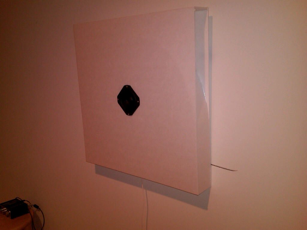

If you are looking for a compact back loaded horn, the Cornu spiral horn cannot be beat in terms of size, and I believe it is a true horn - the one I made has a 24x expansion ratio. Modifying the design to skip the middle separator panel and using alternate materials other than wood lets one make it quickly and easily. I scaled mine down to 20 inches square by 2.38 in deep and driving with a 3.5 in Vifa TC9FD.At this size, the longest horn path still should reach down to 61 Hz. It sounds amazing, you just cannot believe the open spacious full bodied sound from this tiny driver. If anyone is interested in this easy DIY build, see this thread: http://www.diyaudio.com/forums/construction-tips/223313-foam-core-board-speaker-enclosures-6.html
