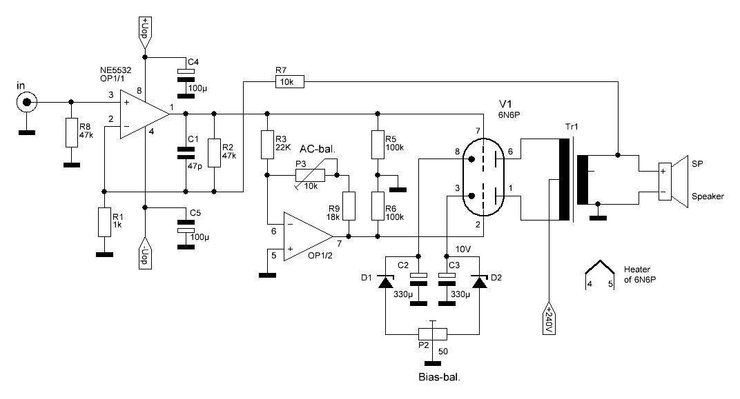

Hi artosalo,I played a little with LTSpice studying what I could get with a 6N6P as push-pull.
The tube seems very linear even when driven to A2, so I desided to use op-amp as a driver. The tube is biased to 4W dissipation/triode with 10 V zeners to
have the possibility for A2 drive and direct coupled amplifier/driver.
The result is quite surprising; 7W out with 0.03% THD.
The required drive voltage is about 33 Vpp, which means that NE5532 with max. allowed supply voltage would be sufficient driver.
The grid drive goes some 6 V(peak) positive and LTSpice shows 2.7 mA(peak) grid current. This is quite low value and I am not sure if it is close to reality.
Any ideas/comments ?

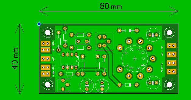

But I have designed and ordered the circuit boards for this project.
The output transformer should be some small 8k or 10k type, for example this:
TGL 20/002 INDEL - Transformer: speaker | TME - Electronic components

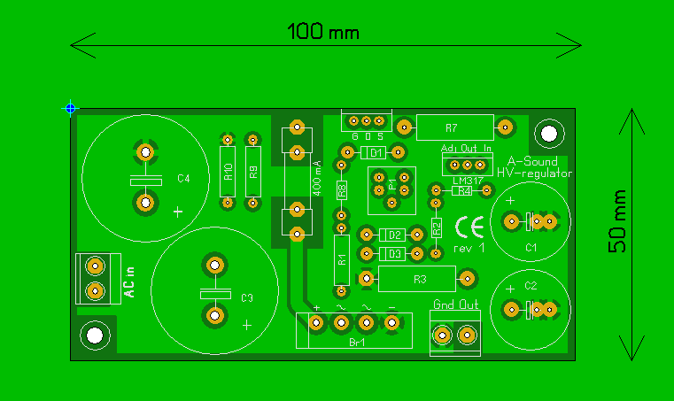

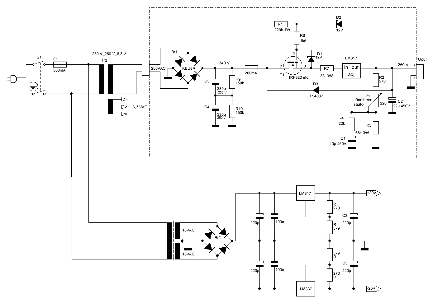

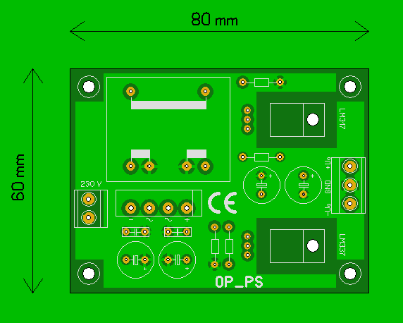

Few pictures and schematics:
Very nice! I was wondering what if we focus in low cost rather than performance, could we then use toroidal power transformer for OTP? Something ready of the shelf, but then what should be the secondary voltage and VA to fit the project? Of course, if all this doesn't make any sense, I apologize.
Did you notice what this transformer cost ? Just 23 €uros.
With this price I would not even consider to replace the real opt with power transformer.
But if you want to try, the suitable turns ratio is some 31...35 when 8 ohms speaker is used.
If you need those pcb's, just send a PM.
Yes, you are right about the cost. I was thinking of a designing approach that could take advantage of toroids but I' m still working it in my mind. PCBs are fine but I also need to deside how would they fit. I'll be following with great interest. For now, I wish you merry Xmas

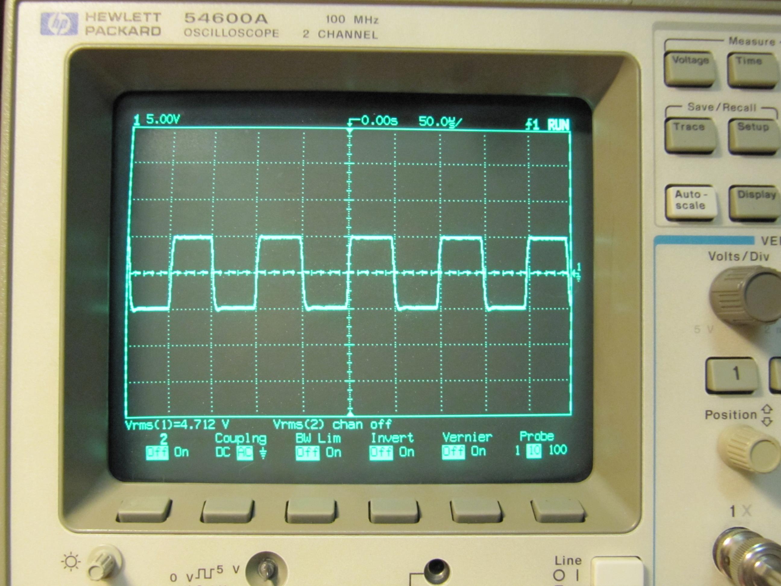

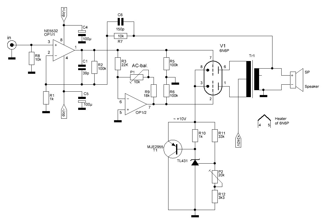

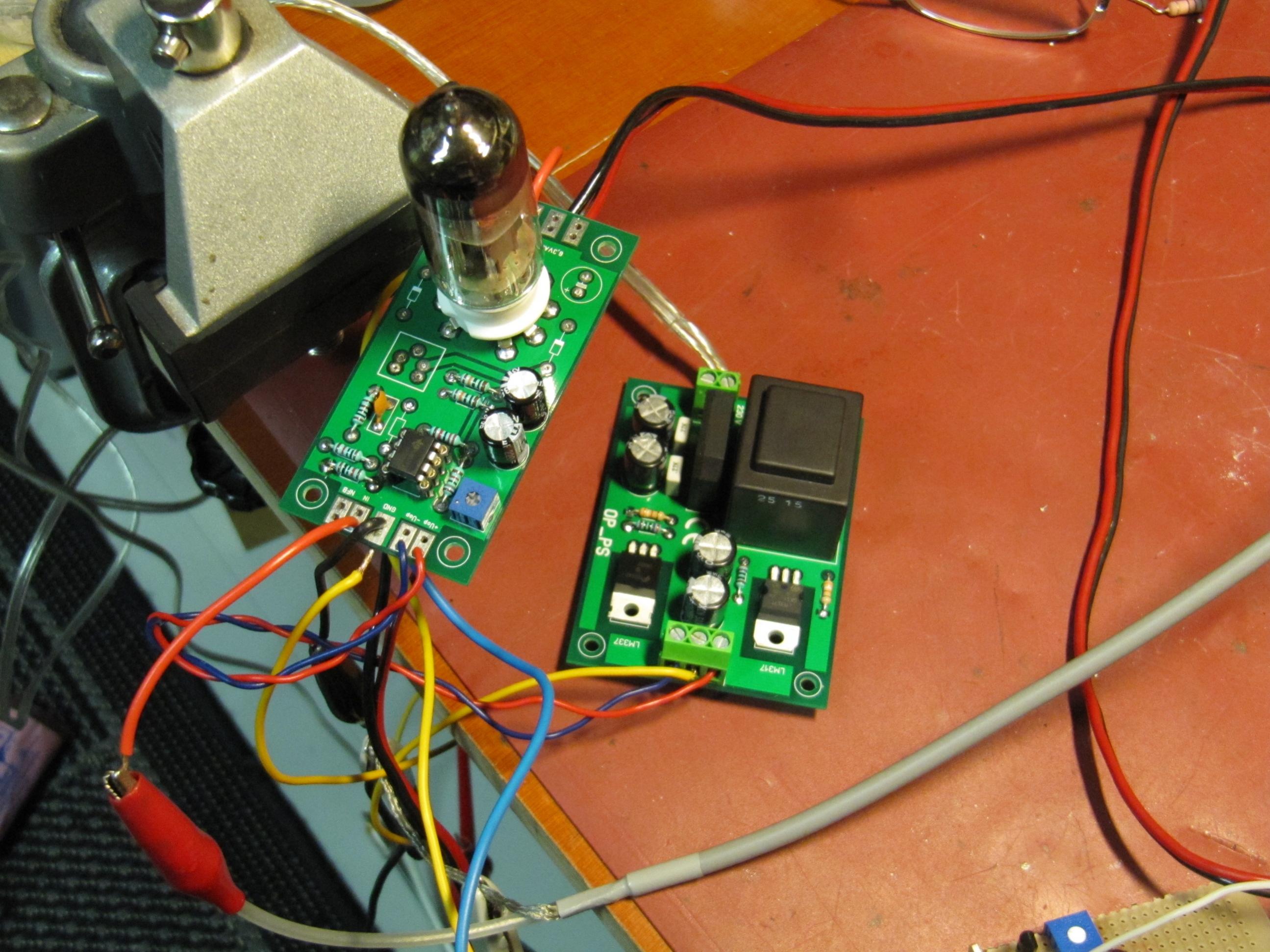

I managed to build and briefly test the prototype.
THD is not as low as simulations showed, but still quite good. At the "desing goal" 7 W the THD is 0.25 %.
Max. power output to 8 ohms load is some 8 W and to 4 ohms as high as 9 W but with higher THD of course.
I adjusted the high frequency limit (-1 dB) to 62 kHz, and the result is very a good transient response.
Attached the plot from my scope with 10 kHz square wave. The GNFB is about 16 dB.
I noticed that the zener bias works, but is not very convenient. Therefore I made an adjustable bias based on TL431 reference and one power PNP.
Now the adjustment is easier with different tubes.

I am not working on this project so far. I have built only one channel and I think it is quite completed and ready now.
Most of my experiments remain at this level, because my interest is mainly technical.
I don't even listen all prototypes, because I believe that well performing tube amplifier can not sound bad. At least I have never observed such case. Most essential information is above at post #36, but I also have a bit more extensive test results if you are interested.
Have you measure the current per tube, what's the max current using per tube?
Sure. I have adjusted the idle current to maximum power dissipation, which is 4 W/triode halve. With 230 V anode voltage the max. idle current is 17 mA.
With lower +Ub (<200 V) the idle current can be increased to 20 mA and more. This provides a bit better linearity, but lower output power.
For headphone amplifier this construction provides more than sufficient power.
