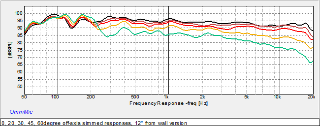

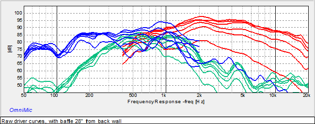

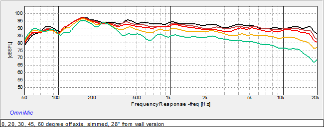

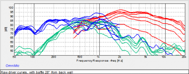

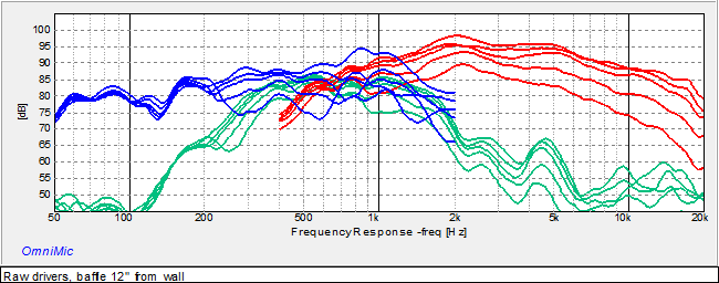

I took two more sets of responses, of each driver (or array) individually, at a variety of offset angles. And the "combined" measurements of pairs (a way of getting relative time domain data precise -- lots written on that elsewhere). I did this with the speaker at two positions relative to the back wall, 12" out and 28" out, for two likely positioning of the speakers. Here are the curves (0, 20, 30, 45, 60, 90 degrees). The 12" from wall seems to be giving me potential for some more directivity extension down to 300ish Hz for way off-axis (not sure why).
edit: looks like the 12" from wall pic is missing the 90 degree curves (which I'm not actually designing for anyway).
Notice in the curves above that the woofers actually might be able to get up to the tweeter's low end alone, except that they would go all wobbly off-axis (notice how wild the curves get up around 750Hz or so. The midrange is much better behaved there, and plays low enough to do the waveguide/array fade-in trick.

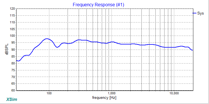

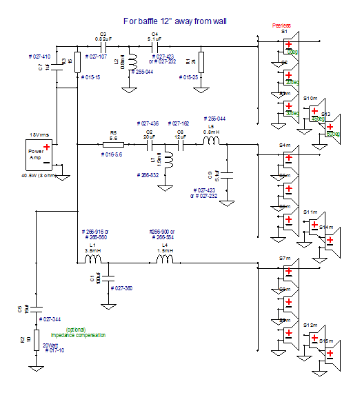

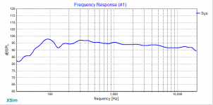

Here are the projected curves with a designed crossover for each, hope these still hold when I do get to do some better free-field measurements. (BTW -- the levels on these aren't accurate, I wasn't keeping track of the drive voltage when the curves were taken).
Yes, I already went ahead and ordered parts (including bigger core inductors, expensive unfortunately) for these designs. Also another set of drivers to make the shelf-ported version when I get done with house projects and bothering the EMTs.

There's now a downward slope of a few dB added starting at around 1kHz, to bring the brightness down a shade (tuned to taste, rather than ruler-flat..... gotta work well with recordings that exist!).
Here are some (simulated) off-axis curve families for the 12" from wall and the 28" from wall crossover versions. Again, the curves for these were taken in a not-very-open basement room, so there may well be some further tweaking done after crossovers are built and the whole mess can go outside to bother the neighborhood with best-quality measurements.
I'm HOPING that a redesign isn't needed then (like after the last time I was outside, and discovered that I had totally messed up the vertical patterns!). No vertical patterns simulated here, because it turns out the trick to getting the vertical looking decent in this design layout is to have the phase angles track decently over the handoff from midrange to woofer (and it does in these new designs).
Wish the crossovers were more simple, however there is the advantage that the drivers are better contained in their bandwidths which should keep it sounding cleaner. I do hate it when the costs of crossover inductors starts to approach cost of the drivers!
