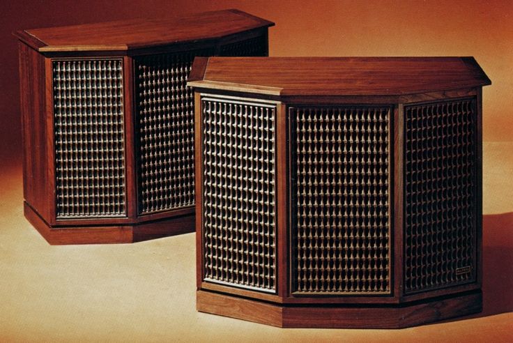

Inner pieces of the beveled, shallower, shelf ported SmallSyns
I think it looks good with the angled edges and quite retro. Definitely more of a presence in the room though and seems less "small" trade off for the volume needed to port it.
True. I certainly won't have this in the little living room of my house. The smaller sealed SmallSyns are liked by the wife, and are also about as large as she would want in there. But I think the one just shown will feel less "big" than the first ported version, which is rather deep and looks kind of chunky in comparison. It will be for the listening room, though. Could work in a living room larger than mine, particularly since it is for use up against the wall (but on a stand).
