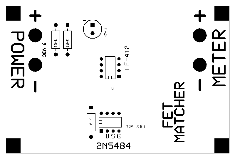

Please recommend sockets for testing these. I have searched Mouser and Digikey and the shelves of the local Electronics store and only found sockets that require the legs to be bent to fit. I have a socket that sort of works for the LSK170's but am having no luck with a socket for the LSK389's.
Jim
Jim
Sockets
I made my board using an 8 pin dip IC socket, and it works fine. If you use a quality socket (wil milled pins, not the bent/stamped ones) it works well. My design used both halves of the socket, in case the pins got lose on one side, you could use the other side. Since we used the test fixture in production, I wanted to make sure it lasted. The power and meter leads connect with alligator clips to 440 machine screws (1.5" long) as test posts. Came out nice....
I also modified some IC sockets (the type with the gold
plate machined pins). Next plan is to build a multiple socket
tester to cover whole range of small sig Jfets to large mosfets
with TO-3 and also some type of socket for TO-220.
BTW, I have several of the Hitachi mosfets and know that
Hafler had some tester to match devices with. Does anybody
know what model that was and/or have schematic of Hafler's
tester?
