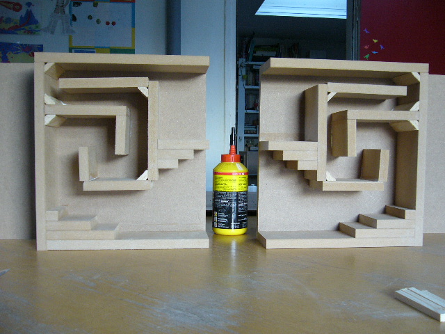

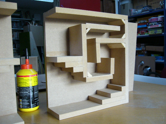

I've been looking for the same thing, a bookshelf sized horn speaker but I didn't find a really good option and most of the advice I received (which was good advice I believe) is that a very small horn has to compromise a lot of things so you might be better off with a different kind of enclosure than a horn. The main trouble is that a small horn means a shorter horn with smaller mouth and therefore a much higher cut-off frequency than you need. So you end up operating the horn where it isn't designed and it's response is not pretty.
The closest that I came across to something suitable is the Buschorn mk1, it's designed for a small driver.
:):) 35x35x13 cm , CC 1,2 liter , throath 90%.
No plans. Gave them to someone who uses them as pc-speakers , and is more then pleased.
Is the smallest backloaded hybride I ever designed.
A Fe83eN would do great!!

I agree with Horst (HM) , a 3or4 inch will NEVER reach 40 , 50 Hz.
My hybrids lowest point was about 100 Hz.
But if they do everything sweet above 100Hz you can hide some kind off sub (with a plate amp) somewhere in the room.
If you do find something that reaches deep below 100Hz with a 4 inch, please let me know!!
Good luck , Leon

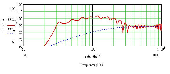

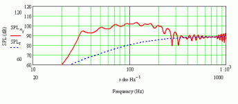

Just about. ;) That's a full-sized hyperpolic horn from when GM and I were having some fun, oh, must be a couple of years ago now.
I'd have to recheck the exact dimensions as it's been quite a while, but IIRC, axial length was 263in, M=0.385, St = 2.7in^2 & 74.5ft^2 terminus area. You'd need some digital delay of course on everything above Fhm as you'd otherwise have a completely unacceptable group delay (~19.4 ms).
Not exactly practical, or what you could call a desktop speaker. Could be good for a laugh though, if you've a spare barn handy. As I recall, GM's was even larger.

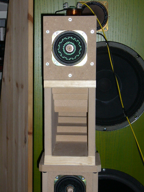

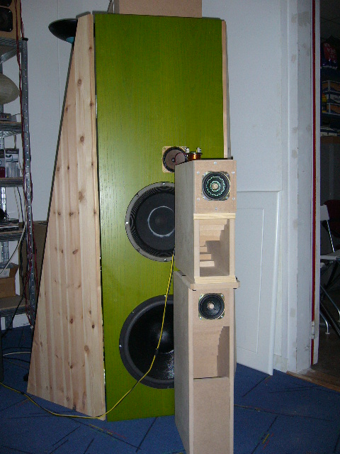

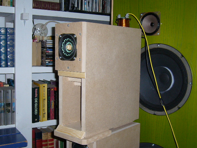

Once found a Japanese site , with a lot of pics.
The guy did a bunch Nagaoka style designs with the FE83e.
I copied some of his research and adjust some of it to my needs. ( had 24 x foster 85 mm FR, the one you see on the pics , and had to experiment with EnAble anyway at that time. )
Build 2 of his designs and compared it to a downscalled 108 Concerti clone.
All 3 sounded okee.
Then I tried to make it smaller, result is in the pics.
Most people who heard them couldn't imagine that there was NO hidden woofer!! (On low volume!!)
