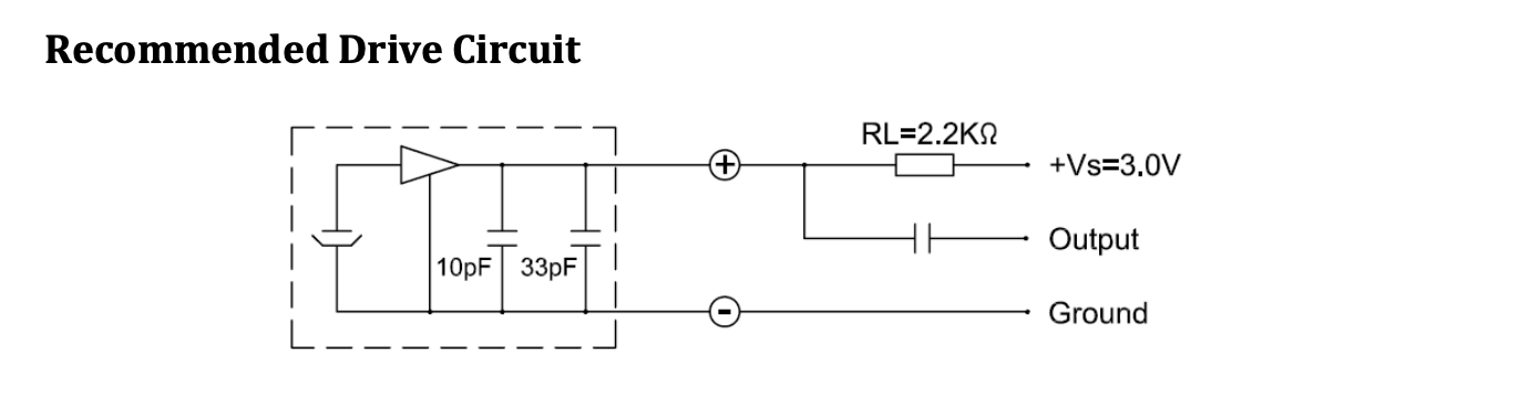

I realize that this thread is a few years old. This is my first time making a microphone pre-amp. I will follow up on @inkl's question above asking more specifically why I cannot use the SSM2019 pre-amplifier in conjunction with an electret condenser mic capsule. I have several of these capsules as well as several SSM2019 that are available for me to use, so if possible and not a terrible idea I would like to try them together. I will post this here, but possibly follow up with a more stand-alone question since this is piggybacking off of someone else's thread.
Some quick background:
Before the pandemic I purchased a bunch of AOM 5024L electret condenser mic capsules based on someone's recommendation, due to what seemed like a flat frequency response over a broad range, high sensitivity (-24dB) and a favorable reported signal to noise ratio of 80dB (see spec sheet). With careful soldering and otherwise very little modification to this mic capsule, I attempted to use it w/ a commodity USB-Audio Mic input (Tripp Lite) as well as with a consumer grade Amp (FocusRite). Unfortunately the amplitude of the signal recorded via the capsule on either of these devices was too faint to be useful.
This led me to think that I might need some sort of a pre-amplifier to amplify the measured potential before it reaches the above USB-Audio DAC. Currently I would like to revisit the use of these capsules, as it would be a shame to let them go to waste. In my brief research about microphone preamplifiers, I came upon the Analog Devices SSM2019 (where I saw it used by someone making an impedance tube).
Above I have posted a recommended drive circuit, showing that there is some internal circuitry inside the capsule. It could be that I was miswired this altogether and should try again, since I might be trying to listen across the wrong points in the circuit.
Thanks for any pointers and for clarifying about the issue of why a SSM2019 is not useful for this type of mic. First time working with this type of audio electronics.

You should check out this article. Those capsules make excellent mics and don't need their own preamp provided the recording device you plug into can provide power: either 48V phantom power eg from a USB recording module, or low voltage 'plug-in power' from portable recorders etc. The article covers both scenarios.
https://www.instructables.com/The-Sound-Sleuthers/
Thanks - this instructables article looks great.You should check out this article. Those capsules make excellent mics and don't need their own preamp provided the recording device you plug into can provide power: either 48V phantom power eg from a USB recording module, or low voltage 'plug-in power' from portable recorders etc. The article covers both scenarios.
When you say this do you mean that I might want to use a low noise LDO (such as ADM7154) on the 3V supplied by an 1/8" audio jack? It's true that the TrippLite USB-Audio DAC I'm using might contribute significant noise on it's own.Just remember that the 3V supply is part of the signal. Any noise on it is
part of the signal so the supply needs to be VERY low noise. My GUESS is
you'll need 20-40 dB of gain in the preamp.
