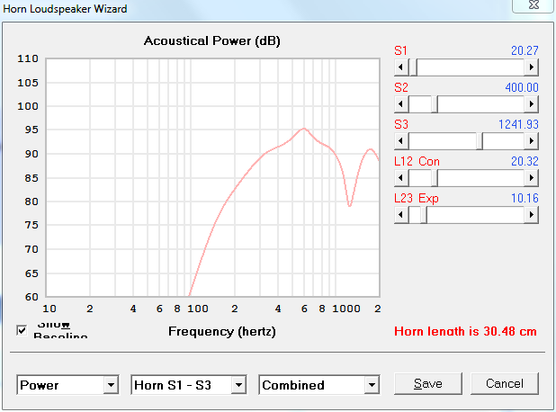

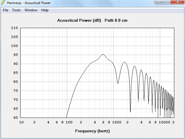

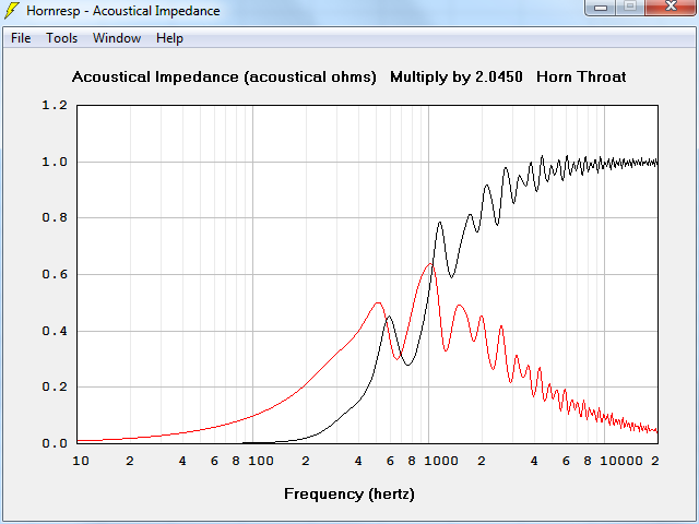

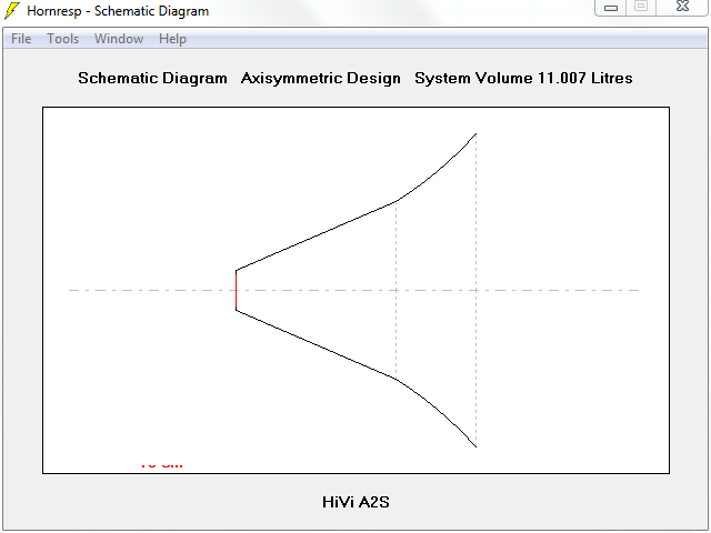

The sims definitely look funky, but that's not necessarily an indication of how it sounds :) Here are the input parameters I used with an estimated S2=400:
Ang=1.0xPi
Eg=2.83
Rg=0.10
S1=20.27
S2=400.0
Con=20.32
S3=1241.93
Exp=10.16
Vrc/Fr/Vtc/Lrc/Tal/Atc=0
Looks like 90 +/-5dB from about 200-1000Hz into a 1xPi space. Your actual room is obviously quite a bit different.

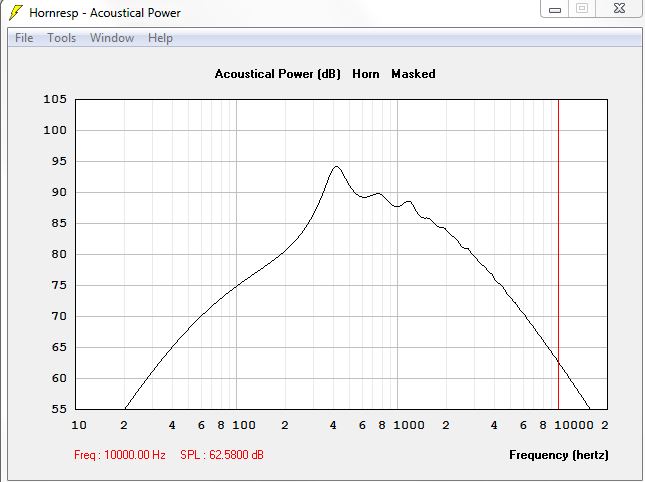

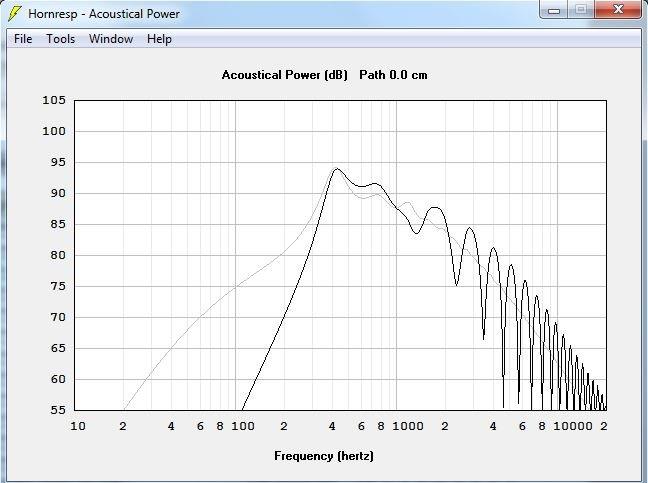

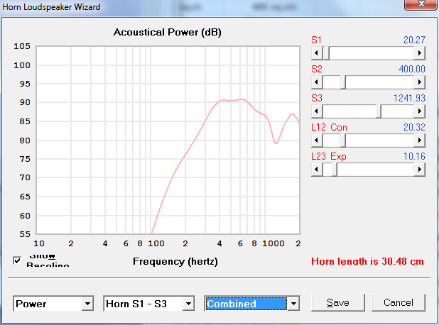

Are you simulating with a closed rear chamber? That yields different results than an open back driver because of the interference from the back wave. Set Vrc=0 for no back chamber.
Edit: Here's the combined output into 1xPi and 2xPi in the loudspeaker wizard, 1W input, masked resonances. I was never sure why the HF always seemed to roll off with almost every simulation, but it definitely doesn't in real life. Cone drivers definitely beam at higher frequencies so they will be very audible on axis.
It's because Hornresp by default shows the power response, not the pressure response. Directivity effects are not taken into account.
The pressure response of a single-segment horn can be calculated using the Directivity tool.
