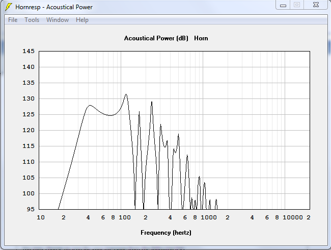

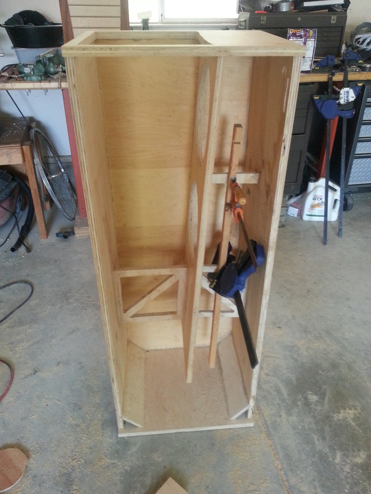

Here is an alternative to the PAL12 that achieves more 35-100 Hz output in 8.5 cu.ft versus the 9.7 that the PAL12 takes up with equal/lower cost. I say lower because I was able to buy 2 SWS12d4 drivers (500 watts each, 15 mm xmax) for 65 a piece which totals 130 (less than 165 for a lab 12).
It's also a tapped horn, it's my own design so let me know if you are interested in the model. Downside(s) - casters aren't in the original design but can be added and drivers are a pain to install.
More power handling at 1000 watts displacement limited with 30Hz HP 4th order or more. Impedance max and excursion minima around 38-42 Hz (perfect imo)
sabaspeed521;4127308 It's also a tapped horn said:That does look pretty interesting! Did you have a set of drawings for some dimensions? I would love to model that up in solidworks and compare to the PAL12

Tests have gone well, upper bass is about 4 dB less than the 40 Hz region (as expected). It struggles a little with 30 Hz material but playing within it's passband it can get very loud without stressing. Intended to be HP at 32-35 I can't really knock it for not playing 30 loud . Haven't done outdoor tests so can't comment on that front. One thing is if you have 5x5 material it's easier to make the sides the full 50 inches and then put the end pieces sandwhiched, my version requires 1/16 inch accuracy because I had 4x8's to work with and matching side length is tricky.

If you make it 48 long that won't be much difference from 49.5 (what I built). You'd lose 1 hz cutoff. So 36 Hz would be f3 rather than 35.
One thing to keep in mind is I would put both drivers facing inwards because I have a hunch that it chokes it at high output to have push pull (either variation). Only noticeable with 30 Hz content so may not be an issue.

Pay me 2 beers and I'll get around to swapping driver orientation haha, anyways it doesn't really effect me because I have my T60 covering the extra low range anyways and I'm only really using the 2x12 for "fill" in my tiny 10x13 room.
