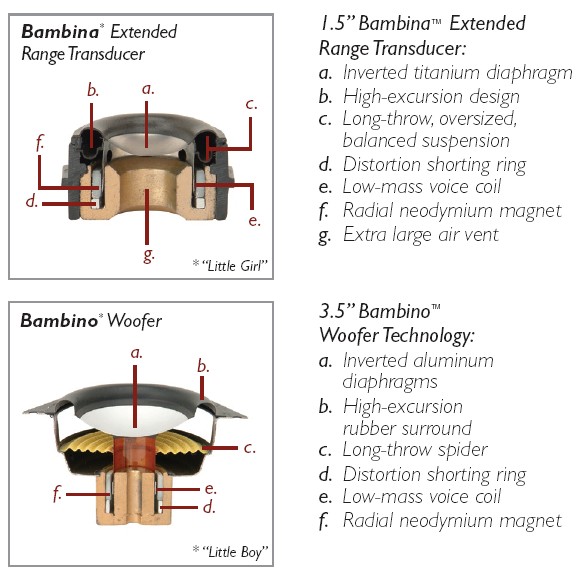

catapult said:Is the rear chamber removeable on those things? I don't see any sign of the mounting ears on SL's design. Maybe he took it apart and the backwave has a long tube for damping. That might change things for the better.
There is no rear chamber on these drivers, the back is open. There is a ring magnet assembly, and the speaker is visible through the middle. An enclosure of some sort is required.
The other interesting thing about these is that they have no terminals. To use them, you have to solder wires onto little plates. (kind of a pain)
planet10 said:If you wanted the best 2" mid-tweeter you could get your hands on, the Jordan JX53 or the 50mm Bandor units would be on the list.
I know a guy who has a pair of JX53's. A while back, I asked him if he wanted them included in my test of small drivers, and he said no. Later he admitted he was afraid I would say they did not perform well. I find that the more expensive a driver is, the less likely it is to get tested and compared to similar and/or cheaper drivers. It's never a guarentee that something is better because it is more expensive. See my recent tweeter tests for an example of that.
Have you ever tested those and compared them to similar size drivers?
Zaph said:There is no rear chamber on these drivers, the back is open. There is a ring magnet assembly, and the speaker is visible through the middle. An enclosure of some sort is required.
As a side note, this is what the aura motors look like on the inside. These are also used in the M-Design towers. (thus the funky driver names) I can't tell from the picture if the one on the top is the NSW1 or the NSW2, but they both share the same motor geometry. The one on the botom is the NS3, which is a much nicer driver.
