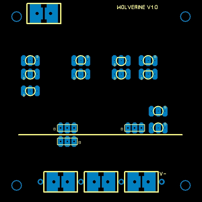

Slewmaster - CFA vs. VFA "Rumble"
You read my mind , AJT !
All OPS and IPS are perfect 76.2mm (3 inch for N. america) width.
All connectors are ANY combo of 2/3/4/ or even a 10 position
5mm LS standard euro- terminal.
Board holes are 6.27mm from corners (1/4").
All VAS TO-126 devices are 25mm apart ,
and use the same 25 X 60mm aluminum flashing or copper plate like the badger.
Electrically - ALL IPS's have 4-6ma VAS's , draw 12-16ma per rail from the multipliers (on OPS PCB) ,
and can run 55-85V rail voltage (standard or boosted).
The reason for 76mm width is that cheap Ebay surplus FR-4 comes in 3/6/12"
lengths.
Below is the "wolverine" standard IPS.
I'm also working on the 5 pair OP - it is just an "extension" of the 3 pair OPS.
I'll release all of them simultaneously. (2 OPS /2 IPS )
PS- My CFA (NAD-NX) and the Wolverine have EXACTLY 4.6mA VAS current , swap to the OPS brings
NO change in bias. ABSOLUTE standardization - physical and electrical !

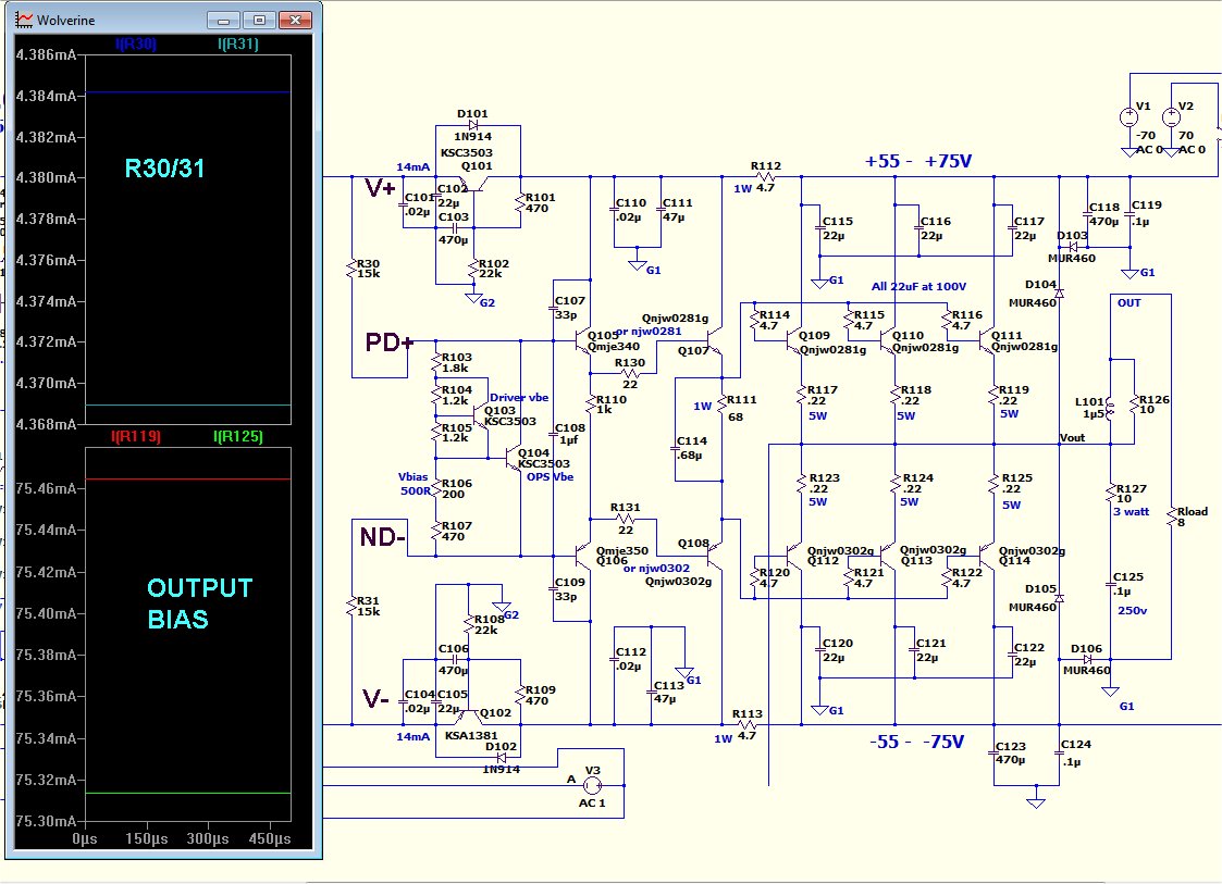

OPS static bias...
Without an input stage , 2 -15K resistors screwed in between V+/PD+ and
V-/ND- will allow for standalone bias adjustment of OP devices.
If you adjust for a lowish 25ma bias , any IPS up to 7ma will only
increase bias to 120-150ma. Any in my 4-5ma VAS "target" will already be
close to optimal bias. :)
AJ , to swap ips's instant with a relay would entail the OPS going open loop and unbiased. Even if
this happened for a millisecond - magic smoke might arise.

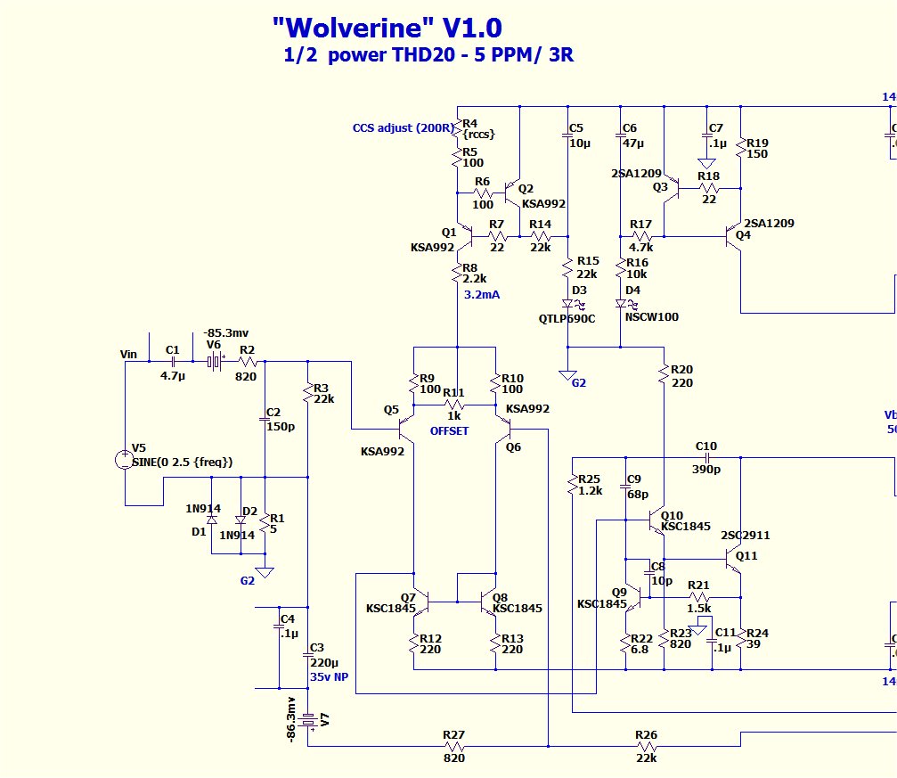

More simple "Wolverine"
I said to somebody .. "drop the Cascode" :D
That's what I did.
To use my target of the parts count instead to "firm up" the CCS.

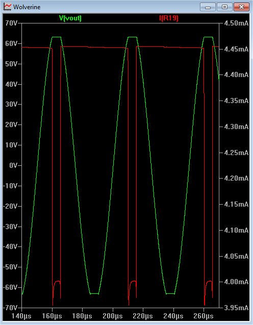

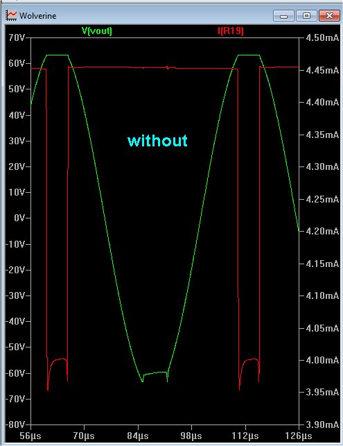

When the active half of the VAS goes into saturation , even as the
clamp tries to compensate ... the CCS also tries to compensate.
Having the 2 CCS's fed by the same reference , (badger,self,many others)...
allows the VAS's "misbehavior" to feed back to the LTP.
A separate reference cap and divider for the VAS CCS is the solution.
(below - with/without)
The "clip" is tamed , DC offsets at the OP are minimized (during clip).
Still at 3ppm THD with only 11 semi's (parts count "target")
LED's for each CCS to verify operation. (led fetish) :) .

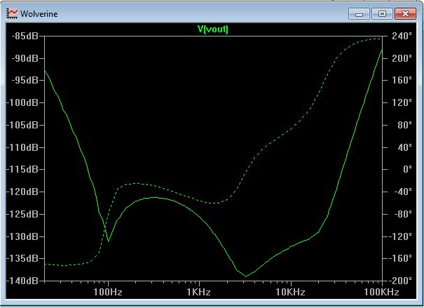

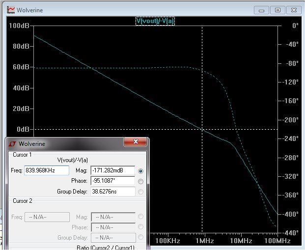

Typical "blameless"
Tuned the ULGF and checked PSRR/SW.
All checks out - 99.999% sure that it will perform like cousin
"badger".
Now for the IPS PCB - design done !
PS - the first ""blameless triple" .. cool.
OS

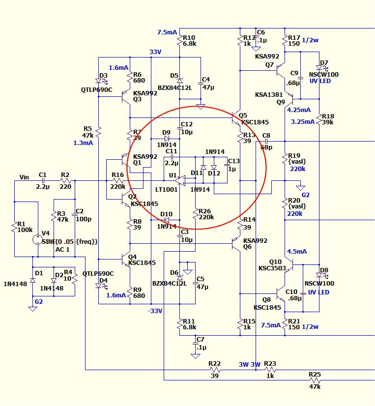

To servo or not to servo ??
I just added a CHIP :eek: :headbash: (op-amp) to the CFA.
Any real CFA seems to have them. It does seem to relieve
a lot of issues with just a few devices. One issue was the high THD at LF -
(thanks to esperado).
With CFA , to control offset on the NFB input , more current would be needed
to compensate. To "servo' the diamond (non-inverting-high-Z) ,
just nA's are needed. Another good factor.. is that I can preserve the diamond's Hi-Z.
So , Used a generic LT1001 ....
Now, I get nV's of signal -less offset , a few millivolts at LF , and
1mV above 500hz.
It does get rid of that bloody huge cap and the precision trimmer.
And... it Works !
