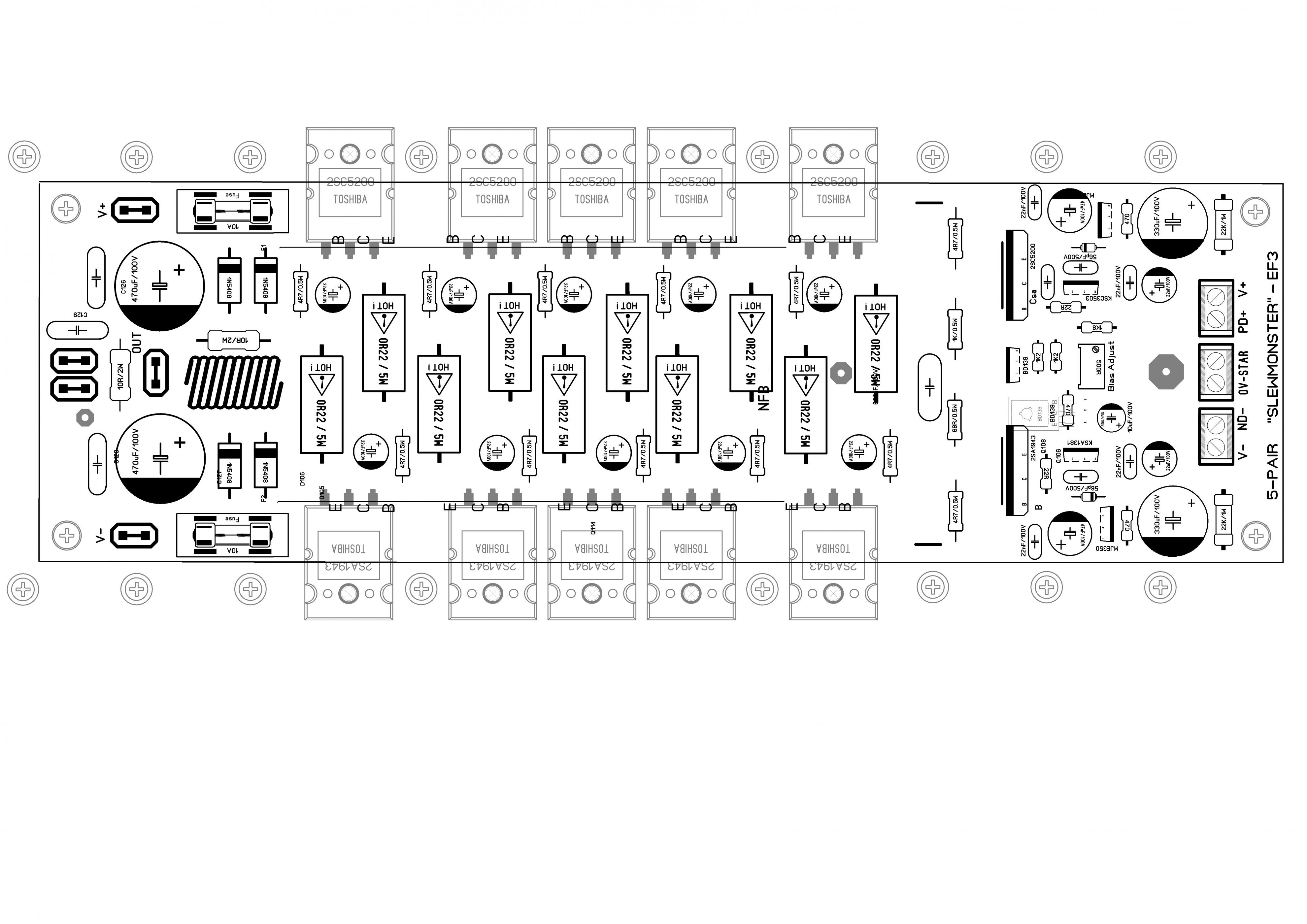

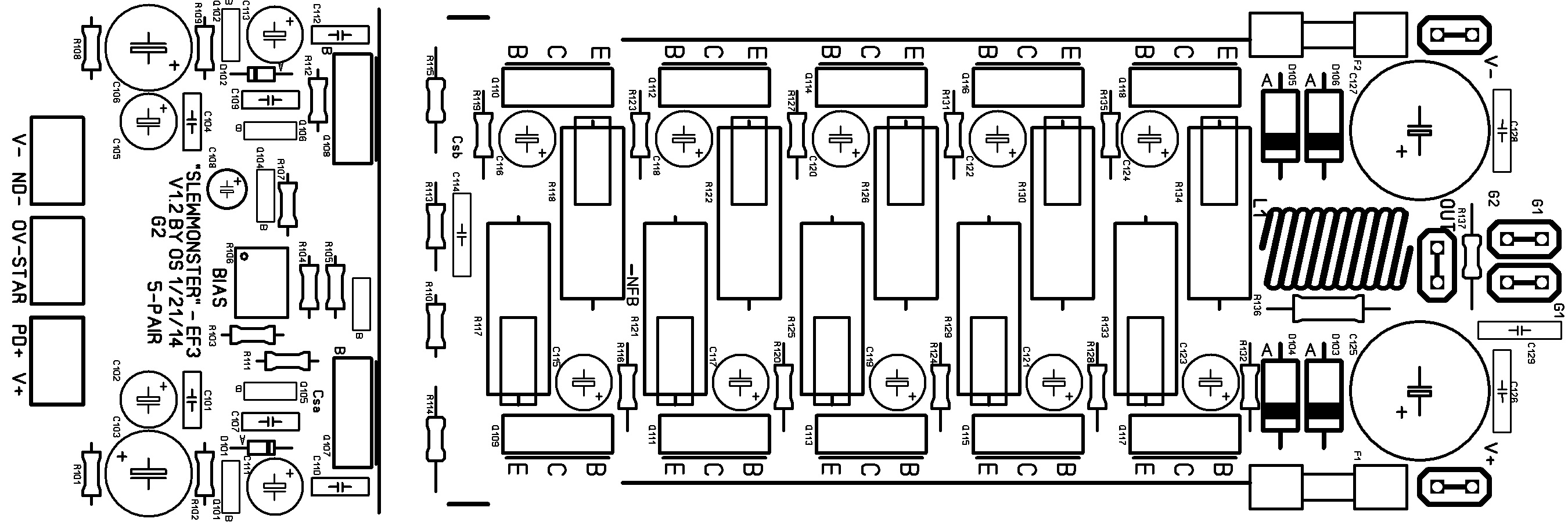

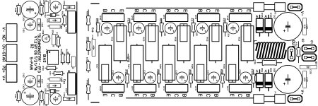

In my configuration i have to hold three large heatsinks together by using an aluminium sheet.The nuts and bolts have to be placed in specific positiions so i have to redesign the output stage as below and rearrange the output transistors having three pairs closely placed at the middle with the other 2 pairs placed a bit further away on each side.
Will i have any temperature issues or other issues with this arrangement?
If your heatsinks aren't ideal the center transistors will run hotter than the two outside and will current hog. We saw this with the original Slewmaster boards too, that's why Pete did a second design with the larger spacing.
Can you post the second design? I only have the one below named v1.2.
