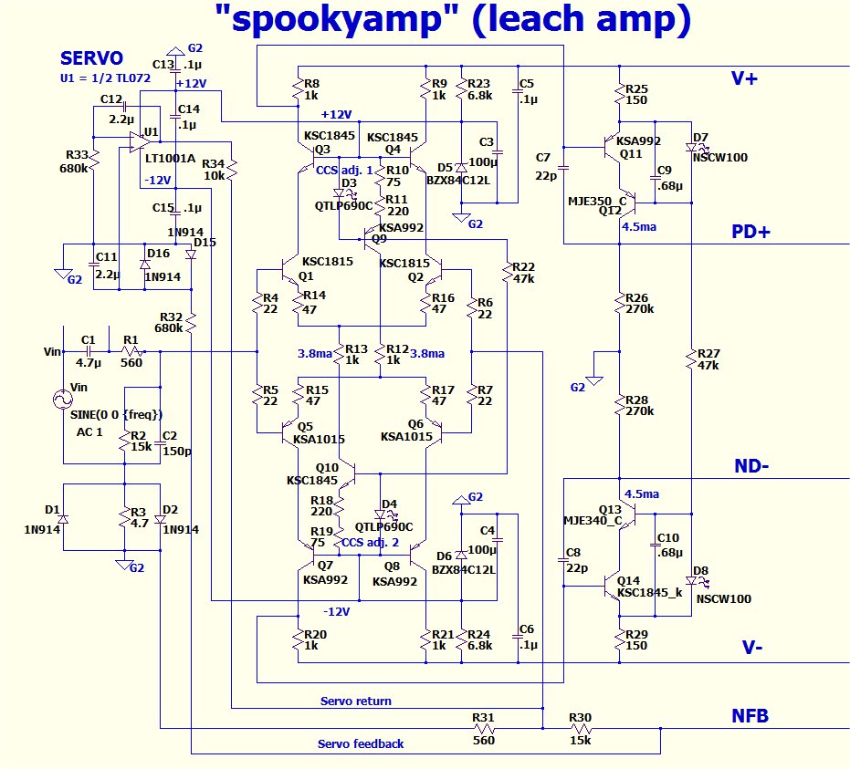

Leach amp - "spooky" is done.
WHAT an amp ! Never tried my hand at this topology , I like it.
Massive slew , got it down to single digit PPM without beta enhancement.
Goes real well with the Hawksford/servo combo.
Stole the HK-990 servo (inverting servo) , amp will run without an
input cap (DC). Slew is awesome with the DC input (200+).

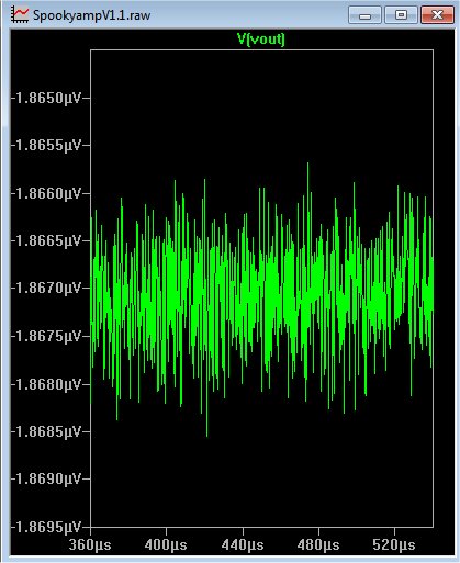

(below) is schema + .asc.
Slewmaster.txt is now (Keen + ksa1015/ksc1815).
(Below 2) is static offset ... WOW !

Sorry...Mlloyd1 , the hafler folded cascode is not even close (.05% vs. 5ppm)

68 freakin' components .... it will fill that 76.2 X 88mm blank of mine.
It will have 2 trimmers for the CCS's , adjust both total IP current and
compensate for any offset the servo misses.
Since it is a big one .... I wanna' do it first.

I think it is finalized , it will run with 10pF cdom before the square wave
"rings" - VERY stable !
PS -Finished PCB will be a very similar layout to the "NAD-S" IPS.
(CFA/hawksford/servo) .... almost a perfect rumble (symmetrical CFA vs. VFA).

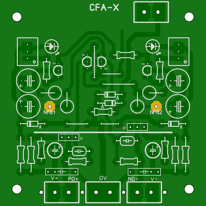

"Simple" must be laid out as such. VERY short paths ....just a few CM's
between input pair and VAS ... compensation caps "huggin' the B-C
junctions. Had to split the NFB (NFB 1 and 2) as the amp has dual feedback.
Split NFB wire should be no issue.
CFA-X is my
only sim that will run without ANY compensation. I was amazed when
I first tried one a few months ago (the "alien" CFA
It also will do 300+V/us slew. this layout , (below) should allow for 10pF
compensation/ 250+V/uS reliable operation.
It also should be a 10-15$ IPS .... cheep !!
OS
