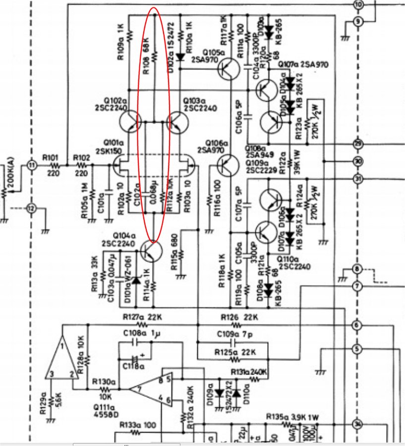

The CM ref cascode divider for the input stage has been around at least since the '80s. Damir's buffering of it is a nice improvement. Both improve common-mode rejection unlike the ground-ref cascodes more commonly used particularly by North American designers.

That is not my invention, it was used before by others, and Bob Corell suggested it and I used it in my TT amp. GK used it here http://www.diyaudio.com/forums/soli...-vas-current-limit-blameless.html#post1817405 but I did not know that until recently.

I did have this as an option for the "badger" , but no one used it.
It was the "crude form" ... Cascode referenced from LTP CCS to
rail with a resister divider.The Luxman 120a (below 1) was the reference.
Buffering the "luxman style" reference gives even more of a PSSR gain
and lower THD.
Still , I personally have not built one (with out a ground ref.)
.... so the option (OPT1) below , allows -
a standard ground reference for the zener. Also , one can use the
diode (below 2 DC6) or (OPT 2) - the transistor clamp.
....Cover my Ar$e ... even with my designs. Lots to "play with"
PS - now for some documentation (andrewlebon really wants this IPS).

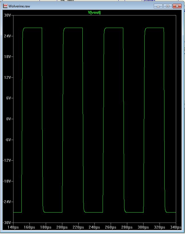

Last scheme continues to do strange square wave plots, notice it's only plotting positive to 0, and if you compare the time it takes to finish the simulation to the 1st wolverine version and this one, you quickly notice something is off...maybe it's some model definition?!

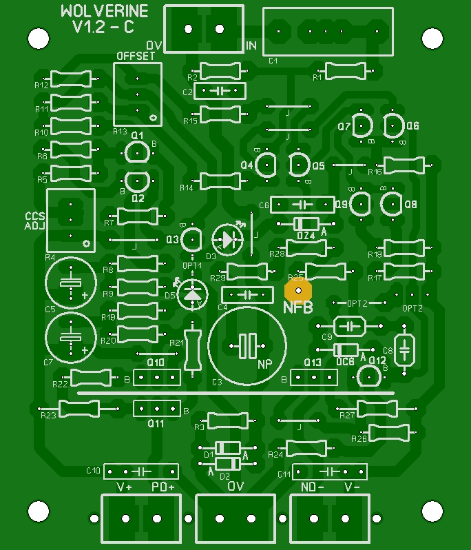

No , it's a hybrid. Sprint (computer) lets me drop pads , but to go from schema
to actual layout - no assist.
I had eagle , but it does not know about Hi-Z/lo-Z or what section is
VAS/cascode/CCS - does auto routing. I like "hands on".
OS
I use eagle, but never use auto routing for analog design.

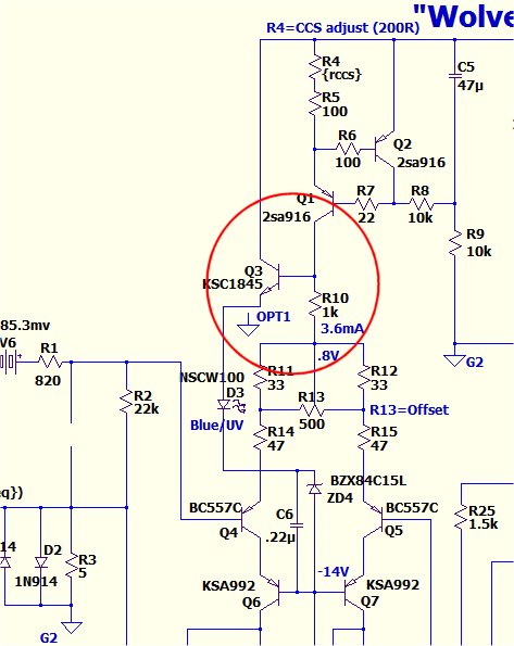

Soon ,Andrew - I am "fine tuning" it.
Since last post , look at the changes (nothing major).
This will look nice (to match the NAD CFA ).
Moved input filter closer to LTP (Q4/5).
On the schema , I will add comments on device selection and explain
the options.
PS - one circuit change ..... referenced Q3 direct from the CCS -
better current regulation at the cascode (+ 1ppm ?). LTP loaded from
R10 (1K) improves sound ??? , and allows easy calculation of CCS current.
Having the blue led in series with the zener offsets the V drop across
R10 - still a -14.5V cascode reference . R10 can be jumpered as well
for a direct LTP-CCS connection (another option).
OS
OS, you might add a ground pad next to the NFB pad, in case someone wants to use coax for the NFB wire.
EDIT: Also, taking the LTP cascode buffer from below the 1k resistor might be a good idea, since the 1k is meant to add resistance to the CCS collector capacitance. It makes sense you would want to apply that to every collector at the CCS point. Otherwise you lose the advantage after bypassing it with another collector junction. Instead of moving the buffer base to the CCS side of the 1k resistor, you could add a resistor in series with the buffer collector, although this would be in parallel with the 1k, so a bit worse.
I haven't got that much experience with ltspice, but in the last weeks I've been simulating a lot of (blameless) amps, and every time I got for instance a cdom too high or too low, sim time increase exponentially showing signs of instability or oscil...
just a tought... [QUOTE/]
It must be some global setting in your LT ... I get a PERFECT SW- below.
As far as stability , I have to get to 2mhz+ UG with C8/9 at 33p/150p to
just begin ringing on the SW.
Same as the badger.... (1.5k) TMC feedback R eliminated actual amp ringing
during SW/ saturation.
...new asc with the SW preset. I you (don't) get the same -it's your LT !!
OS

You mean add a another 1 K to the buffer's collector (feeding the cascode)?
Whats that mean ??so a bit worse
PS - will add the ground pad - Good idea !
OS
Yep, or move its base to the other side of the 1k resistor (better for the CCS, but could be better or worse for the cascode).
Ok, so my original way was better ? (i did that a couple hours ago).
I had (-3) more cascode volts but the current would "swing"/modulate (a tiny bit) more.
I'll show you. (below)
It was almost a "draw" between either side of R10 (1ppm ! ).
OS
I meant the other side of the resistor. In this schematic the resistor gets bypassed by Q3's collector, which ruins the point. The purpose of the resistor is to help with leakage capacitance at the LTP emitters in the first place, so bypassing it is bad.
