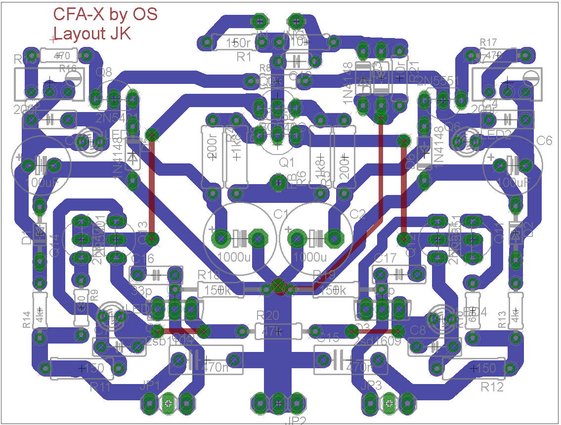

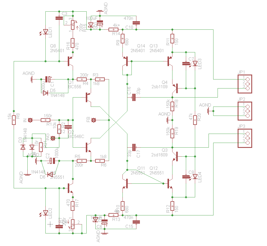

Hello,
When I fried the ips cascode resistors, I connected the IPS as floating without the G2 connection on the OPS board.
I wonder what else has been fried? Most likely the cascode transistors which I do not have anymore. I could throw in BC546/bc556 for the cascodes for testing purposes but cannot install those face to face...
As mentioned somewhere earlier I have made my own pcb.
Help would be appriciated a lot
J

Hello,
J

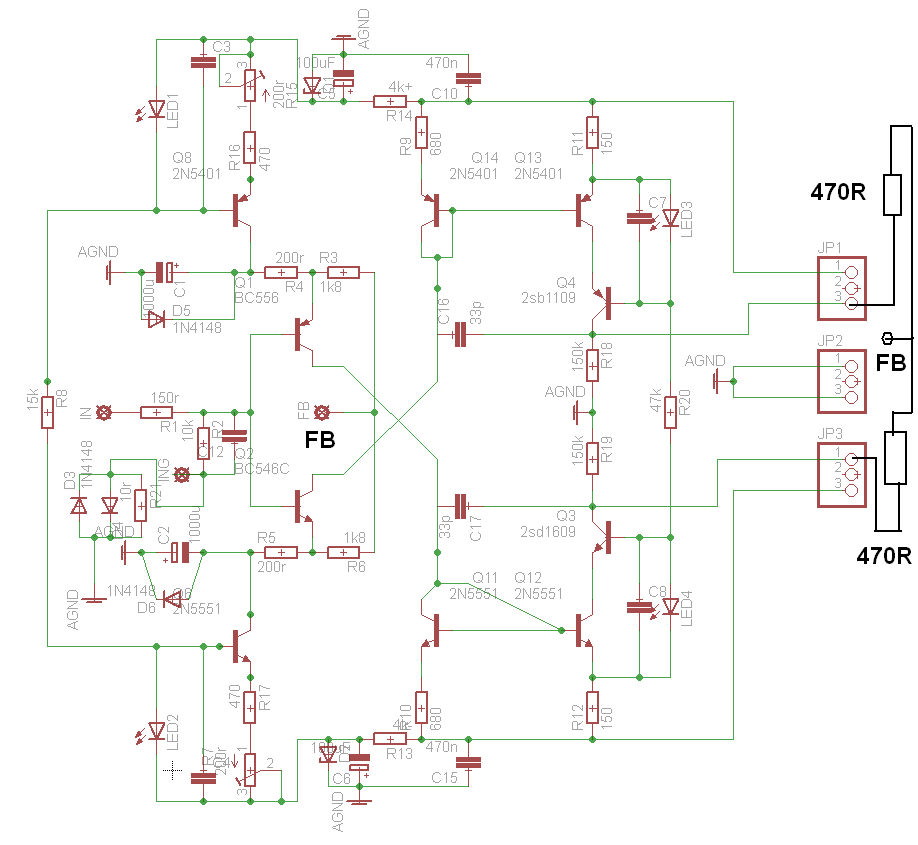

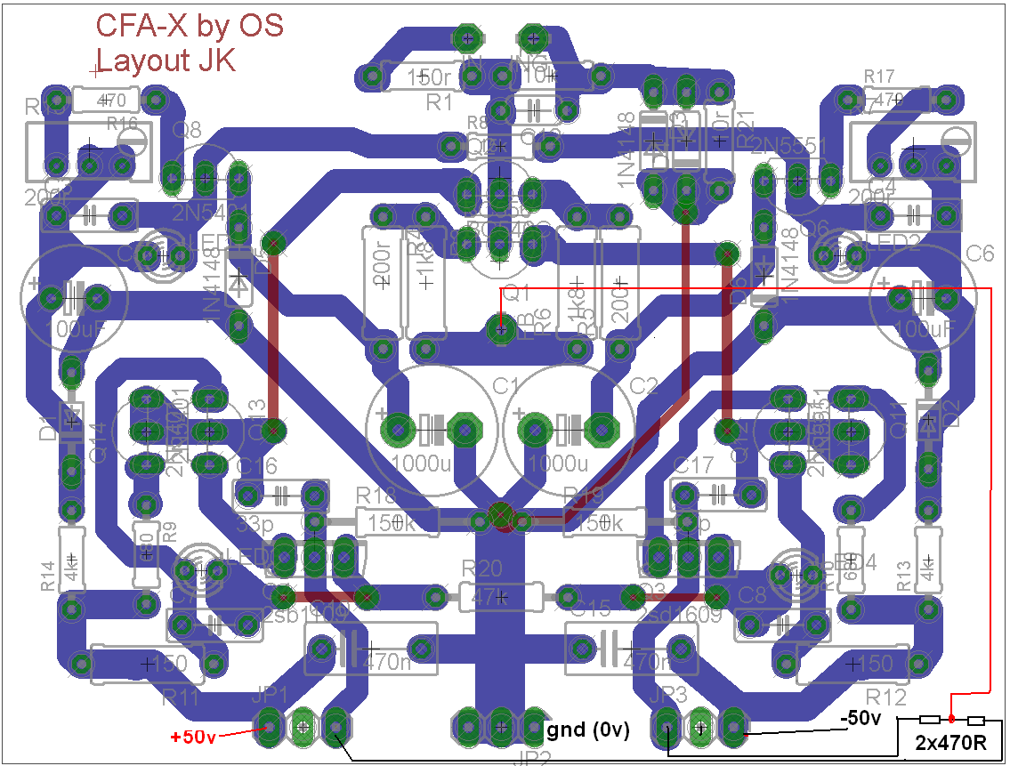

When you hooked it up floating did you tie PD and ND to the NFB with some 470R resistors? Without that it will put out like half the rail on the output
What I meant with floating was that IPS ground was not connected, or better yet It was connected to Cap multiplier base which were also floating.
I tried to simulate the situation in Spice but I could not create condition where those resistors would fry with the installed components.
Also the pcb is fine, no solder bridges or anything.
J
Hi Thimios,
Did the connections... did not help... I am unable to test and measure because of the smoking resistors.
It seems that the q14 and q11 heat up when voltage is applied to the device.
J
May be CCS (Q6 and Q8) current is too high. Please disconnect R9, R10, R11, and R12. Connect collector Q6 and Q8 to ground. Tell me the voltage of R16 and R17.

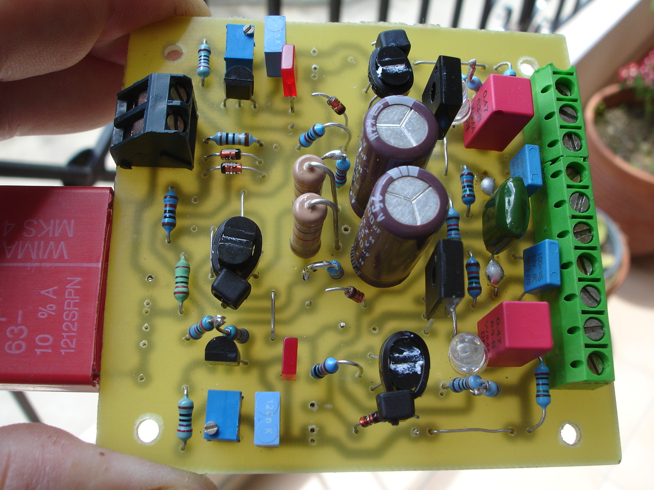

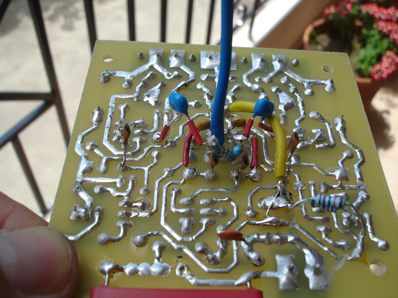

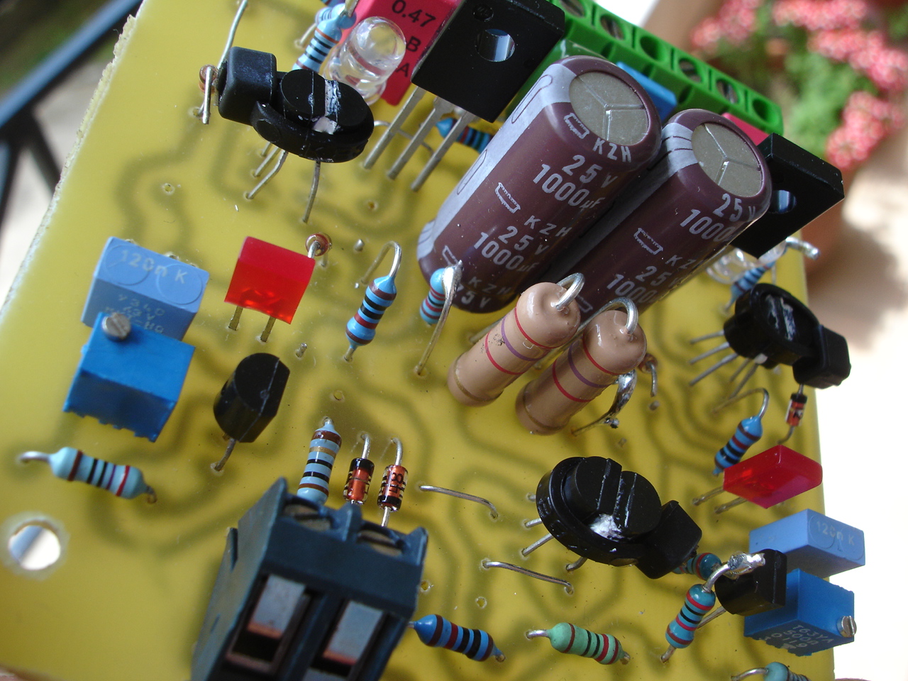

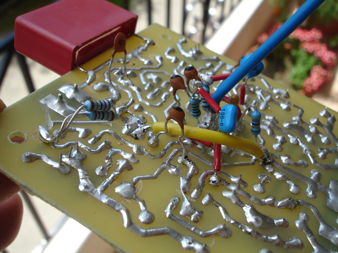

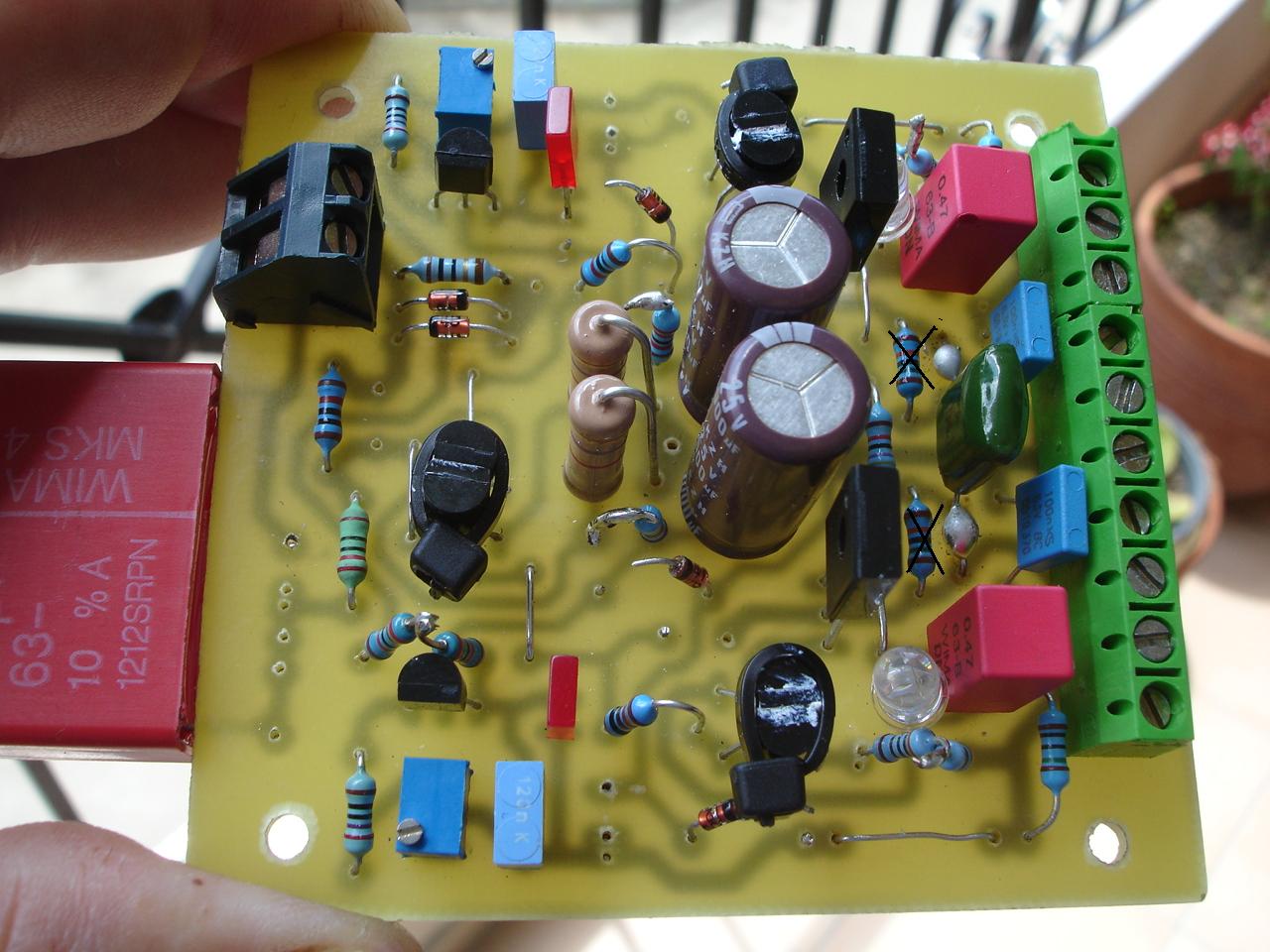

I have just finished the 2nd modification:eek:
All under control,there isn't any issue ,just a little trim for absolutely zero dc out.
Coming soon with measurements.
Thimios.
CFA-X V1.3 2nd mod by BV
Not beautiful but functional.

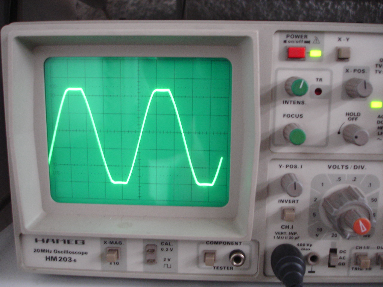

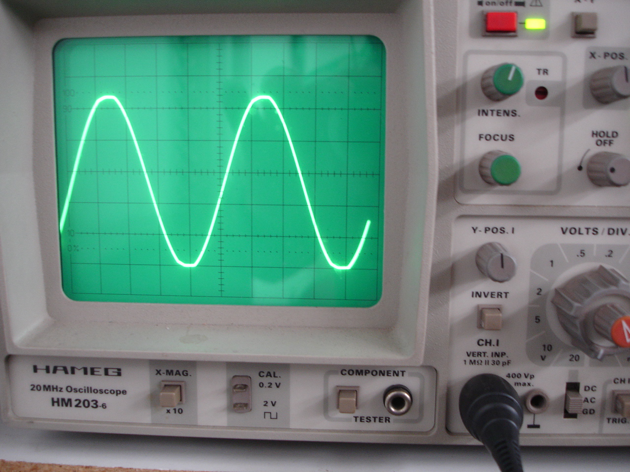

+/-50V.
1st picture,jus clip.31V A.C RMS
2nd >> a little after clip.34V A.C RMS.

As expected
