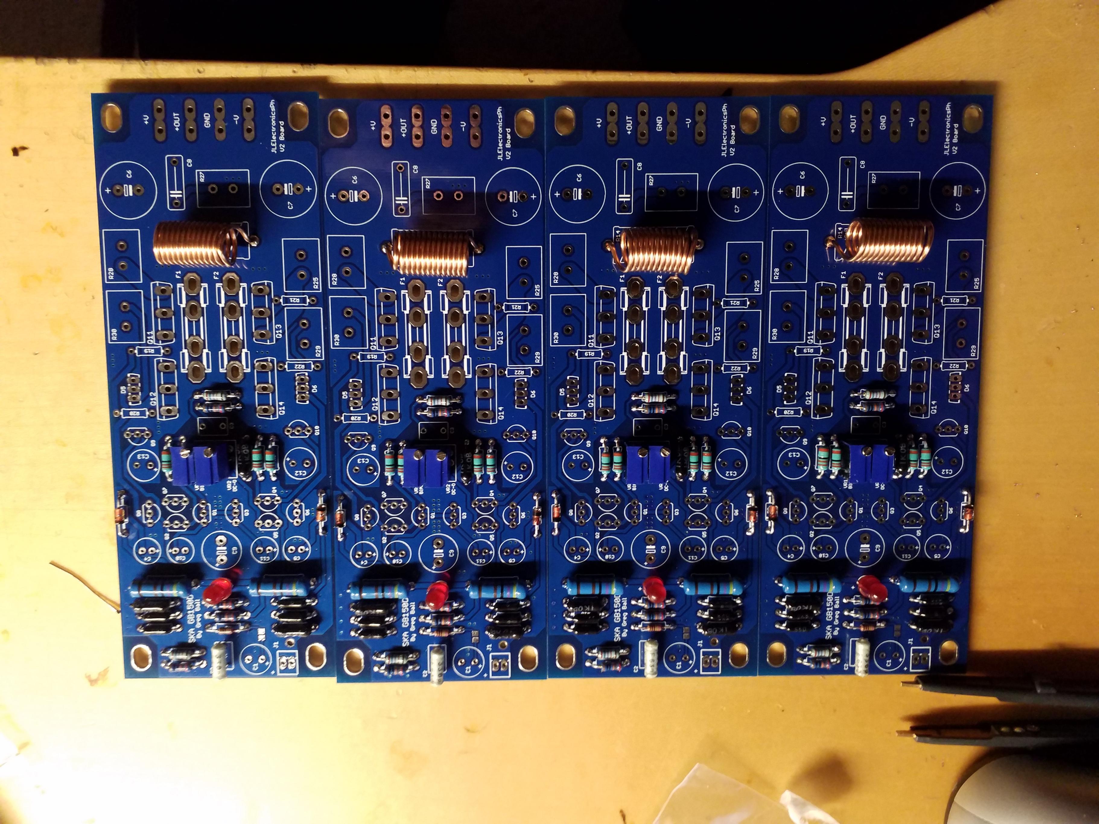

My nice mail man brought these four pcb today, I got a little work done on them, I will post some thoughts and measurements when done, if anyone is interested.

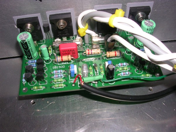

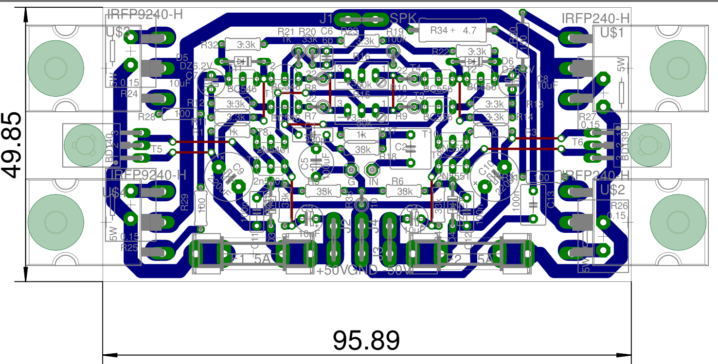

  • top v2.pdf

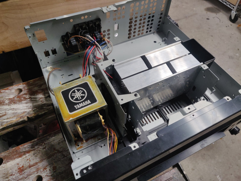

Thread bump! I ordered a set of Jim's boards. I have recently completed a honey badger build, and am ready to tackle the next project. I chose this amp because of the compact layout, and the high power output. I am using large 3 way speakers that like lots of power. The compact layout and relatively high voltage rails capability will let me take advantage of some parts I have laying around from a dead Yamaha home theater receiver. I plan on reusing the case, the heatsinks, and transformer. The heatsinks are compact, and are setup to have a fan pushing air through them, as can be seen in the pic.
Can I use a single power supply with these, and run a total of 40kuf? Was planning on using a standard crc type supply with a bridge rectifier. Rails should be about +-56v.
