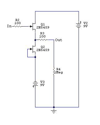

This one can work too. Its not high gm, but it can give decent service. 2N5459 JFET is very cheap and easy to get.
