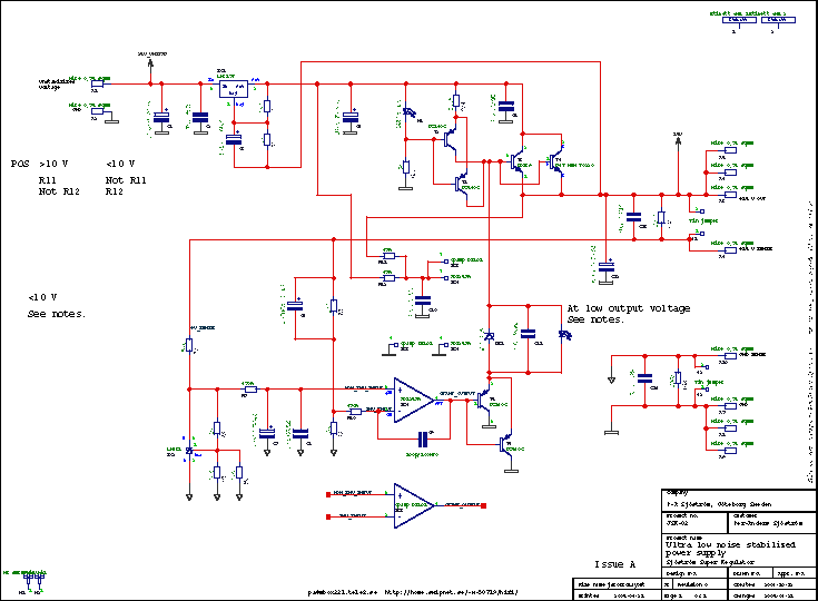

Sjöström Super Regulators
ilimzn said:
Direct paralelling of BJTs and OP-amps? I'm not convinced, sorry.
This is an option for two types of parts, SO08 or DIL08 opamps and TO126 or TO220 transistors. I normally try to have more than one alternative especially when it comes to essential parts like semiconductors.... so only one type at the time :)
More to read about the super regulator
http://www.diyaudio.com/forums/showthread.php?s=&threadid=20937
It's quite right that I have got inspiration from Didden/Jung.
one PCB for four different packaging options opens up the marketability of the product.
