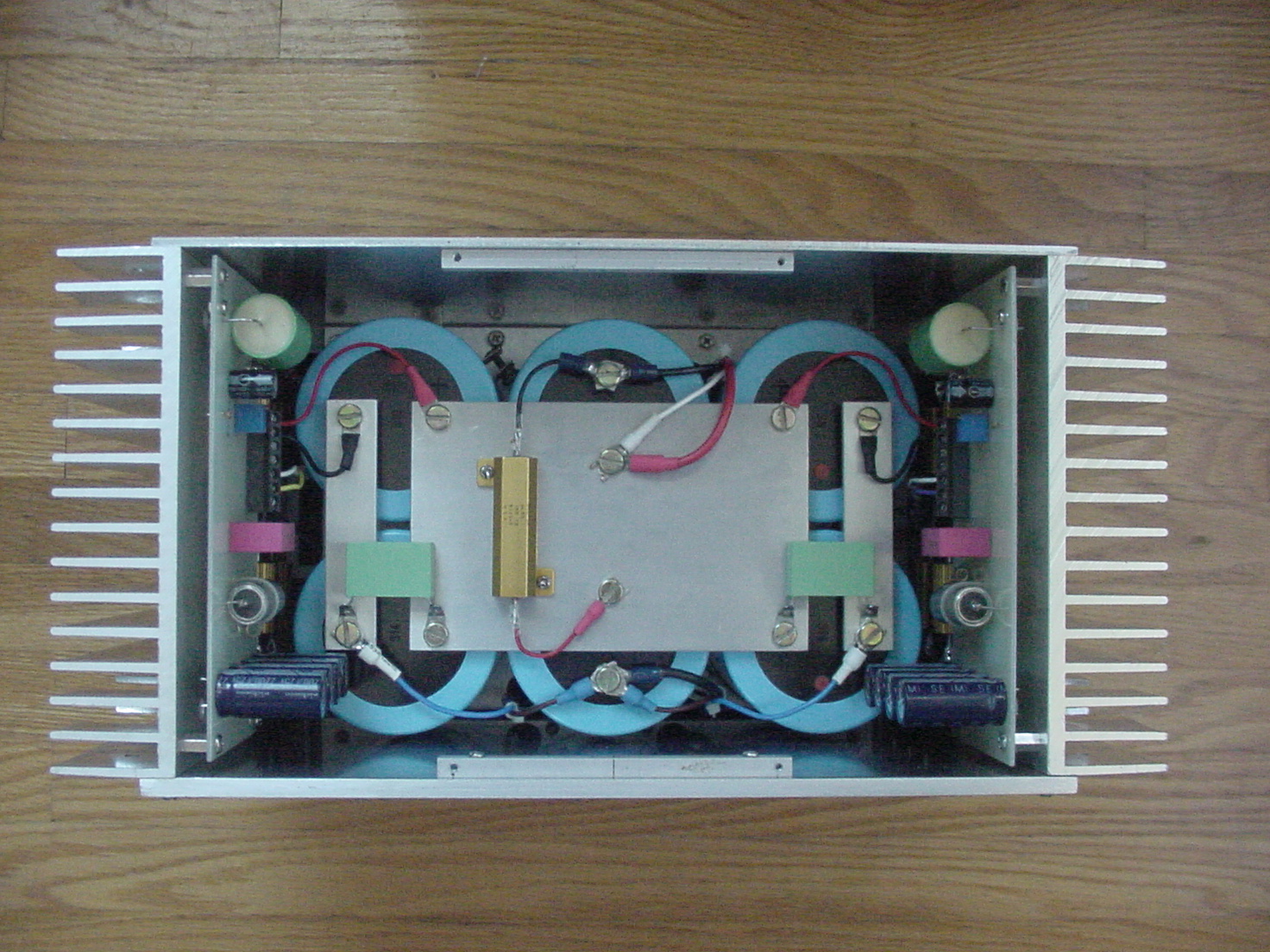

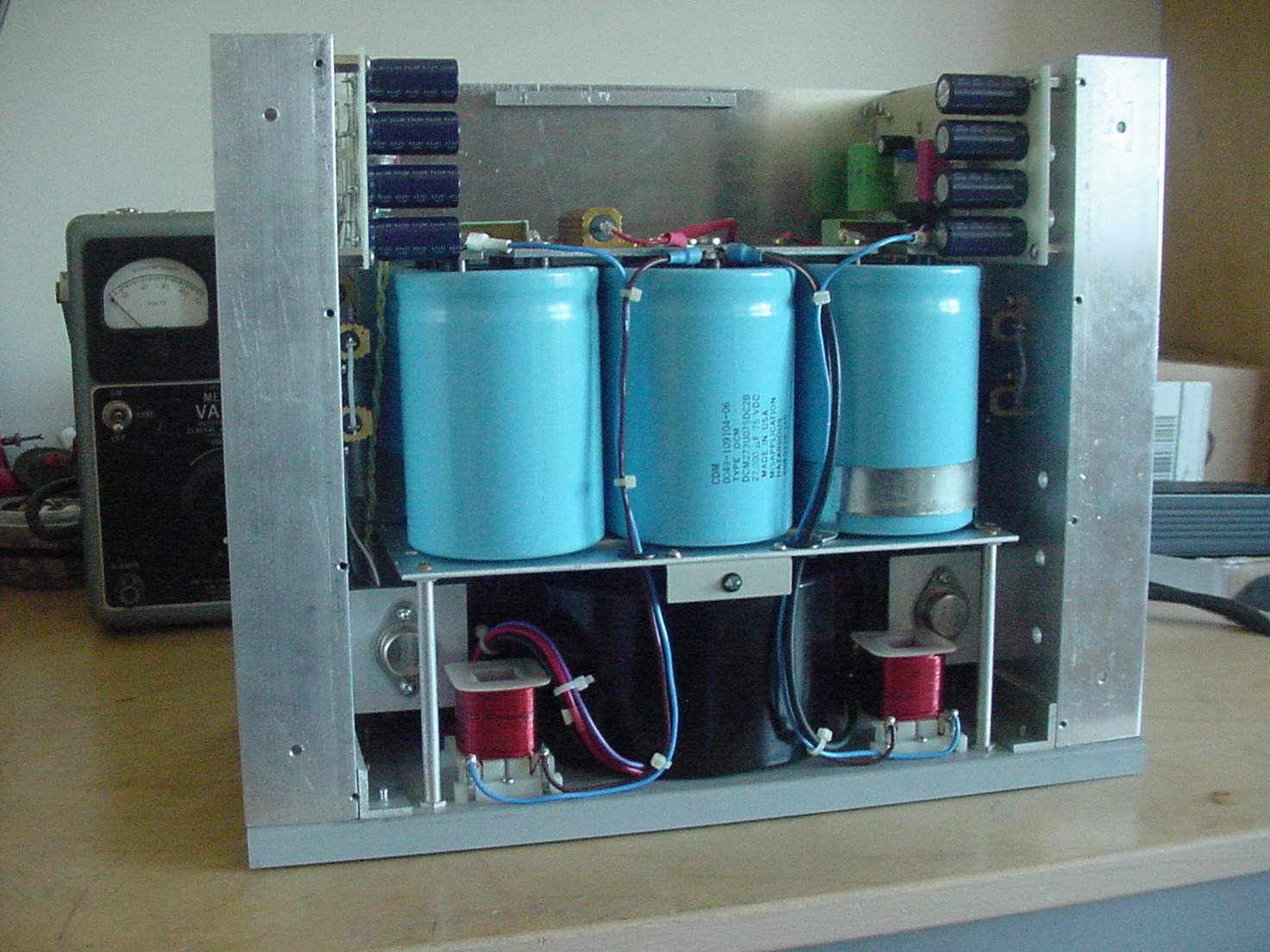

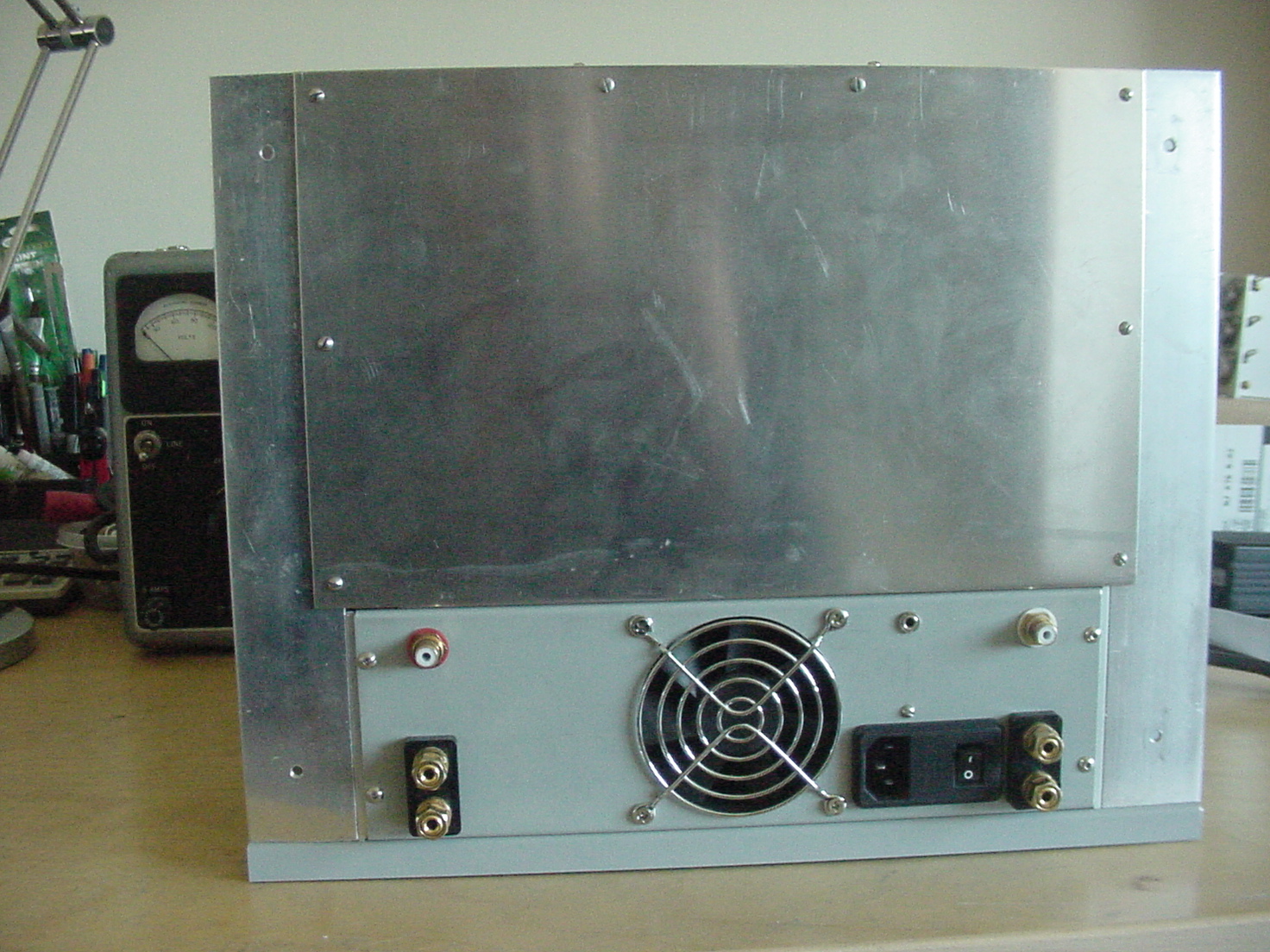

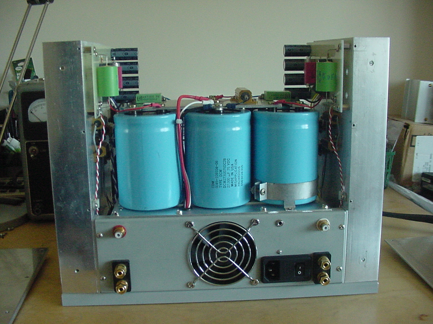

Attached pics. are of the latest incarnation of my 2SK82 power follower design. I have come to the conclusion that the design benefits from a higher B+ and corresponding higher dissipation - approx. 100w per channel. Rather than stick everything in a 5U case I decided to design a more compact fan-cooled chassis. The 12v computer power supply fan is powered from an external wall-wart supply, relay switched from the amp.
Because of my chosen configuration I had to use a cased transformer to direct the airstream to either side where it comes into contact with the SITs. Part of the flow then exits via 'bleed' holes in the heatsink and the rest of the airflow hugs the inside of the heatsink to exit via the slots at the top.
As far as I can measure I have been able to achieve 0.2deg.C/W and the heatsinks are comfortably warm dissipating the combined 200w. The 1/4 inch front and 1/8 inch thick rear faceplates also contribute to the heat dissipation surface area.
I am now a convert to fan-cooling and its benefits in allowing the design of more compact enclosures when there is a need to dissipate serious amounts of class A heat.

Soundhappy - Refer to the thread ' SIT Variations ' for the original schematic. The current design is just a higher voltage version with corresponding higher dissipation. The theoretical output of the design is about 10 watts but realistically, usable output is 5 to 7 watts and that is going downhill with a strong tailwind !
As to sound quality - Few of my DIY attempts make it pass the bread-board stage. Fewer still possess sonic qualities meriting further refinement. That this source follower design is in its 'mark 2' version says something of my regard for its sonic qualities. I am however, not ready to give up on tubes and I am just about to embark on building what I consider to be the ultimate expression of single-ended amplifier design and that is tube based.

I assume that the cooling for the heat sink is supplied from the chassis below. More efficient cooling could be had by covering up the fins so that the air flow is directed along the entire length of the heat sink before escaping at the top. This way, it may be possible to get by with a lower airflow (read quieter) fan. It's not as pretty/cool looking but thermally efficient. A simple expedient for reducing fan speed would be to feed the fan from the wall wart using an RC filter.
Of course if you're getting sufficient cooling with the present setup, you can ignore this, unless you want to exploit this concept for a smaller heat sink or quieter fan.
Excellent suggestions. Early on , I did cover the fins as you suggested (notice the vestigial tapped holes ) but did not notice any significant difference within the limits of my measuring capabilities - I probably needed more bleed air.I assume that the cooling for the heat sink is supplied from the chassis below. More efficient cooling could be had by covering up the fins so that the air flow is directed along the entire length of the heat sink before escaping at the top. This way, it may be possible to get by with a lower airflow (read quieter) fan. It's not as pretty/cool looking but thermally efficient. A simple expedient for reducing fan speed would be to feed the fan from the wall wart using an RC filter.
I vary the fan speed using wall warts of differing output voltages and I am currently using 9 volts although I can get by on 6 volts.
An unanticipated benefit of the current design ( as opposed to the traditional forced-air tunnel heatsink) is that in the event of fan failure, the side-moumted heatsinks retain their function as passive units and although they do get very hot I guesstimate that the devices should be able to survive a listening session or at least until such time as the fan failure is noticed.
Anyway thanks for your input.
It might be interesting to try using a centrifugal blower to pressurize the case rather than the usual axial blower. They can move air against higher back pressure better than an axial blower. I have a few DC centrifugal blowers from various surplus sources that I intend to try on an appropriate project.
