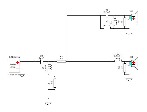

I am talking about a series vs parallel crossover network!
The network the SIT 1 sees starts with a typical second order high pass this will go to the 2441 and then to the T500 and then to ground. You use caps and inductors in parallel with the drivers to effect the frequency range of each - see Series vs. Parallel Crossover Networks Not the greatest article on this but the only one I can find quickly.
Very interesting how they interact. Will probably have to use some kind of resistor at the input of the amp to get the level down.

why don't you post exact schematic ...... i have a slight feeling that you have values OK , while understanding of circuit is not so OK

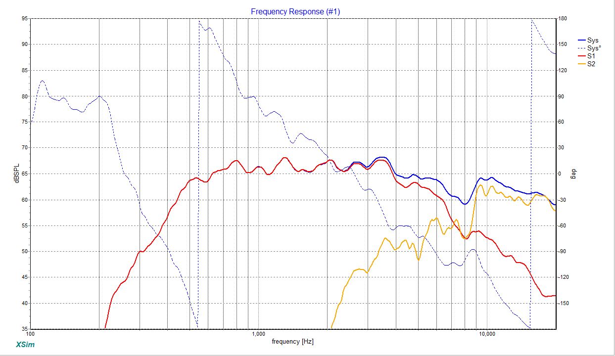

some pictures.
Xsim by Bill Waslo is what I used.
If I place the FOSTEX input after the series resistor I get a higher impedance and a droopy response.
I will try both.
But this is where I am.
My frequency response is at my listening chair. Probably not how it is usually done but I figure I should include the room. If you would like to see the measurement files I will post them.
I should have included a REW room response with crossover but I forgot to bring it with me. Will post one tomorrow.

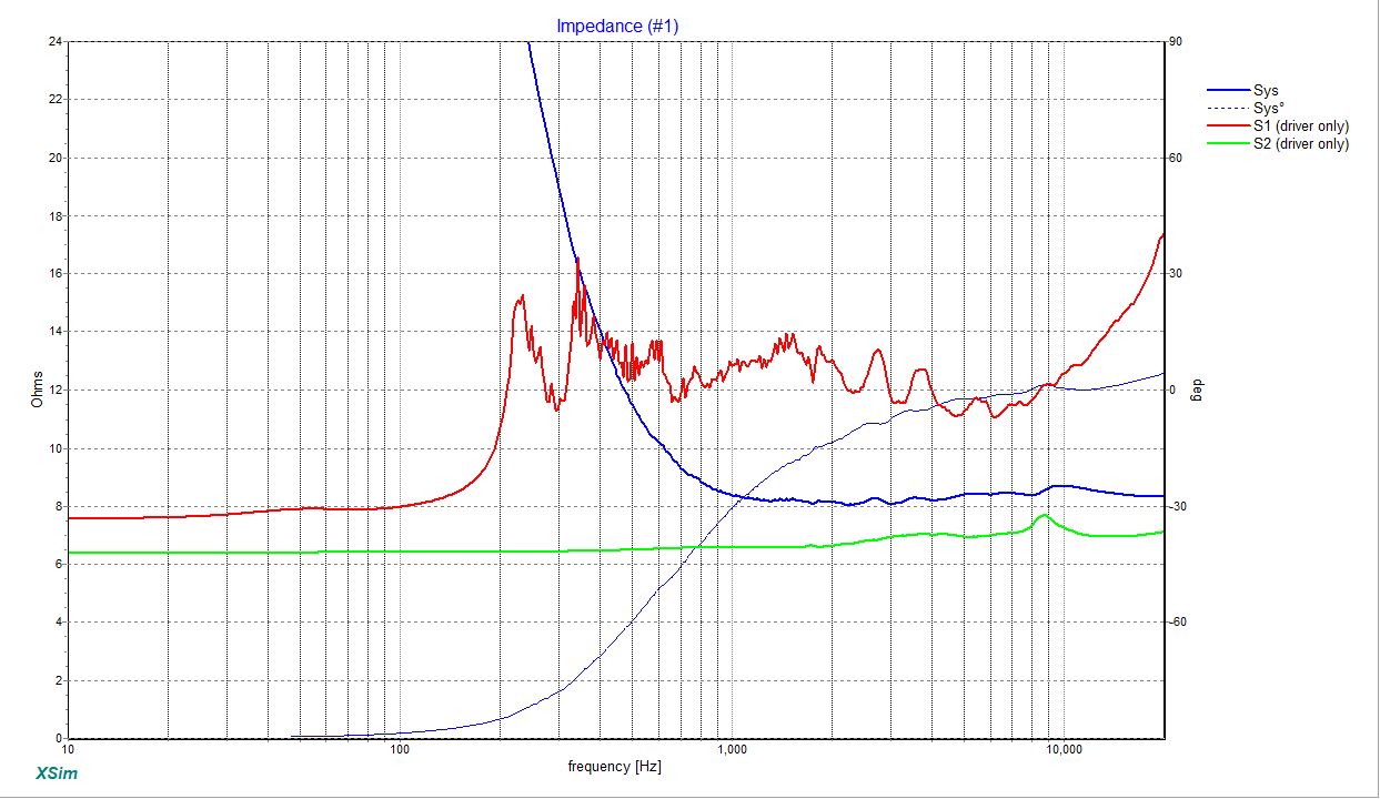

I will try both.
I know.
I reconfigured with series resistors to get the impedance up!
Just thought I would show you what I was doing since you asked.

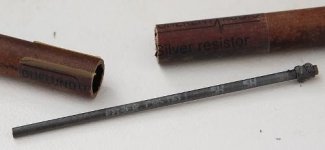

I do not know if the pencil-lead is a joke?
However it makes some sense. Classic pencil "lead" is powdered carbon and clay. Classic "Carbon Composition" resistors were powdered carbon and clay. Carbon/clay mix gives different hardness (pencil) or resistance (resistors). I did not know the two products overlapped in recipe, but considering the *large* range of CC resistors (10r to 10Meg all the same shape/size) they must.
Carbon Comp resistors have a bad rap in audio. They tend to be hissy (even crackly) and drifty. This is because they are not "solid" but rather millions of carbon-carbon touch-contact points. A low-pressure contact is an untrustworthy contact. But the issue arises mainly for higher values in very low level circuits (preamps, not speakers). And also I believe because of the very-very-very low price the CC resistors commanded. Even Allen Bradly, who had good process, could not up-price the CC parts much because that might hurt sales of their premium wire and film resistors.
Good pencils command good price. Their buyers get very intimate with their "leads". I can believe Faber Castell makes a smoother tighter "lead" than the guts of old CC resistors.
The guy who wrote Walden, his family business was pencils. In the period after the "good graphite" from England ran out. The Thoreau family was among the pioneers of grinding *coal* down to super fine powder, and also worked on clay-mills, to get the perfect pencil point. In another project, Bell Tel used powdered coal in carbon microphones but after mass research decided that the best stuff came from ONE drift in one mine in Pennsylvania. So they bought the farm (leased exclusive rights to that branch of the mine to supply the needs of the whole Bell System).
Dry-cell batteries (even dead) can be busted open (carefully! wash-up after!!) to yield a carbon rod of good consistency. However the electrical resistance is very low, since it is a Power device. I dunno if you can get even a few Ohms from a pack of cells.
Mechanical pencils these days are not clay (too brittle in thin diameter) but carbon and a polymer. I recall trying to get an Ohms number and not getting consistent results.

You know DUELUNDs silver resistor are with Faber Castell pencil lead inside.
100 % verified by Diy folks
I wonder what the "silver" stands for...
