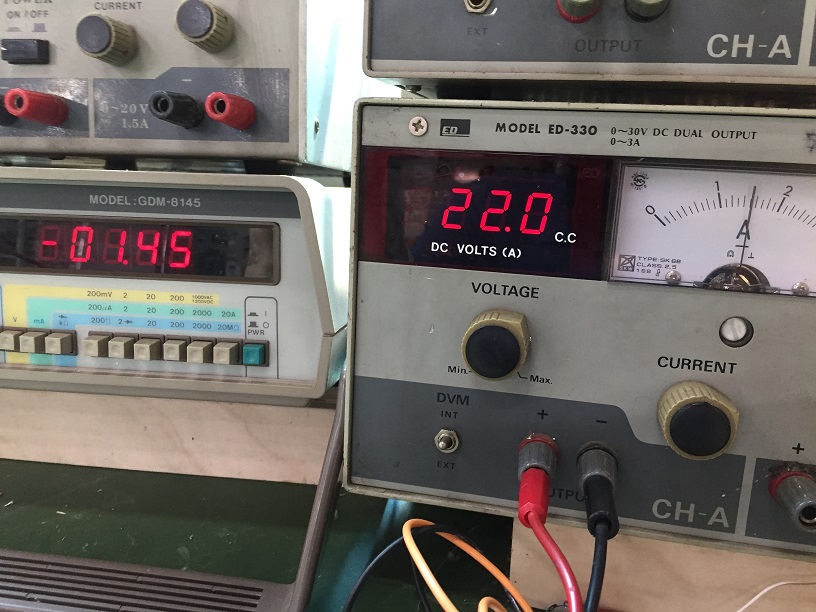

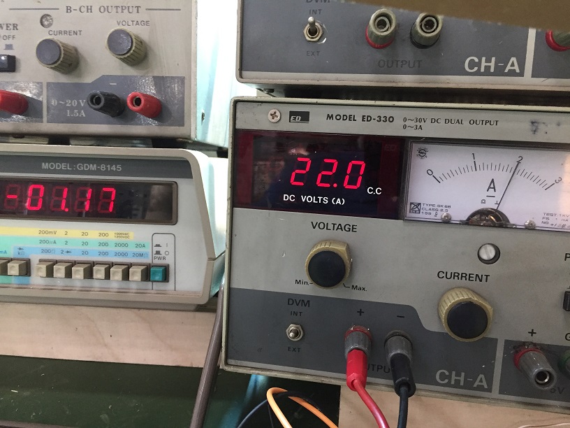

I checked two 2SK182 @ 22V 2A and they showed Vds around -1.1V.
I used a battery for Vgs. There was something funny when using linear power for previous tests.
From left in the picutres, Vgs Vds and Iq (analogue meter) are shown.

if that's the case , 2SK182 , at least some of them ..... are applicable in SissySIT circuit
though , still best to have them , test them , then everything is crystal clear
regarding final result - THD spectra and all ........ it must be sort of similar to THF 51-S ... but how much similar , I can't tell without actually having them
