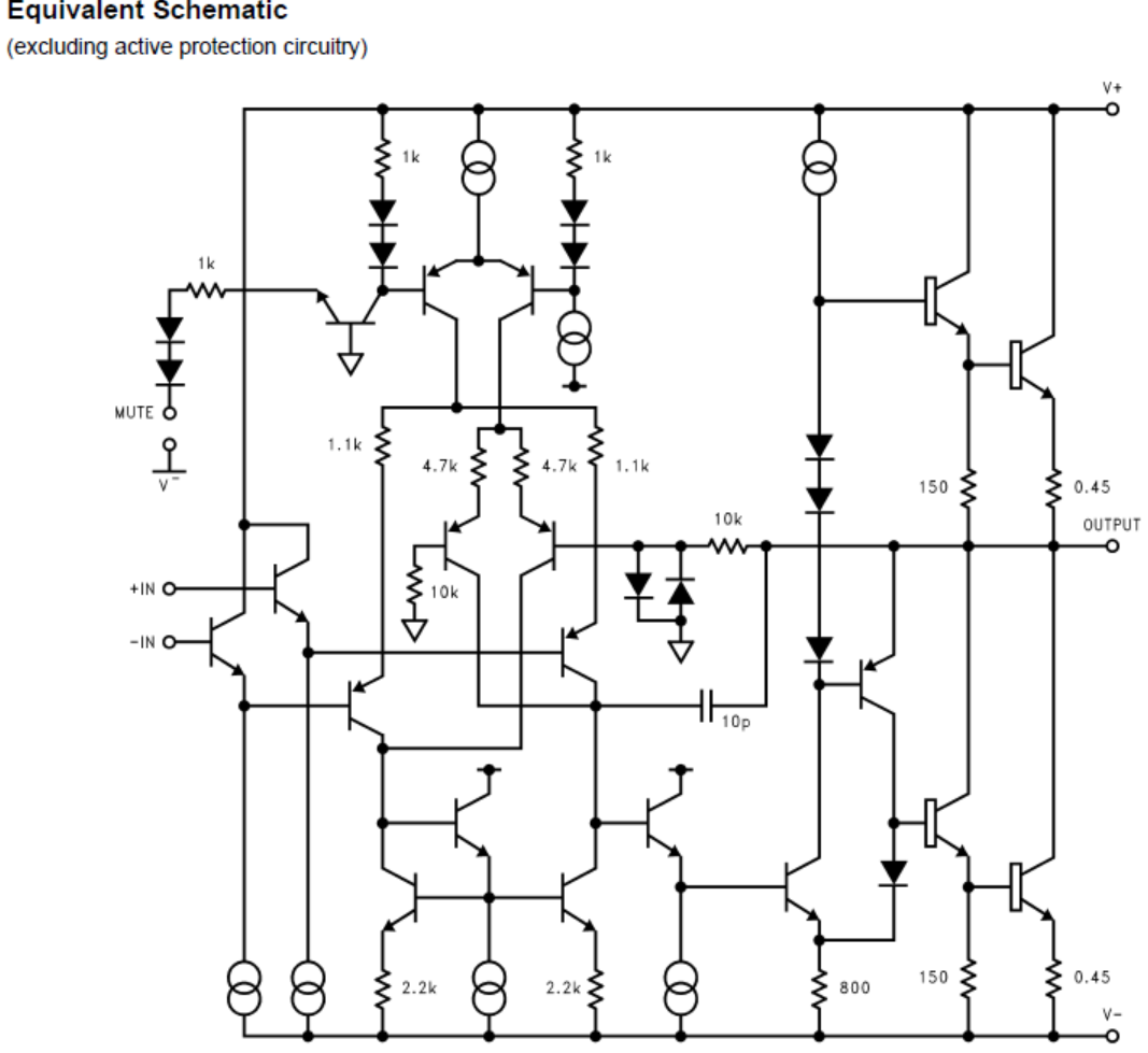

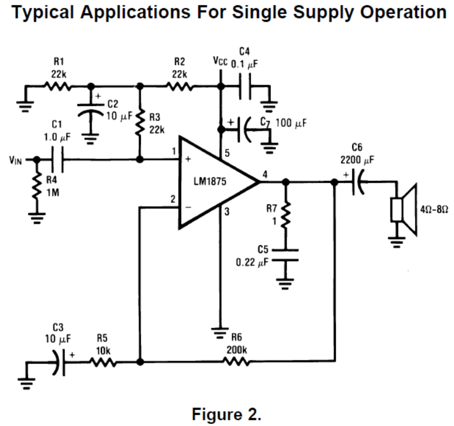

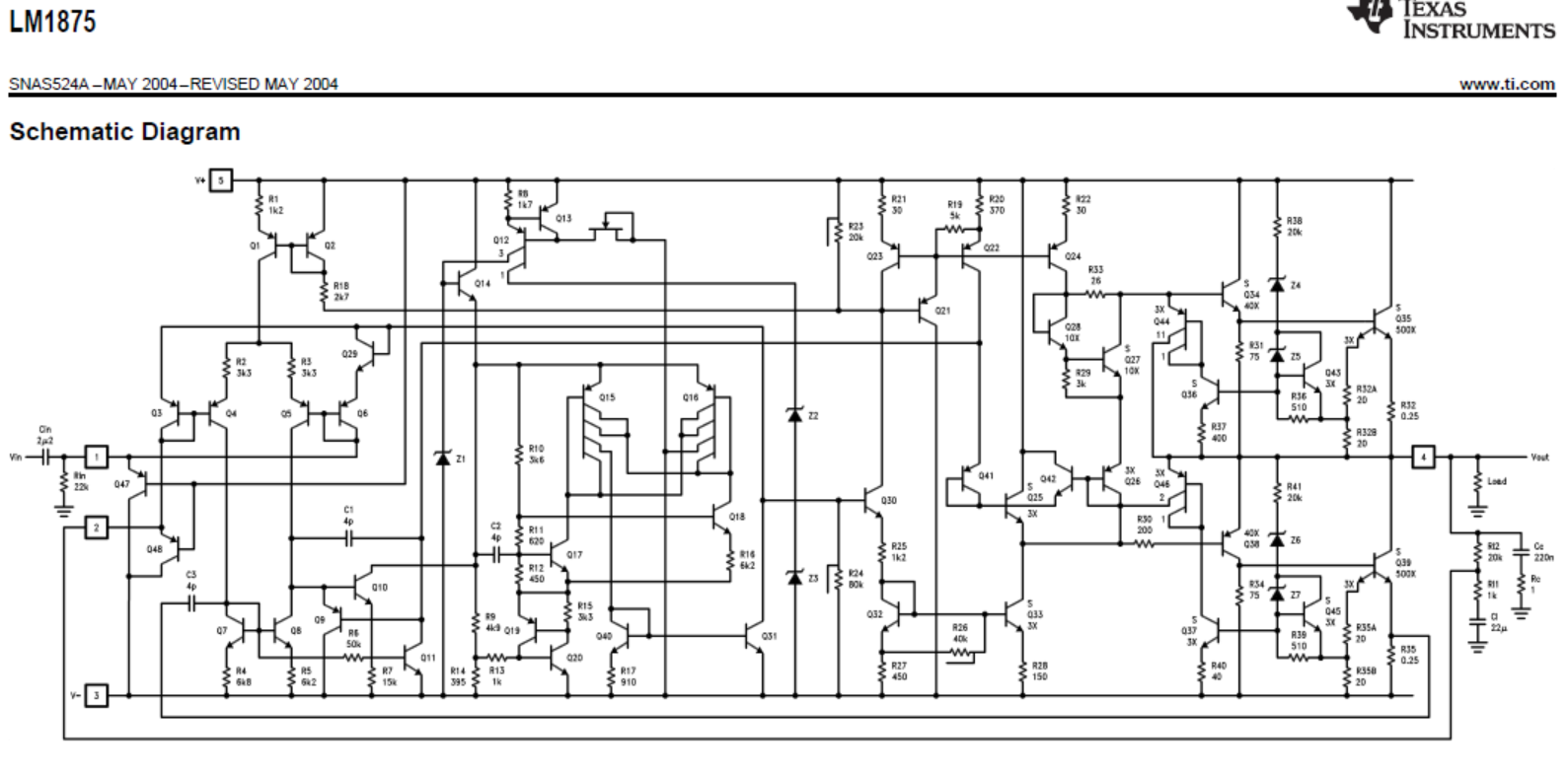

From another thread, lm1875:

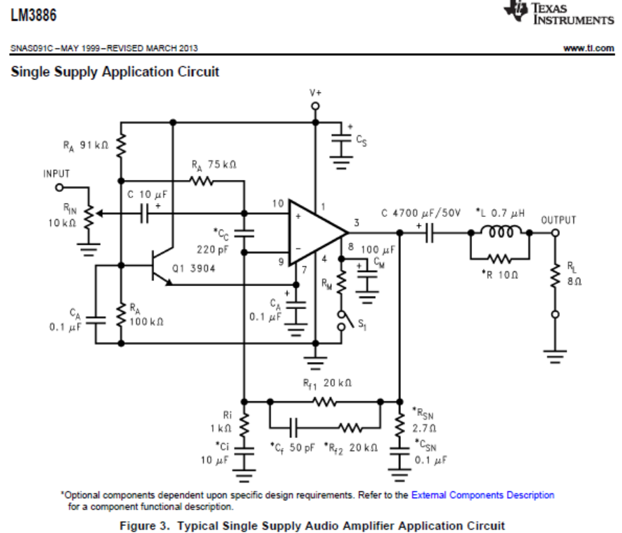

and lm3886
1JPG=1000ASCII

Tomchr, it is indeed single supply. Is there a way to avoid the thump caused by the o/p cap charging through the speaker or is this just an unavoidable drawback of single supply designs? The reason I was looking at the single supply version was the DC fault protection given by the cap but if its going to throw VCC/2 through the speaker every time I turn it on it hardly seems worth it anymore.
The 47k resistor to ground you suggested - is this what R4 (1Meg to ground at input) is for on the datasheet schematic?

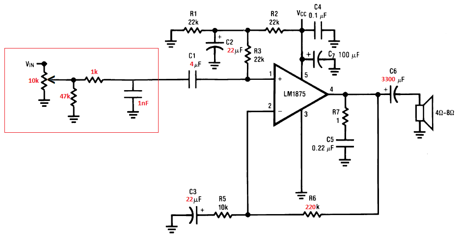

My circuit is shown on attached, with changes from datasheet circuit in red.
Does the 10k pot negate the need for the 47k resistor as the input is no longer floating?
The rf filter as shown has a frequency of about 159kHz - seems lower than i've seen elsewhere. Is this too low?
Any other issues with the attached circuit?

Any issues with putting the input cap last? 47k to gnd --> rf filter --> Input cap? No space on the current layout to put the rf filter after the series cap.
.......no (if the input filter is not too far away from the opamp)
............yes
...........not too low with 1k/1nF, some designs use lower frequencies.
but your 10k pot has a (maximum) output impedance of 2,5k in the mid position,
so you get only ~50kHz (1k+2,5k)...........that's low.
The only way to avoid it is to use an output mute circuit, which mutes the output until the cap is charged.
The thump is a drawback of the single supply design.
I agree. In addition, large electrolytic caps tend to add audible distortion.
Yep. R4 in Figure 2 of the data sheet.
............yes
Well... No. When pots fail, the wiper usually opens. Even before they fail, they tend to skip, which results in a scratchy sound when the pot is turned. Having the 47 kΩ there will prevent the amp from going haywire when the pot fails.
True. Reducing the 1 nF to 220 pF would bring the cutoff frequency back up in the 150-200 kHz range.
it is good to have a res at the output (paralell to the speaker load) to reduce the turn-on-thump,
something like 330 ohm...........x kOhms.
That'll reduce the thump, but not eliminate it. Lower value resistor in parallel -> more power is dissipated in the "anti-thump" resistor.

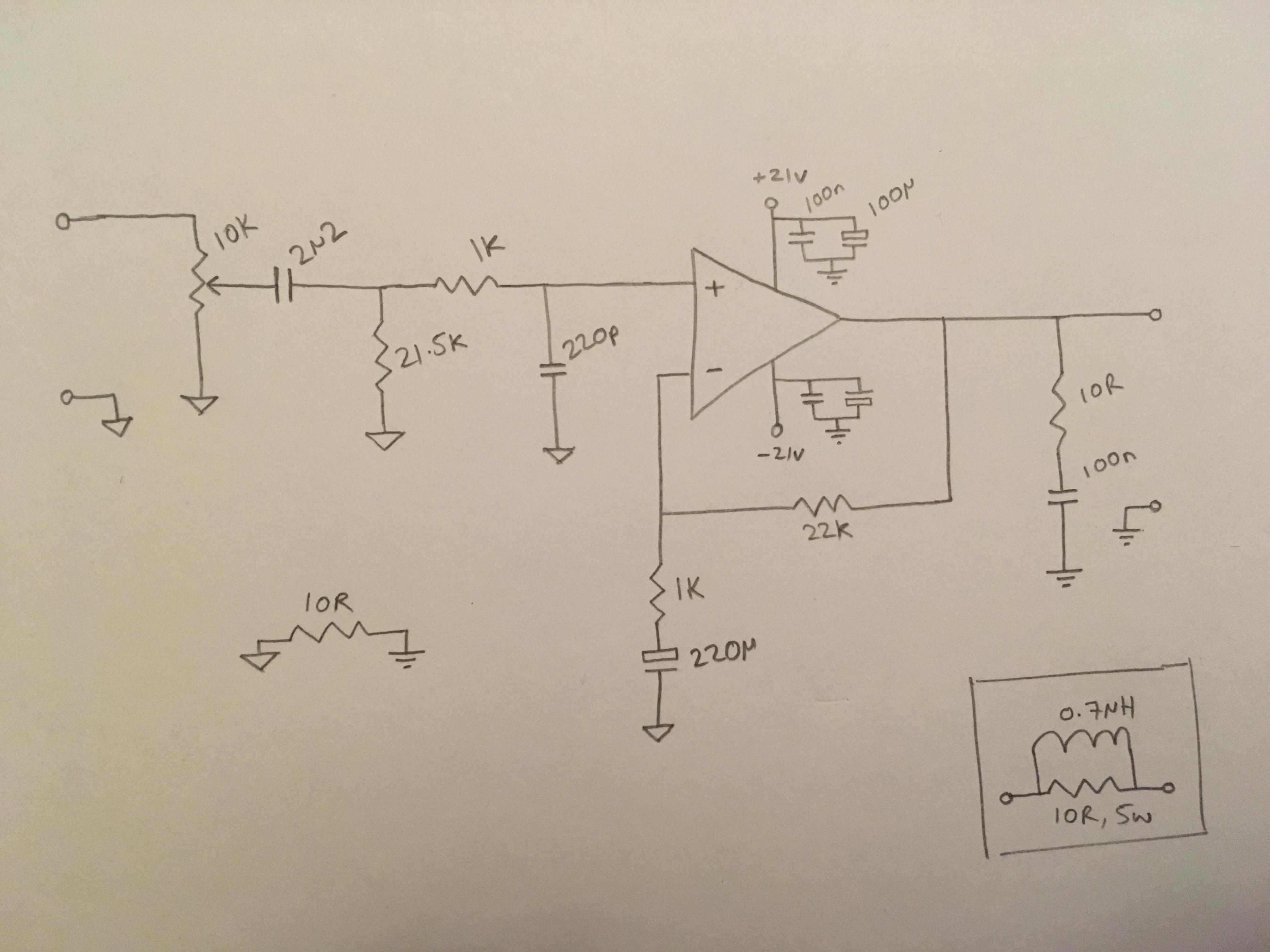

Right then, redesigned as a single supply. I'll live dangerously and leave off any protection for now.
I'd appreciate any comments on the attached design.
Does the o/p impedance of the pot (max 2.5k) still affect the RF filter if it is upstream of the input cap, as shown? - I assume so, in which case I make the Fc of the filter about 185khz, including the 400R o/p impedance of the soundcard it will be used with (is it right to include that?).
Signal gnd and power ground separated by a 10R resistor. Is this good practice? Is a 1/4w resistor sufficient?
Zobel on the lm1875 datasheet is 1R with 220nF, this gives an Fc of 723kHz doesn't it? - seems very high. The 10R, 100nF (as per lm3886 datasheet) shown gives 159kHz.
Thiele network not located on the board but near the speaker binding posts. Values used as per lm3886 datasheet.

...Does the o/p impedance of the pot (max 2.5k) still affect the RF filter if it is upstream of the input cap, as shown?
As you assume. Of course it does. The location of the subsonic block cap makes no difference. Since the source is probably more predictable(??), move the supersonic cut there.
...Zobel on the lm1875 datasheet is 1R with 220nF, this gives an Fc of 723kHz doesn't it? - seems very high. The 10R, 100nF (as per lm3886 datasheet) shown gives 159kHz...
The Zobel complements the speed of the internal power devices. Use the values suggested for the chip you are using, not some other chip.

Hi PRR
My pot will be off the board and connected with wire so I located the RF filter as close to the chip as possible to take care of anything that gets picked up by the wires on the way.
Thanks for the tip about the Zobel - I'd seen others use 10R & 100n with the 1875 in their designs and the lower frequency seemed to make sense. I'll go back to 1R & 220n.
That's a good choice.
I'd use whatever TI uses in their data sheet.
For the decoupling, I'd read the data sheet as well. Keep in mind that lots has happened in the area of ceramic caps since the data sheet was written. Thus, you may find that you can improve the performance of the decoupling network if you up the size of the smallest cap from the 100 nF used by TI. More info is available in my Taming the LM3886 - Supply Decoupling article.
Tom
