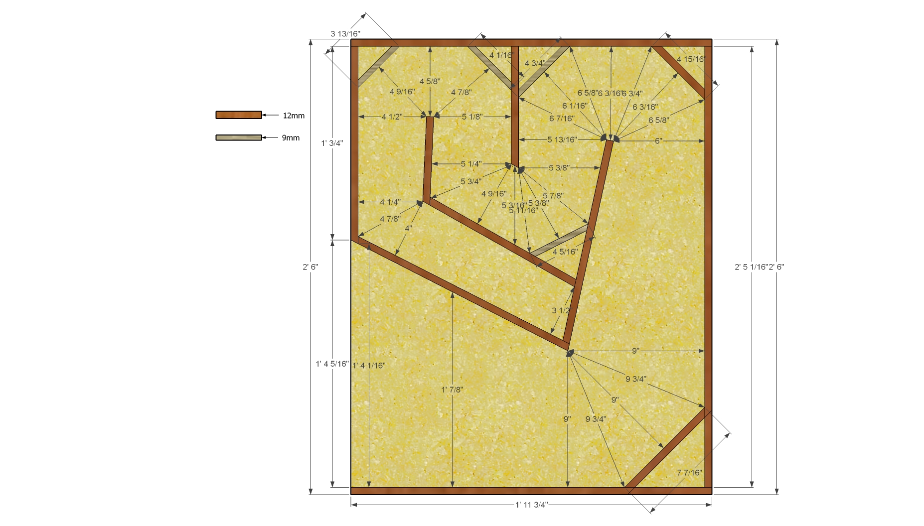

I had to do some adjustments for 12mm vs. 1/2" from the original plans (plus 9mm bracing). As I'm going through, I was just curious if there is any need for some 45* "guides" in the corners to make the measurements a bit smoother, or if I'm just adding weight with no benefits?
Thanx!
