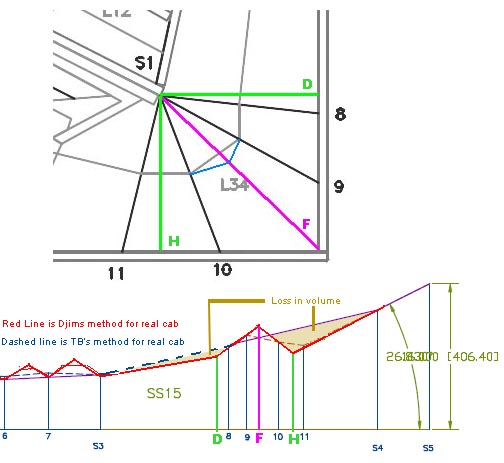

Oliver, that’s the disadvantage of writing in another language I’m afraid. About the ‘new’ reference points I think I need more explanation. It’s not your method I criticize. What I miss is accuracy that can give very important information. Therefore you need an extra 3 reference points for each bend.
1.) 2 of them (one before the corner and one after the corner) start from the corner centre point towards the closest positions of the outlines of the bend. Normally they will hit the outlines of the path with 90 degrees (see the green lines)
2.) The other reference point starts from the centre of the bend towards the corner point. This will give the longest distance from centre to the outlines of the path (see the purple line)
If you add these 3 extra reference points it will produce a much more accurate “horizontal representation” of the real cab. In case of the SS15 it will show that the last bend is way more off the ideal path than other bends.
That is how I came up with the red line in your “horizontal representation” of the SS15 (instead of your dashed line). Look at the area I marked as “problem area”. You will see your dashed line is not showing the whole story. The interesting part is how steep the line is between point 9.5 and 10.5.
See, why you need EXTRA correction between reference point 10 and 11?
If you translate that to the ¼ wavelength horn path this means the area around 90Hz. This is exactly where JBell measures 1dB less and with full power it should be more then 1dB.
I got the inspiration by Xoc1 and his “horizontal representations” over the last couple of months. I told him I was following his posts with special interest so I hope he is reading this this.
The problem with putting all my suggestions in HornResp is that the BL force isn’t a stable value in relation to excursion of the voice coil (remember DJK’s remarks?). So that’s why I want extra volume at the last section of the horn. I get this extra volume by lifting the driverpanel upwards. And when the driver excursion gets around Xmax the BL factor is only 70% and the extra volume will make this up. So all these relative small 1dB corrections will be gaining more dB’s at Xmax and higher.
Oliver, I have made a more accurate version and gave letters to the new reference points and where they end up in the horizontal representation.
It shows how "NON gentle" this bend is in relation to the ideal path. Also it will show clearly significant loss in volume (marked as light brown area).
I hope this will clear things....

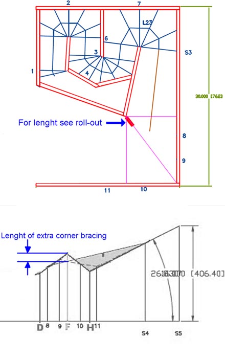

Okay, after you used all corrections and redraw the cab you can make a new roll-out (horizontal representation of the cab).
Instead of using corner bracing I was thinking of using one from the centre point! The idea behind this is that the large soundwaves don't see smaller objects so a small bracing in the centre wont hurt them. The volume it takes is almost nothing but you wont loose the volume from corner bracing on the outside of the path.
But it forces the low speed air molecules (that are using the shortest path) to raise their speed around the centre of the corner. Also it extends the shortest route within the horn. How much it works positive (or negative perhaps?) in the low end of the bandpass, I have no idea...
A few notes:
1.) It only can work in big corners.
2.) The length is set out between the difference between the ideal path (based on the reference point/line that hits the corner) and the extra length in the corner. I made it more clear in the roll-out (hor.repr.)
Any suggestions or comments?
