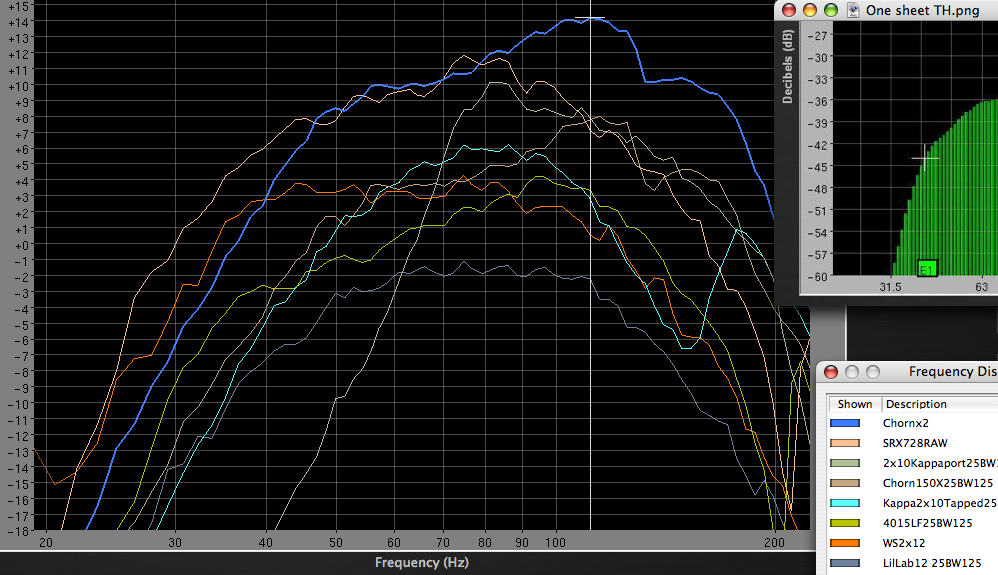

Single sheet TH challenge
I decided to have a go at plotting out the horn dimensions 'as drawn'

In Post #74 I posted the updated version of the singlesheet enclosure, now called SS15. Jbell approved it in Post #78. It is what it is, what is still in question is why should there be a difference in model response and measurement. If you even out the taper by changing dimensions you are creating a new speaker. There is already at least one minor change in Xoc1's very nice drawing, the front baffle should be slightly inset into the box.

FR measurement @10M with 28.3V = nice for confirming peak output, less useful for confirming alignment with a model based on SMALL signal parameters
FR measurement @1M with 2.83V - is this a valid way of measuring the FR of a horn?
What's missing here is the impedance response. It's easy to measure (with a WT3 or something similar), it's more accurate, and it will indicate clearly not only if there's alignment with the model, but if there are other issues that may be contributing to misalignment (e.g. panel flex).

All I have seen is jbell's 28v@10/m Smaart plot, with a 180Hz LP xover. It follows the HR graph as well as I would expect with a large signal being used. Harmonics 1, 3, 5, and 7 are were they should be, with 5 and 7 being rolled off by the xover. 7 more then 5.
I remember some questioning of the 40-50Hz area rolloff, but this is nothing more than an issue of comparing a small signal sim to a large signal reality. You are seeing an decrease in rolloff due to the greater pressures in the horn that are loading it better down low.

When you said this awhile back, I blew it off as crazy talk... but now you've got me second guessing. Hornresp says it should be a 24db/oct fall from 60hz on down. This clearly shows it is about a 12db/oct drop from 60-40hz, and then a 24db/oct drop from there.

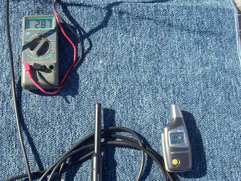

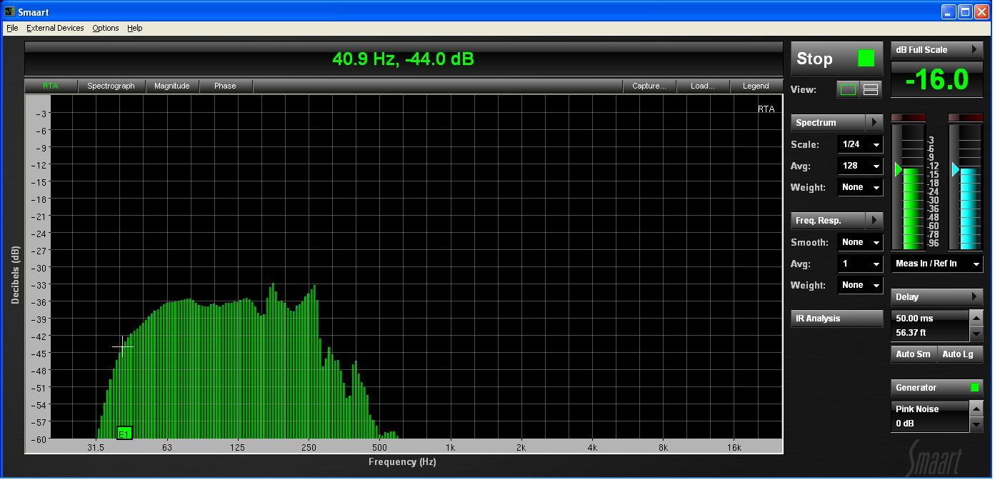

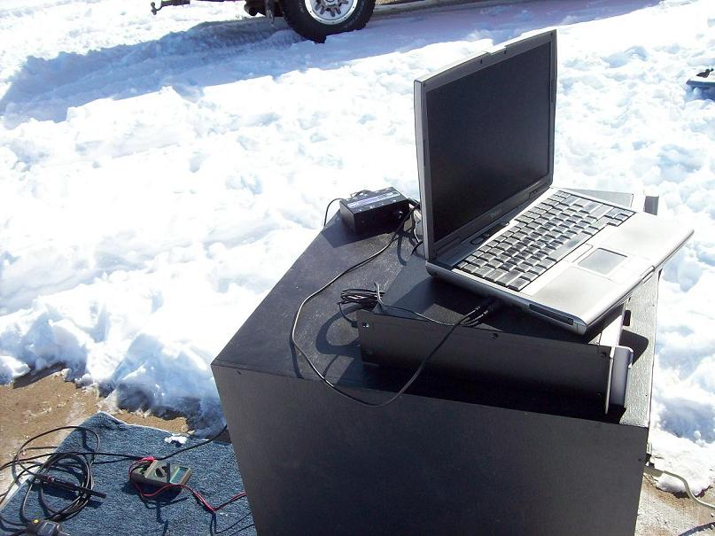

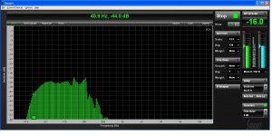

Ok... since there has been much talk spent on 28v vs 2.83v measurements.... And I'm a fan of 'There is no substitute for doing...' I went and did something a bit crazy today.
The crown was set for 40-300hz. (and yes, even a butterworth 48db/oct at 40hz cuts a couple db at the high pass freq.)
The pictures speak for themselves.

Hmm... does that meter read true RMS?

Not sure what the pictures are saying, other than the 3 dB down point with the 40Hz filter is now about 55 Hz, and the 10dB down point 40 Hz.
Using magnitude response at 32K FFT would show the narrow peaks and valleys that can hide in the grass with the RTA, and allow easy comparisons on one screen.

What distance is this test from the nearest walls?
nope... so you want to take that reading and multiply by .707?
That'll make the numbers look even better....
That was at the end of my sidewalk... about 20' from the house, nothing in front for about a half mile. You can see the toyota off to one side, that's about it.
The pic a few posts back (#331) was 28v10m, I don't see much difference to what I did today.
excuse the 'non-scientific' measurement that was obviously rushed.... it was cold, and snowy, but at least no wind.
