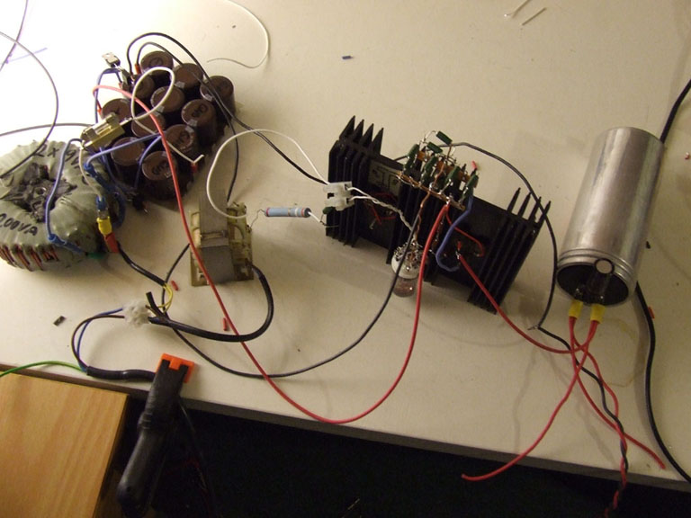

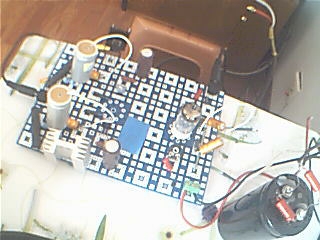

Well, took a little more than an hour, but its up and running. Listening to Turbonegro at severely loud level! It sounds great I cant find the ECC86 so had to use 6922. Running it at anode voltage of 18volts Hilarious, but it works. With an ecc86 this can be promising.

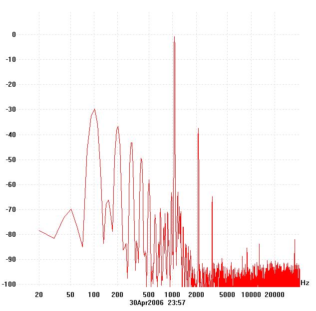

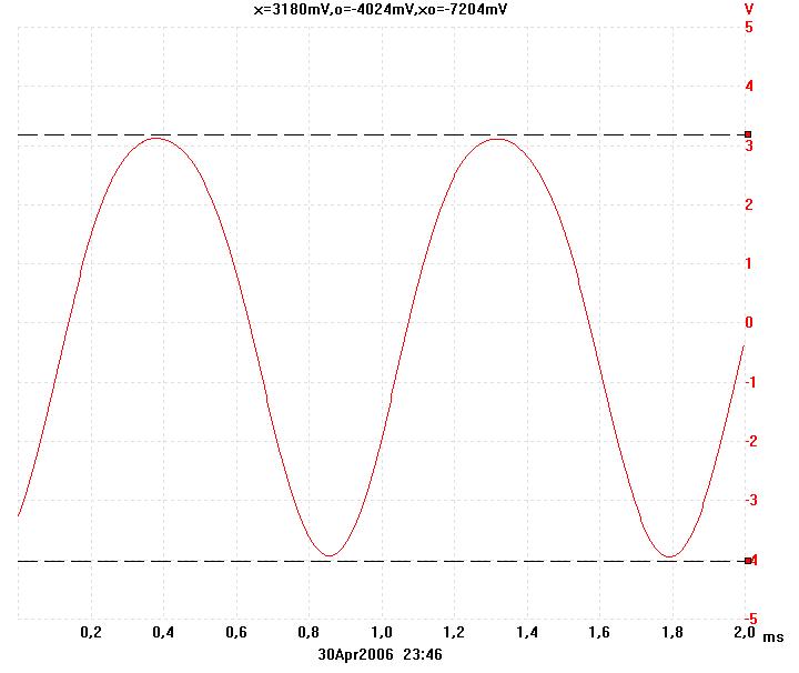

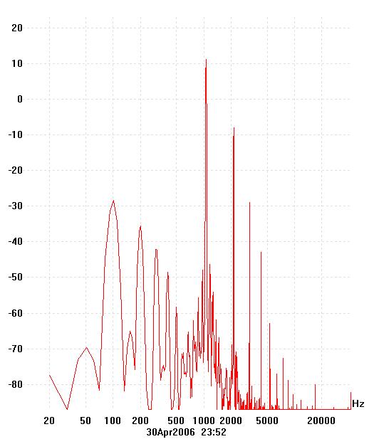

It is extremely 2nd harmonic, but the higher orders are less than 40dB, not bad considering the low voltage and simple circuit.
Ps. at this low voltage the 6922 draws grid current so it must be AC coupled.

Yes the psu hum is audible in this hastily built amp. See the fft picture and you clearly see the psu harmonics. The PSU has to handle the constant current draw of this classA circuit, but since we're talking a rather low power amp it wont have to be in the kVA range. You need minimum 75VA per channel but expect some sag at that rating. The larger the more stiff the supply but no need to go overboard. I used a 300VA 18VAC tranny and 24000microfarads (which ripple wise isnt enough without active filtering or tricks like injecting some psu noise into the circuit to cancel it out). But I dont mind the noise since I always listen to music loud You could always try and filter the supply to the tube a little better than what I did last nite. The MOSFET draws an amp or so and its supply is hard to get ripple free.

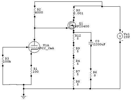

If you replace the source resistor with a 100mH DC choke you will increase the maximum efficiency from 25% to 50% and also be able to swing the load below ground. I have a 40+40W Class A amp that uses a single 27.7 volt rail with 3.5 amps current per channel and it goes very well. Many of the old timers here have seen it a million times by now, but I hope you can find something useful in it. Here is the development story --> Click
Simpleton said:Hello everyone.
I don't know if this is the correct forum or not to post this, but here goes.
I'm more at ease with tubes, having built a few. So, this is my first excursion at SS amps, though includinga a tube.
I had this circuit in mind, using a battery tube that happily "sings" at 12V. Unfortunately, using it in a single-ended configuration, the estimated power output is a mere 3mW.
As such, i remembered using the tube as a voltage amplifier and a mosfet or similar as the current source. Of course, less than a watt is fine by me, it's more an exercise to learn.
Please, check if thie schematic is ok.
Thank you very much

I mean
There are MOSFET Power transistors
and NON-mos
and it is almost impossible to build 1 T power amp
without using MOSFET
At least input impedance will not be as low
(same as saying: it takes more current to drive the input of a BJT Bipolar,
than it takes to drive a MOSFET with same power output)
this is maybe one reason Nelson Pass
later went for MOSFETs in almost all his amplifiers
Tubes like to drive a bit higher impedances.
There is a limit to how much output current
valves would like to handle.

Ah yes, you are right. That's what happens when i'm not into SS stuff
But, say if you were running a ECC88 at higher voltages the idle current would be larger (10mA or so) and then you could use a bipolar. But then again, all the fun of low voltage would be spoiled
