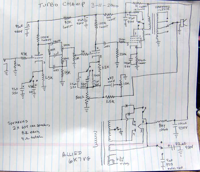

I started making Turbo Champs using an Allied 6K7VG power transformer that resulted in 430 volts of B+. The output tubes were EL34, 6L6GC or KT88. I made several of these about 15 years ago. Most used the 125CSE OPT. Each one was different, and each sounded different. I made one with a KT88 and a pair of 6X9 inch car speakers. I thought it sounded terrible, but one of my daughters friends that played rythym guitar with an ES335 just loved it, so I gave it to him.

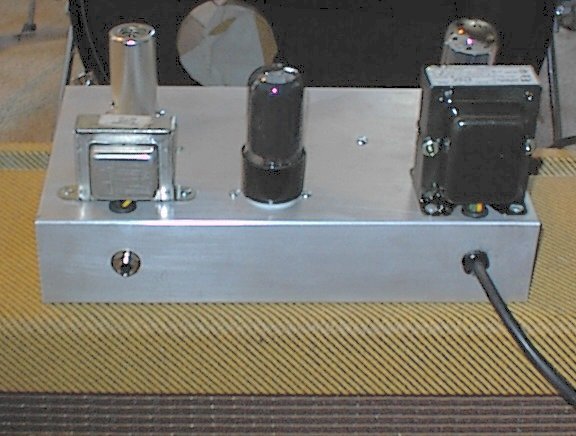

I got started in the whole tube amp business when I was about 12 years old by making Champ clones from discarded TV's and radios. I had discovered a formula for an amp that cranked using a 6SJ7 driving a 6BQ6 with a vertical output transformer from a TV for an OPT. That was nearly 50 years ago. Much later in life my daughter started playing guitar, and was in the high school band. I made her an amp, then her friends wanted one, that led to........
Old turbo champ schematic. I drew this from memory about a year after I built them all. It may not be totally accurate, and each amp I made was different. The schematic is most like the last one I made.
I had acquired about 25 old HP tube type audio oscillators that were scrapped for the metal value. I got an idea to use the parts for small guitar amps. Most did use the 125CSE OPT, but a few were P-P and more powerful. Many of the Turbo Champs were made using parts from disassembled HP audio oscillators. The power transformers, power supply choke, and many of the resistors and caps were sourced from the HP's. In fact I started by making a guitar amp "head" out of the HP oscillator itself. The oscillator circuit already had a P-P amp using a pair of 6K6's. The OPT had a 600 ohm secondary, so it was replaced with a P-P OPT stolen from a console stereo.
