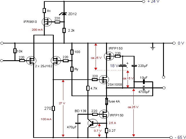

Hi there,
I intend to build a single ended power amplifier, capable to deliver 10 watts into 4 Ohm and 8 Ohm speakers. The schematic below illustrates the circuitry planned: :D
The two input transistors are 2SJ162 p-channel mosfets, developed especially for audio purpose. At 100mA quiescent current their transconductance is around 0.35 S, hence with a 270 Ohm drain resistor the gain is around 90. The total gain of the input stage should be around 45 due to the identical source impedances of the two input transistors.
Core of the output stage is the 2SK1058, which is complementary to the 2SJ162. It is flanked by two powerful IRFP150 n-channel mosfets. The lower one is simply a current sink, the upper IRF150 cascodes the 2SK1058, keeping a constant voltage of 15V across the 2SK1058.
I am planning to inject about 10db feedback into the input stage via Ry which leaves a total gain of 14 of the amp.
The heat dissipation is enormous :hot: and the amp heavily violates the Kyoto protocol, but it should sound good. The most crucial component will be the output capacitor IMHO. Which brand can be recommended ?
Unfortunaty I do not have the means to do any computer simulation and so far my experience with power mosfets is very limited. :bawling: Thus I would appreciate any comment or suggestion.

I hope the MOSFET experts will bite to give professional insight, in the meantime, I'll give some random remarks:
It seems you have access to a computer - why don't you have access to circuit simulation? You can use free LTSpice from http://www.linear.com/software/
Regarding Kyoto protocol: Didn't you recently had a major flooding in Dresden? And contrary to claims of the tinfoil head faction, class A amplifiers doesn't necessarily sound better the lower the efficency is. 10W out for burning 200W - can't get much lower.
But what's really strange here: why trying to make the output MOSFET more linear by cascoding and then nevertheless applying NFB. IMHO (and it's really humble) you can either go with cascoding and without NFB into the strange critters camp or without cascoding (and with much less dissipation) and with NFB into the fairly normal camp.

Also as another note, the two input transistors (2sj162) in the differential pair are overkill (and a bit on the expensive side). These are output transistors for audio and would be put to better use as such. Smaller mosfets could be used for the input stage. You might have a look over at pass labs and check out the inputs on the Alephs as they use mosfets for the differential stage.

Are the 2 SJ162 an expensive overkill ? May be yes. But I want the circuit to be as linear as possible even without any feedback and according to the datasheets the 2Sj162 are more linear than the IRFP 9610. The question whether this is of sonic relevance will be subject to future experiments. I will start with the cheaper IRFs.

As I've already stated, accepting 5% efficency AND having non-local feedback is expensive overkill. Especially, if you consider to which issues the mony and effort could be diverted.
Don't kill the messenger, but I cannot resist claiming that a BJT used as follower (and cascaded by an IRF to eliminate Early effect) will be the most linear solution. Of course you should stay well below the so called rated ICmax but look for the fT maximum to find a suitable device.

Hi KlausB,
As you intend to have a design which is linear before non-local feedback, the two parts can be designed, simulated and even tested seperately.
The output stage is often referred as "Power Follower" and googling for this term (plus "MOSFET", maybe) will give you a fine selection of designs.

As far as the simulation can tell you, this power follower is fine in all respects but efficeny. It's consuming about 200W (15W per Darlington and 85W per IRF), and delivers 33W into 6Ohm.
At 15V peak (18W), simulated THD is 0.06% (K3 is 0.016%).
To a varying degree the active devices' models look suspicious to me, but maybe the magic of cascoding will make the measured behaviour more like the simulated one.

thanks for your fruitful posts. From the data sheets, the 2SD2561 monster seems to be an ideal component for power followers. ;) ;) Unfortunately its hard to get. I found a distributor in Thailand who offers them for little more than 3US$. Got to see if he sells small quantities. It is http://www.westech.co.th
The schematic of your simulated power follower looks neat. So you go one step further than me with cascoding not only the emitter follower but also the CS and holding both BJTs @ 4.5 volts.
I follow your argument of BJTs being much more linear compared to MosFets. Its also in Douglas Selfs book about power amplifiers.
But why do you prefer a BJT also for current sinking and does the simulation tell you anything about the bandwidth of your power follower ? :scratch: Bandwidth should be at least 200kHz IMHO. This used to be a limitation for power BJTs in former days.

This combination works well, at least in sim. Power Darlingtons are cheap. If I use the same current source topology with a MOSFET, it oszillates in simulation. Perhaps someone more experienced can say something about them in real life.
KlausB said:
[...]and does the simulation tell you anything about the bandwidth of your power follower ? :scratch: Bandwidth should be at least 200kHz IMHO. This used to be a limitation for power BJTs in former days.
Joy of class A: The devices must never be turned off totally.
Joy of cascoding: As Vce remains essentially constant, there is no Miller effect and everything should work up to Ft.
Now this is often not given for Darlingtons, but the Sanken devices are specified and it's over 30MHz.
Sim with TIP142 gives f-3db as 150MHz, which should be taken as simulation artefect.
But you get the direction. Bandwidth will be enough.

P.S. In your very first post, you talked about adding "some feedback". AFAIK this is not a good idea in semiconductor amps.
A well tuned no-feedback amp will only have lower harmonics and even that not very much. A 50dB feedback amp will show very low THD in sim and measurements. But 10dB feedback will transfer some lower order harmonics into higher order harmonics and would most likely be the worst option ("In Zeiten großer Not, bringt Mittelmaß den Tod").
