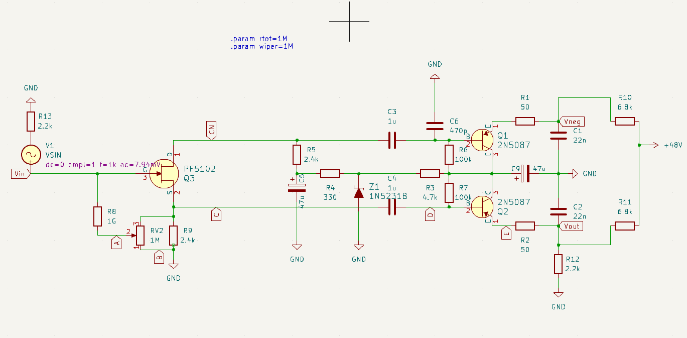

I wanted to learn more about Microphones and I tried to recreate Pimped Alice: https://www.instructables.com/Modify-a-cheap-LDC-Condenser-microphone/

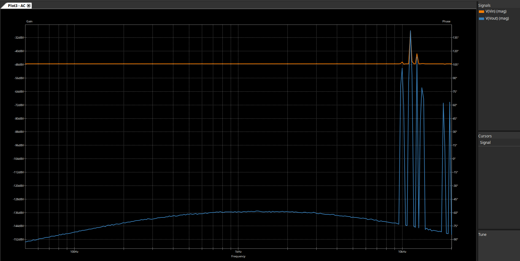

So I created it in Kicad and tried to simulate, but the output seems weird.
I currently have this.
I use sin input with 2.2k resistor to emulate the mic and +48V with 5.8k resistor to emulate phantom power.
What am I doing wrong?
