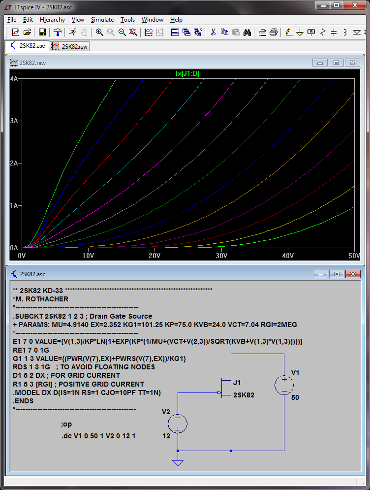

happened to get two pair of NEC made SIT, 2SK70 and 2SJ20.
Hi Folks.
I happened to get two pair of NEC made SIT, 2SK70 and 2SJ20.
They have bigger Gm and high temp max, 150 deg. C. than the popular Sony 2SK82 and 2SJ28.
Now,I am wanting to build a stereo PP amp using them.
I tried to generate the spice models and completed as a practical model which may fit on 4-8 ohm load-line by the way M. Rothacher presented on UTUBE video and also Audiohobby.com.
As I do not have complete information, I tried to fit it manually.
2SJ20 model has same parameter but opposite polarity.
Capacitances are my best guess.
Attached images;
1. 2SK70 Id-Vds data.
2. 2SK20 2SJ20 Spice model for LTSPICE.
3. generated curve by the model.
