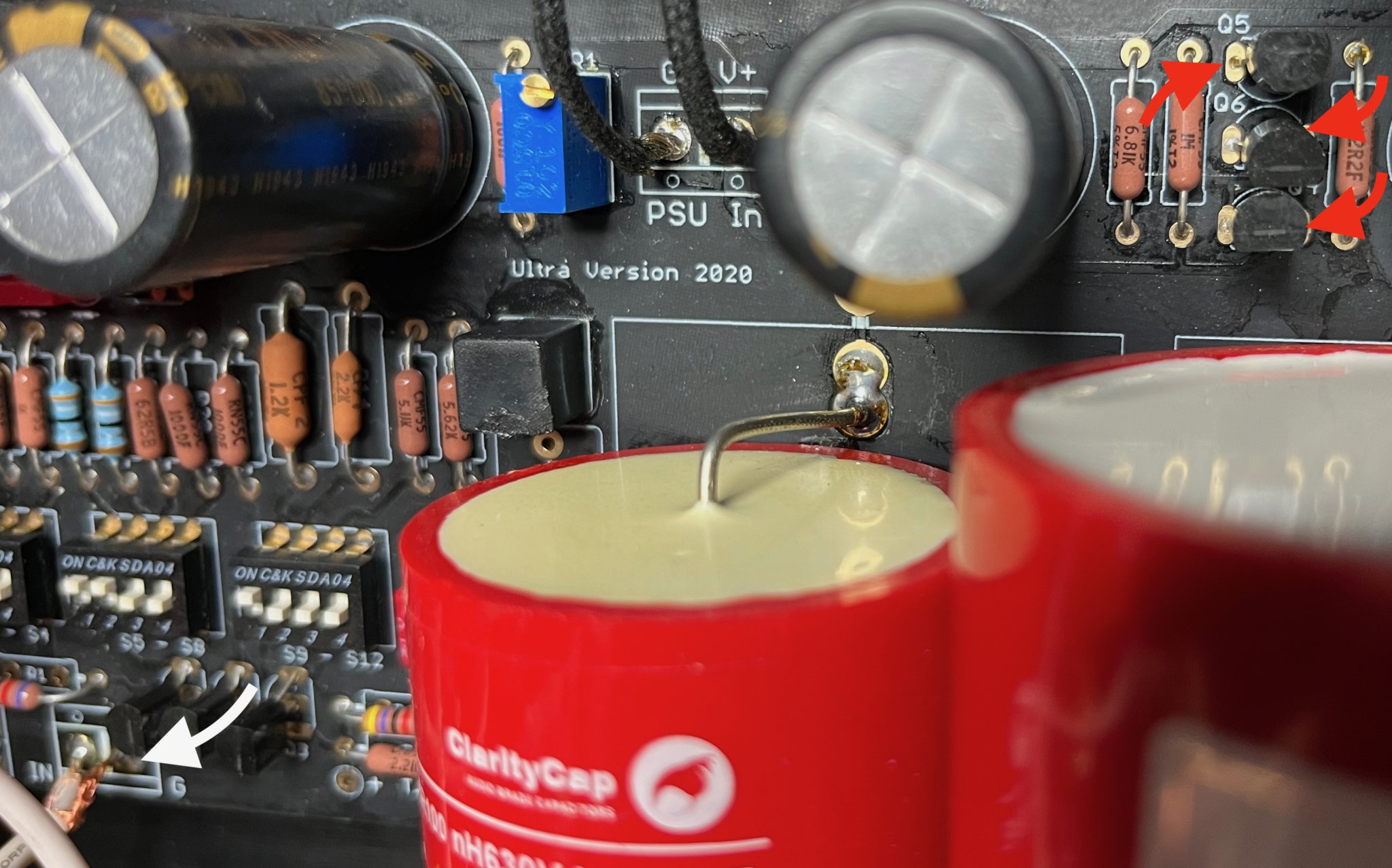

Your measurements are weird. Drain to ground (PSU 0/chassis) for Q4 should be 7-10V and about the same as Q5's drain to ground. Q6's in the vicinity of 20V. I suspect dead Q5. With power off measure RDS Ohm across Q5's drain to source pins (1 to 3). If a short or OL its bad news. Normal is 30-40 Ohm RDS for a K170 BL.

Salas,
Thank you very much! The coax looks fine (at the input), it’s view-angle and focus.
BUT on this side, I have contiinuity between hot and shield/gnd on both in + out… I suspect (hope!) this is the glitch.
This time the measurement seem to fit:
Pos | bad | good
Q4. | 7.76 | 7.87
Q5. | 7.82 | 7.89
Q6. | 19.08 | 19.98
Another thing I observed: the bias. I readjusted it to 4V the day before, after ufsp was on for around 20 min, I constantly and slowly went down and I upped it to 4V seceral times.
When I measured again, after ~15 min, it was at 5.6 slowly going down. Is this normal behaviour?
Have a good day!
