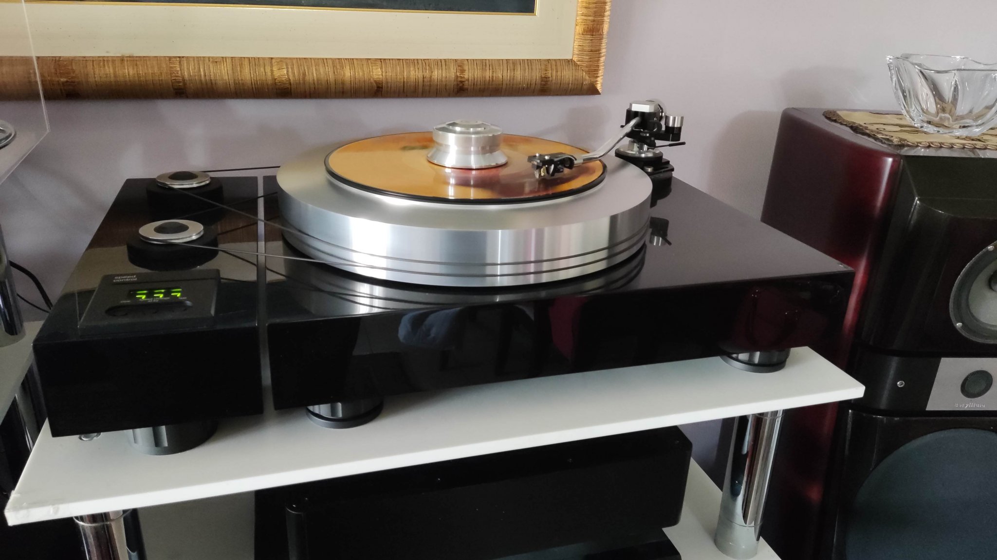

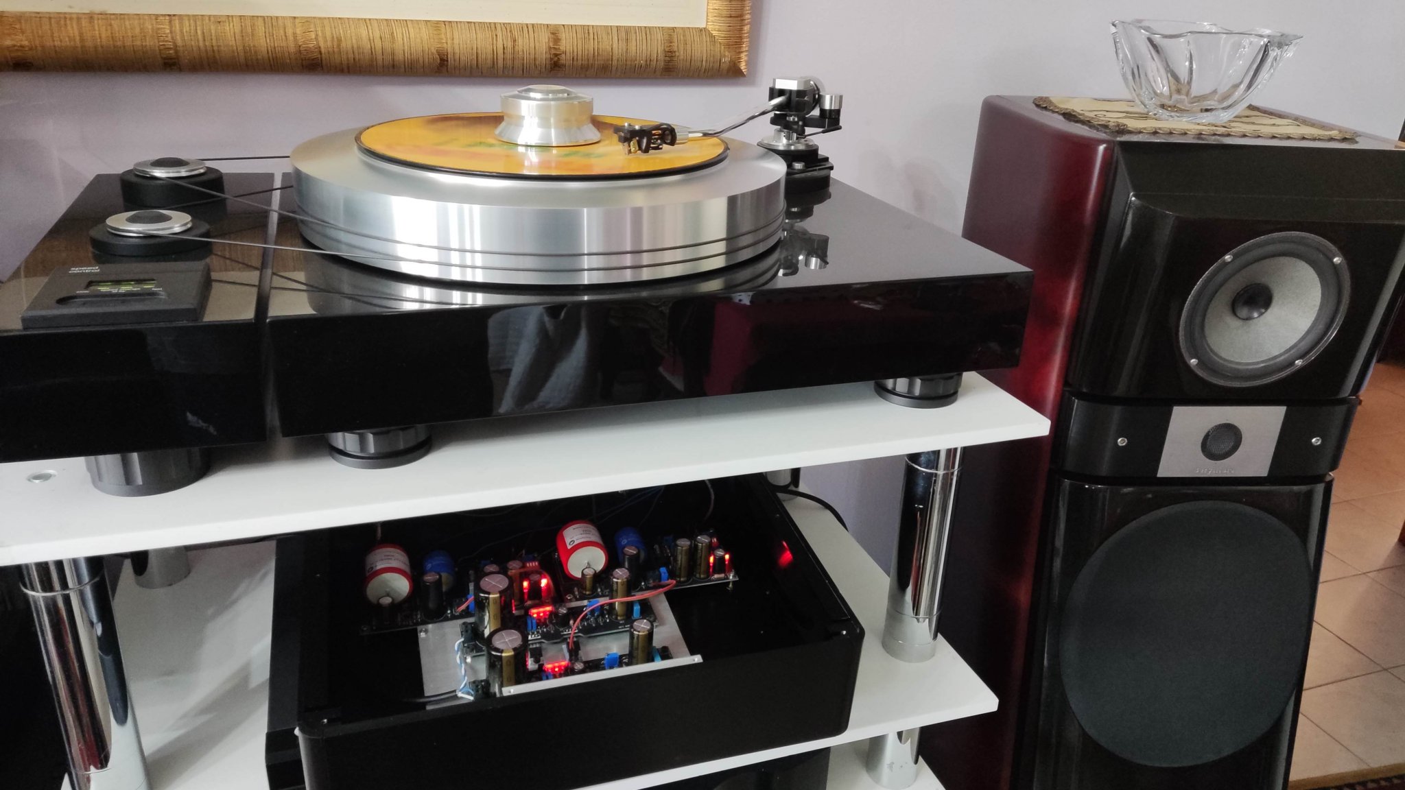

Simplistic NJFET RIAA
ETTA JAMES - AT LAST!
(I have sound.... a premium one)

I am not a electrician, i am mining engineer, but with the years i ve learnt that the most important is the power supply! (Imho)
It is important especially in UFSP which is single ended without significant power supply rejection ratio or NFB like op-amps have. Its more like a classic single ended tube circuit architecture. Except we can't have a P tube like we have a PNP transistor to make a folded cascode out of tubes like our input stage in UFSP.
