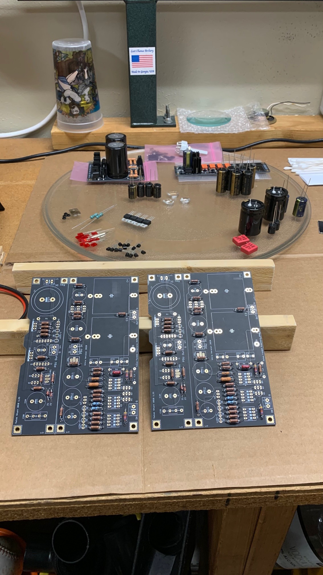

Hey Folks Starting to Stuff my Boards Raw power done. Works great. Started testing resistors for the UBiB 1.3. The schematic shows
5.6R at the R1 position. The resistors I have test at 6.1R is this an acceptable range?

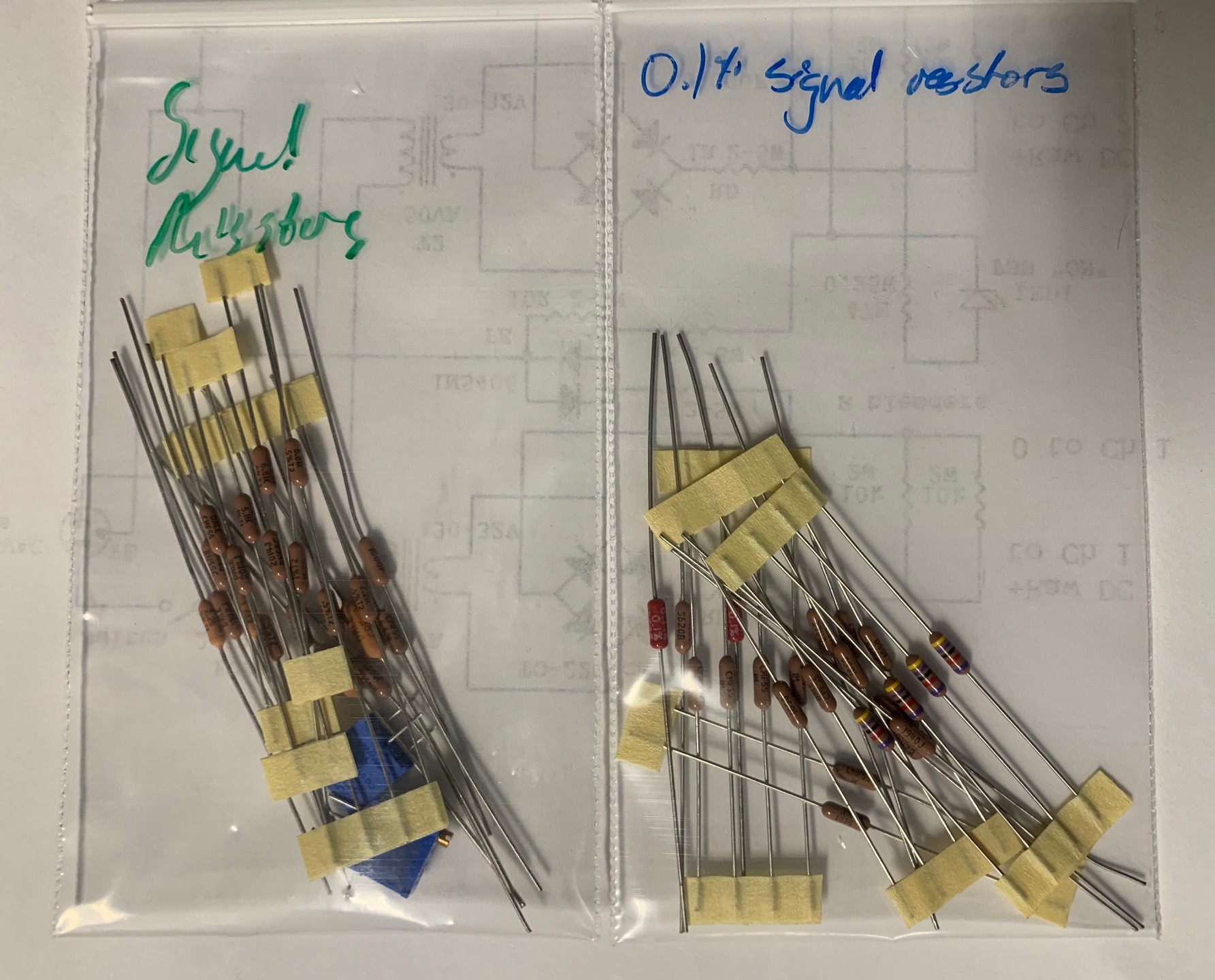

Tea-Bag a little help on the writing please... and a little help on the general vicinity of their placement.

Hi A321Drvr - The BOM is color coded. Look at the blue section on the BOM. Measure each resistor, lookup that value in the blue section and label the resistor with the location. Rinse and repeat until you have gone through them all.Anyone? I can make out the word resistors on both bags and the word signal on the right bag.

Makes very little diffidence to the programmed CCS current result even if that 0.4R deviation is realAny thoughts? Should I get a 5.6R or is 6.0R going to work?

Making progress, trying to read all of the decimal points is tough on an old man.
@RickRay I took your suggestion and measured some 0.1% resistors, right after I changed all three batteries in my DVM's. All of them measured spot on or maybe a ".1 or .2" out. I guess these "Southwire" DVM's just don't like very low ohm resistors.
Funny thing is my $20 meter which is not an auto ranging meter measured "5.8ohms" . Go figure
