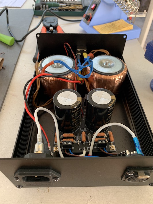

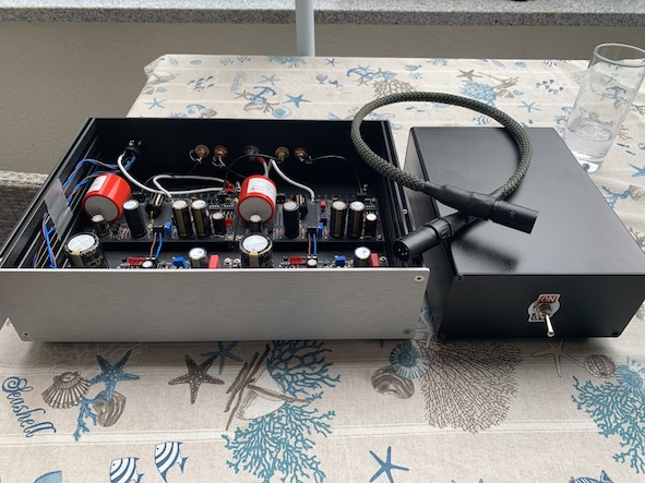

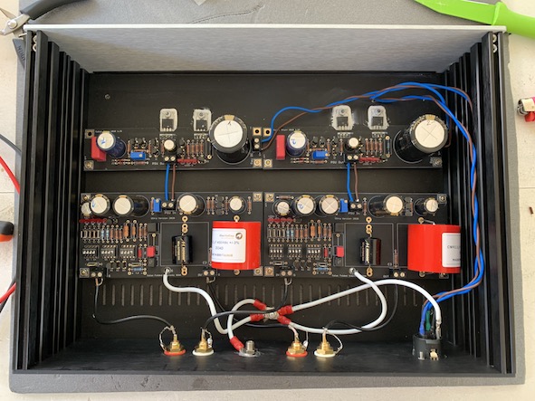

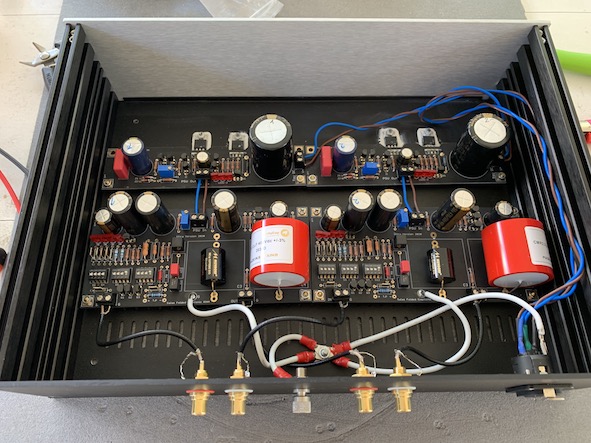

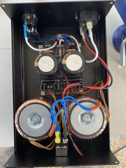

I finally completed preamp and power supply. Box it up and adjusted to drive Nagaoka MP200.
Tomorrow will hook it up to TT and preamp.
In mean time wanted to share some photos...
It run from the first with no issues. Dead quiet. Sound was very nice, considering it has only few hours of running in, i was very happy with what i hear.
I had high expectations and it did not let me down. Excellent work Salas. Thank you for sharing this brilliant project and Tea-Bag for his support.

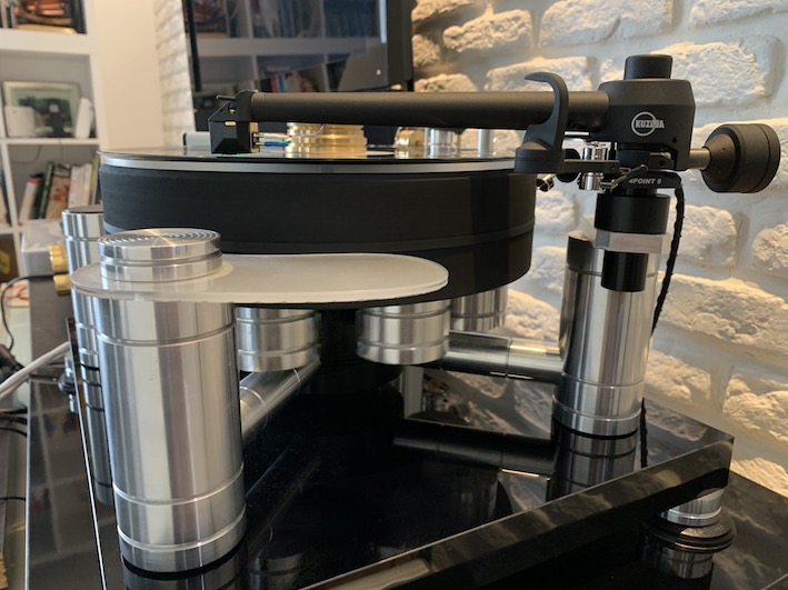

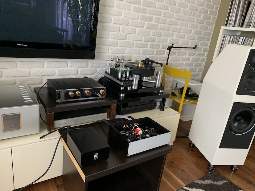

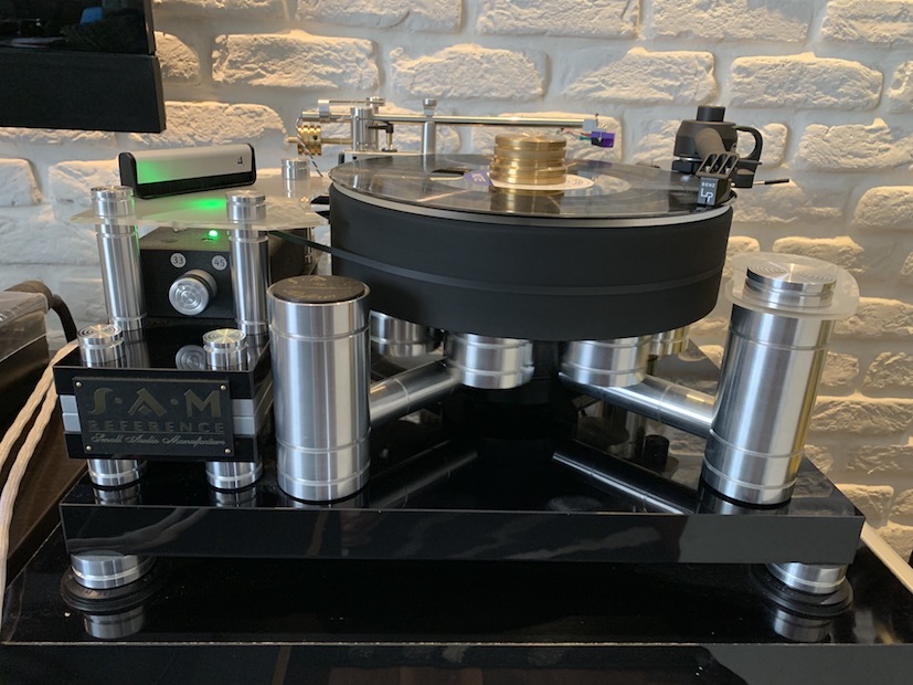

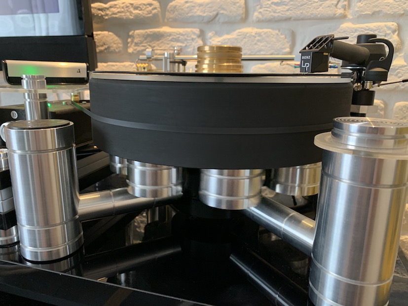

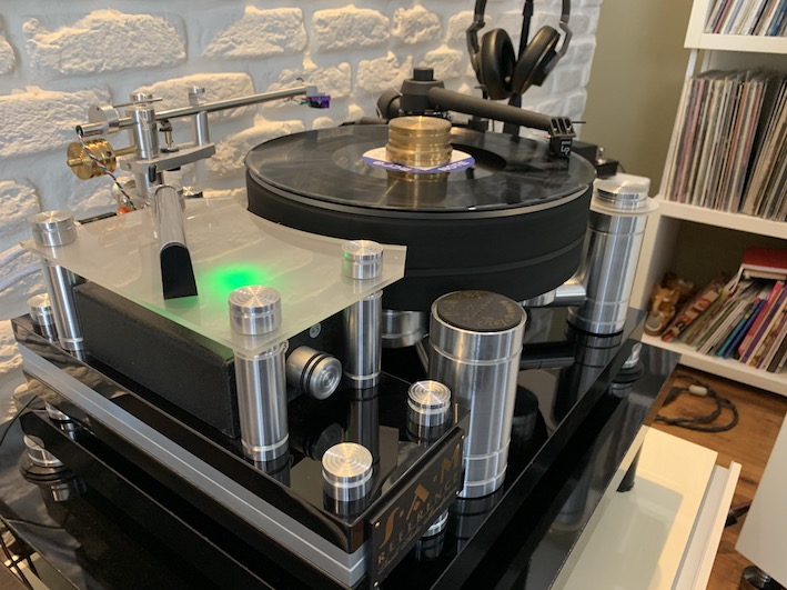

After a years of searching for holly grail and synergy between all components i finally settled with the following system. It is built around analogue front end. Turntable was made by one of excellent Croatian TT constructors and enthusiast mr. Lovrincevic. Model is Reference. I have installed two Tonearms, Calista 2 with Nagaoka MP-200 and Kuzma 4point9 Tonearm with Benz Micro LPS cartridge.
Preamp EAR 868 has integrated MM/MC phono section.
Power amp, Luxman M800A is connected to speakers Wilson Audio Sophia 2.
On the other hand, there is Computer audio, as second source, based around modified Mac Mini with changed switching power supply to LPS. Signal goes to Berkeley Alpha USB/SPDIF and then to DAC Bryston BDA-1.
Room is acoustically treated with diffusors/absorbers. Low frequency room modes up to 150hz were controlled by 2 x PSI AVAA C20 active bass traps.

TT is fairly massive, approximetly 40kg including tonearms. Such a weight helped eliminating unwanted vibrations. Motor is sitting on heavy support and placed inside steel housing.

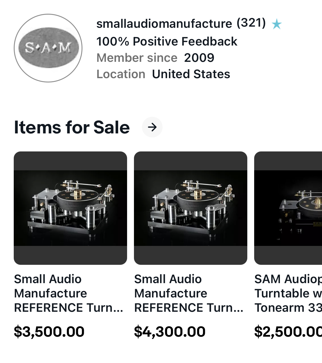

I’m watching these guys on eBay for quite time and they do manufacture several turntables types with flexibility of some parts choices. In did it is nice (at lease visually) units. It is SAM eBay store attached as image.
