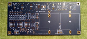

To give you an idea, here is a preliminary channel PCB of the core design I hope to expand into a dual breakable whole including its dual specialized 1.3 PSU sections. In case of difficulties or delays to conclude it as projected due to the weird times we are living through, at least this essential section I have already secured its done and tests well.

As a matter of fact I had designed the special Ubib version for the phono months earlier. But I kept it in the drawer not to enlarge the project if not practically proven to be called for. If regular Ubib had best suited it the whole thing would be ready to go now. But no such luck.
I agree, on of the shortcomings of FSP was the difficulty to change gain setting. Not difficult to implement (very few components to change) but not for on-the-fly change (I think quite a few people have more than one cartridge)
Also, what I concluded is that UBIB has more energy than BIB (which has more weight and is more relaxed). Because dynamics is one of the very few elements of FSP thah I wish it could be improved, I welcome this change. It's a tough game to try to please everybody and hold it's ground against much more expensive commercial phono stages.
Could I suggest that the space of the output cap could be little bit bigger.

Another suggestion is to have little space around 2sk369s (1-2mm would do) and two tiny holes close for small cage (copper ?) for them.
I guessing that caps pitch are about 40mm, good for gain cap but not for output. Although Mundorf, Clarity and Rike have opted for bigger width caps, the majority of them are full length, especially the copper ones. For those caps 70mm pitch is preferable. Even-more, I think that most people would prefer old Supreme series than the new EVO series for signal.

EVO are not only the cheaper than Supreme versions. 2.2uF C4 EVO starts with a 4 Euro plain dry one and tops with an oiled and gilded ~100 Euro boutique type. Both price extremes and those in between fit the boards so there is expanded choice.
ClarityCap CSA & CMR fit as well. Those are cheaper class and upper middle class excellent British caps of solid engineering. Problem with longer traditional film caps is they are all over the place for dimensions. Can't predict for more than a couple of types on a well proportioned PCB layout. When the fatter/shorter types look like more compatible between makes and ranges.
By the way, Supreme 0.1u and other alike form factor types still fit for length in the new C3's space. Inter-stage is arguably the more influential coupling position in this phono.
Also when you look again there's an embedded trick. Both C3 & C4 places are non blocked at one side and secondary extra wide inlet pads are included. So very long loudspeaker crossover style film caps (even if with wire ends) can be allowed to overextend the board's edge. It will look odd with one third hanging but they can be employed if already owned or opted for.
We added some large holes here for some larger loudspeaker caps. I forget the dimensions.

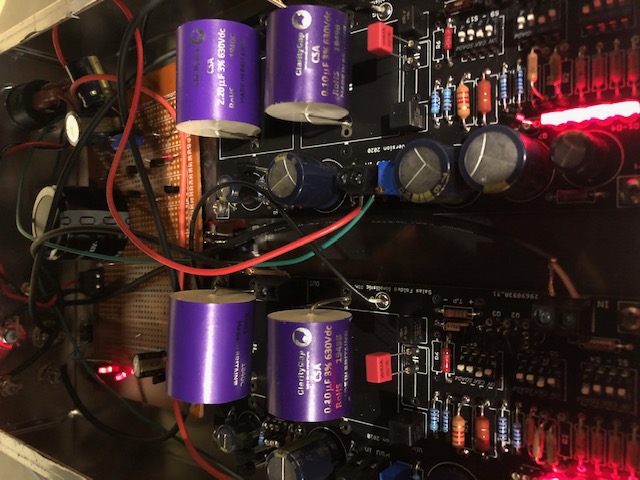

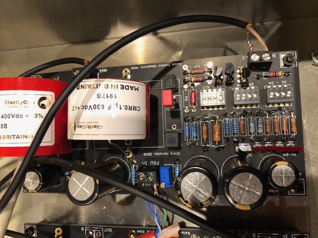

A few photos of my second build of this magic design. Had quite a time of this build and needed to look very carefully at Salas's advice to other builders to get to grips with difficulties in getting the voltages in the ballpark to set the bias to 3.60V in each channel. Couldn't have done it without you Salas. Your sage advice to elwood set me on the right path.
I think one cause for me was an external one: our notional mains supply of 230V spends most of its time very close to 250V so the raw supply was over 53V in each channel. After addressing that problem with the addition of 18R 5W in place of the links in the raw supply, I then needed to adjust R3x in each channel to bring the voltages within the range of the trimmers, ending with about 34V in each channel to give the required 3.60V between TP1 and TP2.
Had another interesting experience with C3. Initially fitted a couple of very large Russian .1uF caps but they had the unfortunate ability to act as antennas for every 50Hz signal within cooee. Fortunately I had in my collection a couple of Wima FKP1 .047uF and they solved the problem perfectly.
You will note that I have built the power supply in the same enclosure, ensuring that it is shielded from the main boards by a steel plate effectively having the PS in a Faraday cage as the enclosure is also steel. Of course the proof is always one's ears and the preamp is free from hum.
My first FSP build has gone to a good home as the phono preamp for a Rega Planar t/t, a better than average Marantz amp and some 90s vintage Mirage speakers. The owner is a the music theatre tragic so the system has a new lease of life with South Pacific, West Side Story, Cabaret etc filling the house. She is ecstatic with the sound quality.
My new build takes its signal from my Garrard 301 with AT150 cart and feeds to Linear Audio 5 Doug Self preamp and then to my Silicon Chip Class A amp and Magnepan speakers.
