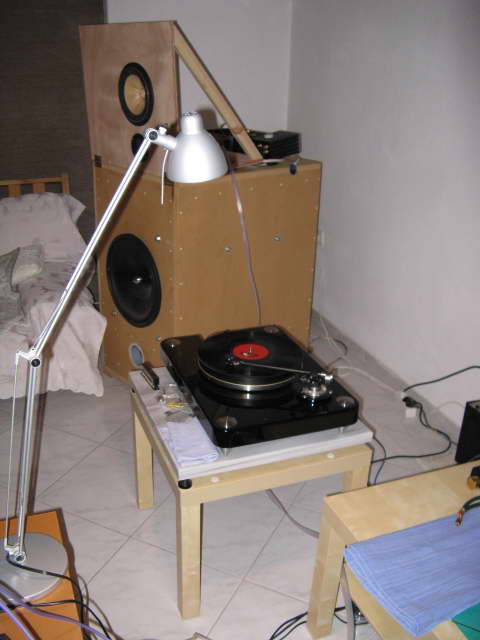

The buzz is low volume compared with the music... When I lower the pick-up, the surface noise blends with the PA sound and it is not easy to hear.... sometimes I hear it on very good and silent pressings, between musics.... or worst, during low level passages.
I noticed the riaa is very susceptible to magnetic fields... my table lamp has a transformer in the base (12v bulb) and the riaa starts to pick it up at 30 cm or more... the sound is very similar to the existing buzz... maybe I should shield the TX as it is only 25cm away from the ria circuit... or put it sideways ??
Your grounding scheme does not allow for hum, so naturally the buzz must be a field. I would see about the TX orientation first, and if it changes anything, that means measures to be taken.
P.S. That is why I use shielded cable. Kill the field (?) buzz and expect smoother highs. If you resort to shielding, make sure that you will not close the magnetic circuit from chassis to central bolt of the toroid, you can even kill it. A full peripheral copper band is OK, with connection to chassis GND. Toroids mainly offend with stronger field around the secondary cable exits.

If a toroid is closed with a metal or wire from chassis that sits on to its axial bolt, then, this is called shorted turn. It can even melt enough.
I would orient the toroid differently to hear if the buzz changes or goes away. Your experiment with the switch points firstly to the transformer field.
